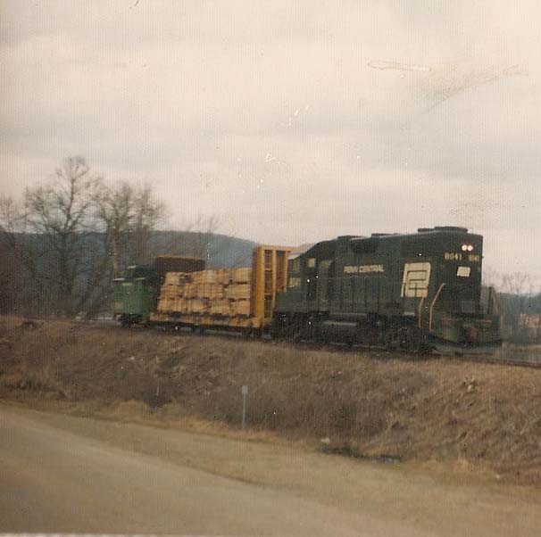

Now remember, this line was effectively shut down after the Kinzua Reservoir was built in 1965, and track came out in 1978.   I actually ran a GP38 down this line as a teenager in 1975 and would have passed this exact spot on that trip but don't remember it.   So, if I'm going to do another T-trak module of PRR in the 20's, well, this little station seals it.   The place name exists, although I'd never actually seen it - it's rather remote and inaccessible today.

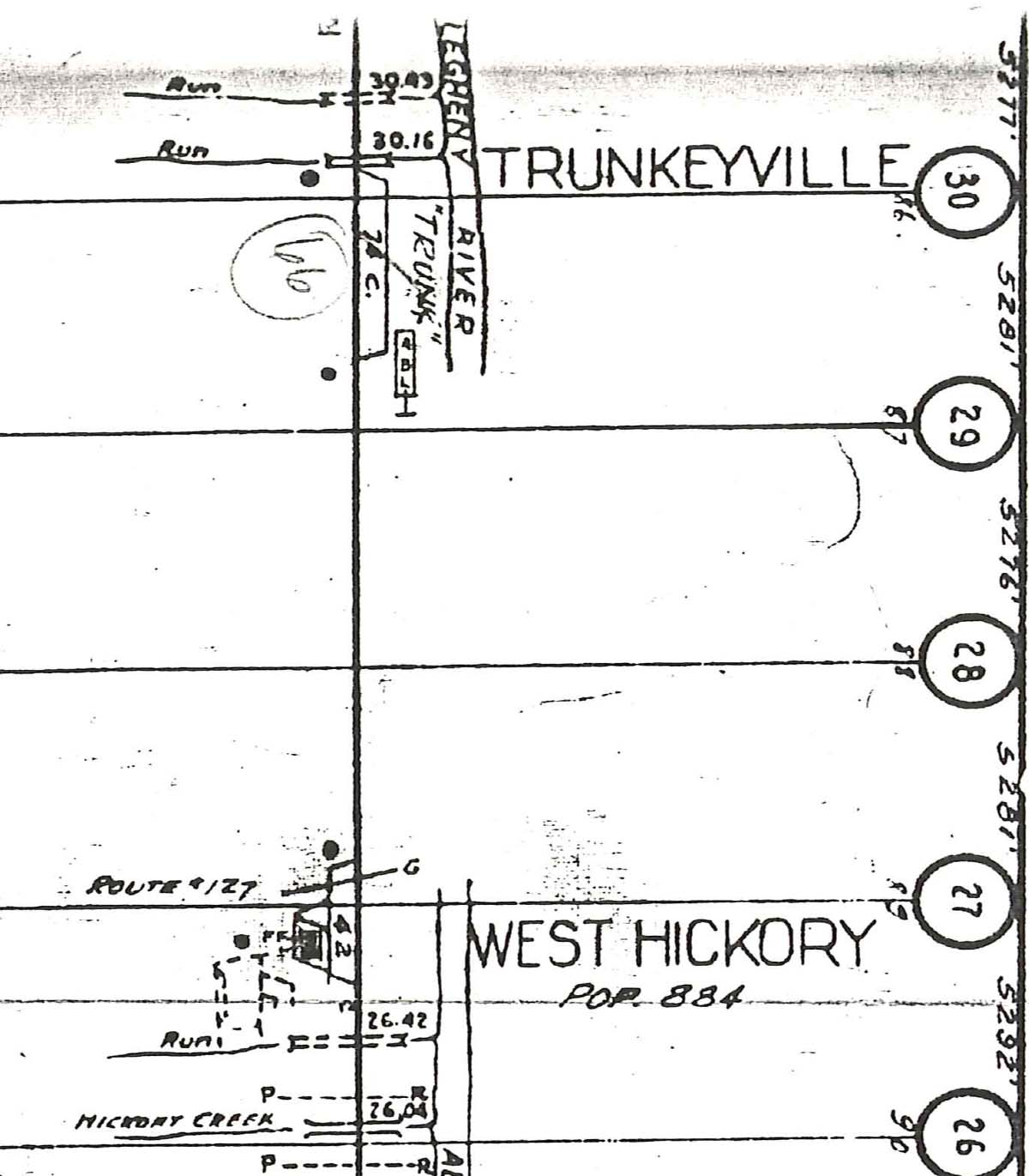

If you're doing historic modeling, a resource you don't see mentioned much is railroad track charts.   In this case, I had a set of the line - dated 1950.  I'd used them a bit on the West Hickory module (which proved that PRR kept the tannery track open long after the HV was gone) but also showed our topic here.   When the railroad is gone and you know next to nothing, what can you learn?
OK, so what does this tell us from 1950?
It was still a live passing siding (74 cars) and a block station (TRUNK) with phone booths at either end.
And at the north end of that siding... a bridge.  30.16.   So what you're seeing in the photo is that the depot was all the way to the north, right by that little bridge.  And that's what is in the lower washout, the creek blew it out from the BACK, not the front.   So, that tells me exactly, almost to the inch, where the depot was.    Huh.   That also tells me that in that depot photo, the passing siding was closer and the main was nearer the little depot, and it had to be right at the turnout.  Well, that makes sense in timetable and train order days, the operator could run the switch, too.

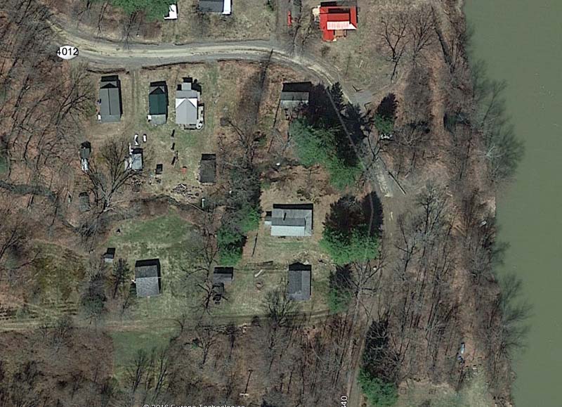

A google earth search confirmed what should be there.... "trunkeyville, PA" does actually exist.   It's now nothing more than some seasonal homes and fishing cabins, and a dead-end road down into the place.   The railroad grade north of there is now a trail, track long gone.   But, if you look close, yup, there's a stream.  And a road to what looks like a little parking lot.   Right where the depot would have been.... huh.
Huh, there is stream...and what looks like a culvert under the railroad ROW.   That lines up with the washout shot.

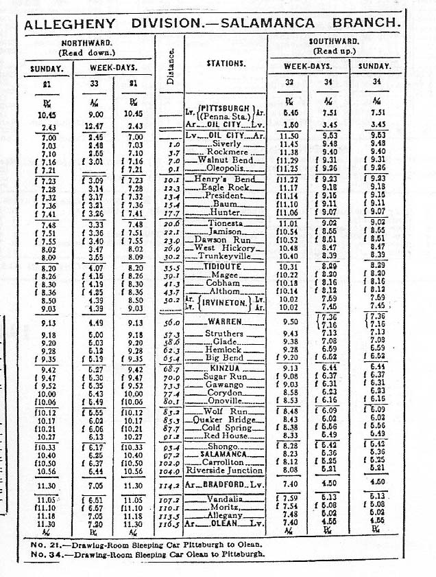

Checking my history books, wow, I'm still amazed by what was going on in the peak years - two through passenger trains a day, with Pittsburgh-Olean-Buffalo Pullman service.   Just like my Dad told me about.  And yup, there's little Trunkeyville on the schedule.   There must have been SOMETHING there, there sure isn't now!    At this point, I'm baffled why it even existed, let alone why it's virtually gone.
