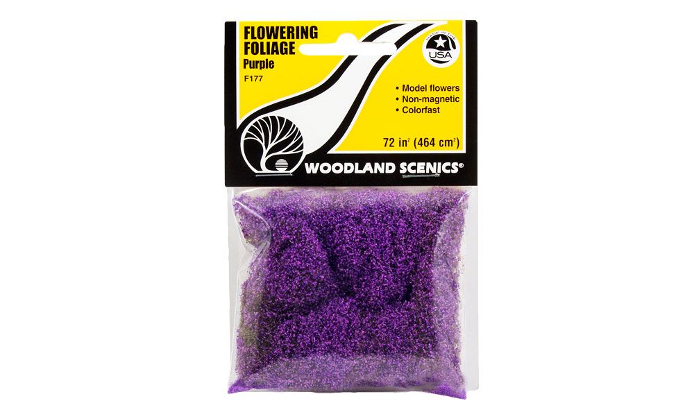

« Reply #4 on: January 21, 2018, 04:37:14 PM »
How about Woodland Scenics? More purple than blue perhaps.
I this one really Woodland Scenics? Or some kind of a copy?
