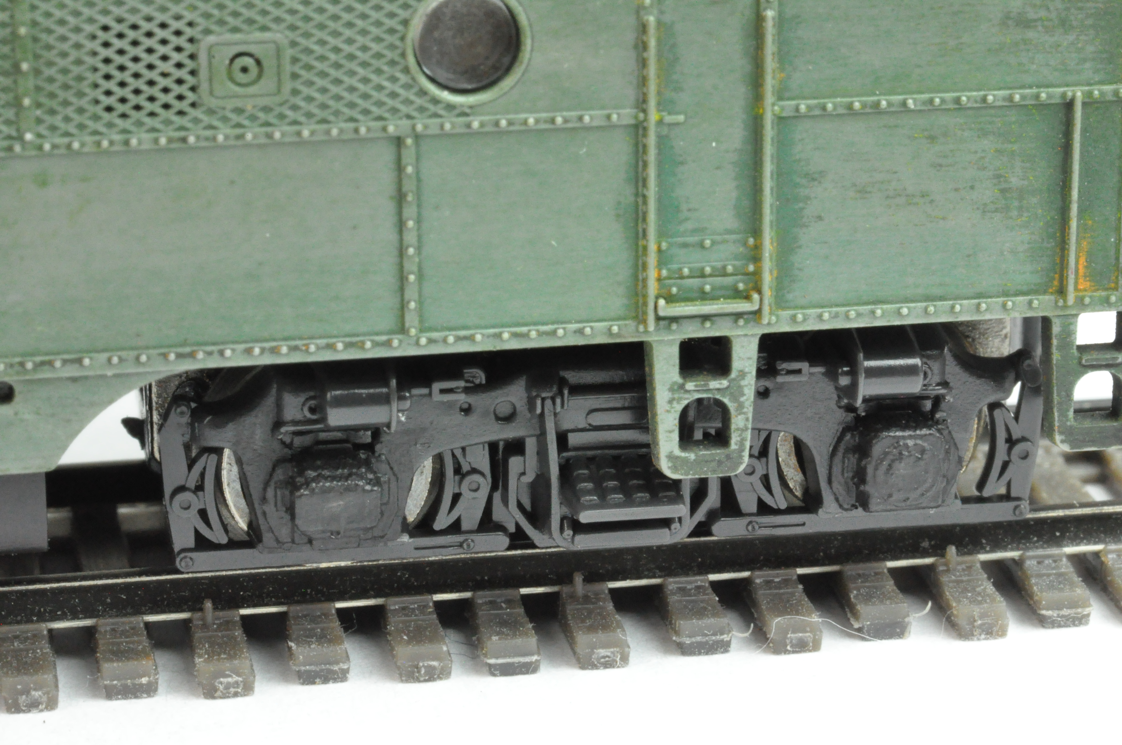

One pet peeve of mine for my early EMD units is the bearings.  Both Kato and Atlas just do the one roller bearing which is pretty much in the minority for CGW units.  I got my first parts back from SW a couple weeks ago, here's the test shots.
I think my hand painting covered up some of the detail but I've already beefed up the drawing anyway.  Also, the the solid bearing drawing I made from a NW5 unit in Florida which turns out is slightly different than the one used on any CGW units so I've redone that as well.  I'm also probably going to etch some new sill steps as the Kato ones are just too much to take.
Some really nice fall weather has postponed much of this work the last few weeks (and looks like it will continue at least though this week).
I like the new journals , these are so needed in Nscale..FYI, Gold Medal Models makes etched steps for F units, and other cab units too, all on one set...
Yeah, I have those but they are too thin at .2mm which just looks awkward with the thick plastic shell.  I tried doubling them up but it wasn't fun.  I'm looking at etching them from .4mm which is a little thick but will go good with the shell.
I hand paint my GMM E/F unit stirrups because of your described issue. I just add more paint until it looks right.
Thought about that but was concerned it would be too rounded because you'd need a fair amount of paint.  Do you have a pic?
