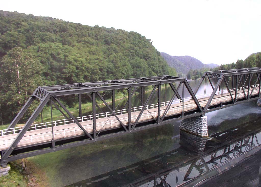

Photo (1) - this is a river I made for a customer on his Ntrak 2000 modules a decade ago or so using the above described Envirotex techniques.  Rock carvings were done by my late buddy Kelly Newton:
Cheerio!
Bob Gilmore

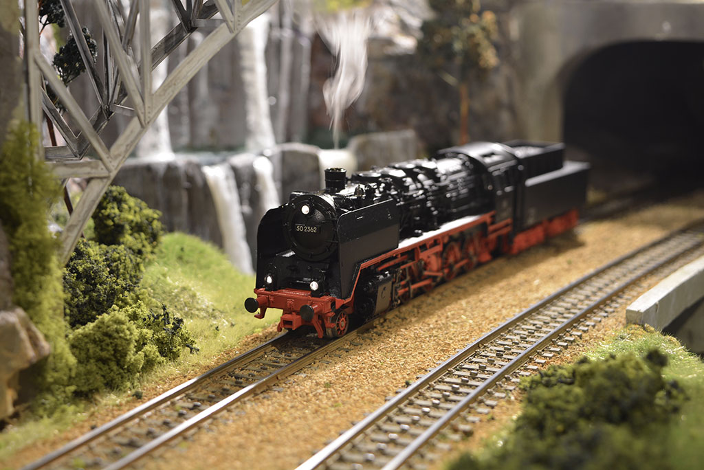

Toilet paper combined with some waterfalls:
Other veiw over the harbour:

« Reply #4 on: September 02, 2017, 10:16:05 AM »
Hi!
I use toilet paper. It´s level unsensitive, is workable during a long time before it cures, is super-cheap and the result works for me.
Try it! I bet you alreay have the required materials avaiable!  :D
Nice .. I might have added some white behind the boat .. especially along the wake .. and maybe some small white touch along the ridges of the waves . the ones near the pier especially ..
