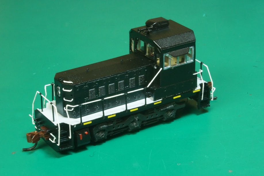

Made a lot of progress.
At a hobby shop last week in Georgia.  Went through their decals and found some that might work to make a gray walkway.
This is an O scale decal.  Unfortunately, the stripe is not wide enough to cover in one pass.  So I had to piece decal parts together like puzzle pieces.
I trimmed the weights in the cab a bit since they did not fit well after installing the windows.
Then I remembered after looking pictures that I forgot the handle for the horn.  It goes up top on the left.
Added some CN-type fire extinguisher decals.
Painted the brake handle red.
Also installed the handrails at the steps.
There's another Fire Extinguisher decal up front on the front right door.
Almost done.
Only need a couple of decals.
« Last Edit: August 29, 2017, 10:28:08 PM by u18b »

The detailing is very nice.  I really like that you have a believable detailed interior. 8)
Mark G.
  • Posts: 4056
    • My website
« Reply #485 on: August 30, 2017, 08:12:30 AM »
Thanks Narrowminded.
I covered the LED hole in the roof weight and softened the interior light.  Looks better now.
I still have to program it so that the light stays on at all times.
