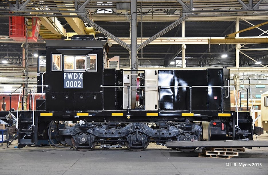

Now this photo is helpful for info.
The one in the background is black and #0002 and is nearing completion.   So that means the one in the foreground is the green one.
That means the black one was build second and the green third.   The road number 0002 is also a clue.

So let's look at the TP70.
This shot shows that the headlight on unit #2 is recessed in the nose just like on the Demo.
And it one has no ditchlights, and no drop step.
The TP70 has an external fuel tank.    And the access doors are bigger and double.
This shot clearly shows that the first and second stanchion are further apart than the demo- thus confirming the extra length.
Note the A/C is pretty close to the horn.
