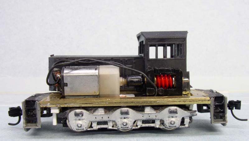

Can you take a shot of the body tipped over in orientation to the frame so it's possible to see how much space is left on either end of the motor and tower in comparison to the body shell?   I went the Roco truck route to have room for the gearhead, but after getting the shell, I'm wondering if there was enough space anyway.
Later tonight, sure.   Those screws works, but I'm going to cut them down.... and that will take some time.
Once done, assembly/disassembly will be easier.
The motor comes up to the back wall of the cab.  There is only a slight gap (which is good since I feared the motor poles might get a little warm and warp the shell).

« Reply #303 on: August 11, 2017, 07:49:07 PM »
Randy,
Does this shot give you the info you're wanting?

« Reply #305 on: August 11, 2017, 09:48:06 PM »
Wow, well....almost.   What's the length of your motor?   I want to compare it to the 11-105 plus the gearhead.
Anyway, I did my first video of it running.   I'm happy with it, I just don't think this is the optimum method to be copied.
To me, the speed control I'm getting out of the gearhead is worth the grief to get there, but I'm not sure anyone else will agree with that.  It's handling itself just fine across insulated #6 frogs, and that's no small trick for a critter.
Just weighed it, right now I'm at 31.9 grams.

« Reply #306 on: August 11, 2017, 10:37:19 PM »
It was advertised as 15mm, but it is not.
I measured case and then from the inner case to the outer bearing cover.
I assume you need the 15.8mm length.
How does that compare with the gearhead?

« Reply #308 on: August 12, 2017, 09:01:08 AM »
Over the rear bearing I've got a solid 18mm.   Huh.  But I also have about 2mm empty in the nose, about 1 mm empty behind the geartower in the cab, and the 3mm gap in the middle where I shortened up the universal.
In a perfect world you'd fit the gear head on the Kato truck.  Rats.
