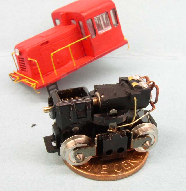

« Reply #127 on: June 26, 2017, 07:27:14 PM »
This was my experiment that failed.   Well, it worked, well enough on the workbench, to make my 25-tonner work better.  This is a Tomytec power truck, end axles, and the way I made it, equalized.   Drilled out the worm to press-fit a .7mm shaft on the Motorola 9V pager motor.
But this is also where I learned, the hard way, that tiny pager motors have no torque to speak of.  You could stall it out with 3 cars, it couldn't move.   If you gave it a nudge, it could start, and then accelerate to warp speed.   Could run on its own though, and on a test track.
Filed under 'seemed like it would work'....

Got the frame finished by doubling up the brass sheet - nice and heavy, and got the end sills/steps on by epoxying them to soldered-on brackets on the frame.  Put couplers on it and did some road testing and switching.
Observations:  It's bigger than most; I scaled the frame out to 31' using that side photo (one with the fuel tanks) based on the known wheelbase of the truck.  For a critter, it's actually a pretty big one.   It runs over an Atlas C80 #6 crossover with long insulated frogs flawlessly.   With the cab weight on, the tractive effort is really good, pulled around a respectable train.   Slow speed is excellent, pickup good - only gets a little odd at extreme slow speed where it will unexpectedly stall.  I suspect there's more room in this thing than I thought for weight.  Definitely sold on the 5.14:1 gearhead, it lugs nice at slow speed and the motor RPM's done don't change even at full slip.
I wish this thing was more repeatable.  Given what I'm seeing about the actual hood length, with a little luck you can still get room in there with the Kato truck for a motor, trick will be for a gearhead.   I'll openly wonder if one of the smaller, yet powerful, Gizmoszone gearheads with the smaller pager motor is the way to go with DCC limiting the motor voltage.   My experience with the tiny planetary gearheads is very good, but they do sound like there is a bee trapped in the shell when they are really cranked up.  You'd still have to splice the worm shaft for most of them that I've used, but they have alternatives.    I've used the tiniest motors/gearheads in the Climax and they have plenty of torque, just really slow.
Gizmoszone does have 'long shaft' 1.5mm drives, but the gear reductions are pretty darn high.   I'll guess, but don't know, that the 8x10mm 3v motors are swappable with the Kato 12V motor like the other one I use.
http://www.gizmoszone.com/shopping/agora.cgi?product=Gearmotor&user6=longshaft;ppinc=1g
My approach to most of these critter mechanisms has been pretty much like watching the coyote design roadrunner traps.
« Last Edit: June 27, 2017, 10:03:33 AM by randgust »

... Slow speed is excellent, pickup good - only gets a little odd at extreme slow speed where it will unexpectedly stall.  I suspect there's more room in this thing than I thought for weight.  Definitely sold on the 5.14:1 gearhead, it lugs nice at slow speed and the motor RPM's done don't change even at full slip.
And there are those basics, covered.  5.14:1 then 20:1 or if a compound reduction truck, maybe 30 something :1, and there you have the 100 to 150 or so :1 ratio.  And it works.  Randy, it's that ratio that was missing in your 25 tonner and explains all of its faults including the stall then runaway speed problem.  Even if you got there by guess, you still got there.  In the future there will be no need to guess.  You've got the proven data.
