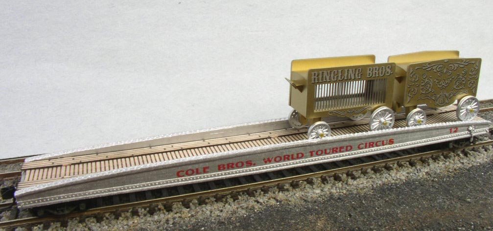

One thing I've done on a lot of ACC assembly jobs in general has been to basically 'bolt' pieces together by drilling .020 and putting pieces of brass wire in there at structural locations.   While ACC might have poor shear properties, it's darn near impossible to pull the stuff apart of a pin joint as the capillary action pulls it solid.   I've used that approach on Delrin with great success, and in major heavy assemblies like pewter cars I've done the same thing.    Last major N Scale Kits build I did was a Warren circus flat, and also the NYC Flexivan spine flat as modified - both got brass wire/pin reinforcements in hidden spots.   The 'deck' for the ATSF-converted Flexivan car was mostly metal shapes, soldered, but drilled and pinned into the pewter.
