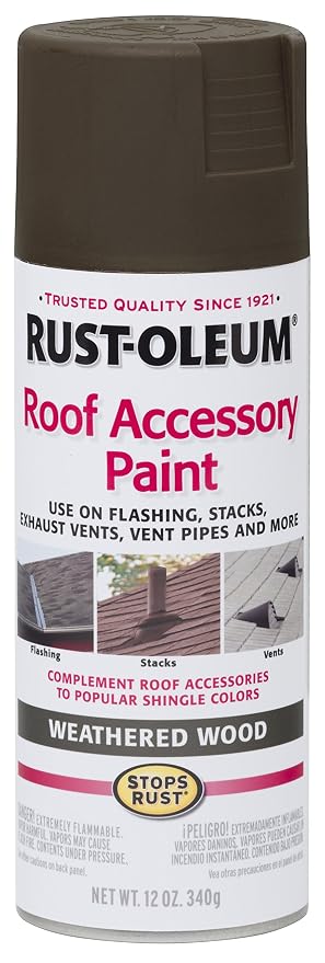

For my RGS trestles I stained the wood before assembly with Hunterline stains (Russet and Driftwood).  I'd be concerned with glue spots not absorbing stain.
You could try--rather than gray primer--my go-to wweathered wood primer.  I use this stuff on everything, including real wood and plastic:
The finished spray is grayer than what the cap indicates.  It's a perfect gray/brown.  And it's dead-flat.  It's the base color for the big plastic trestle on the Midland (with Testor's tan highlights):
« Last Edit: September 15, 2019, 12:29:48 PM by Dave V »
Re: HO Scale Seaboard Central 3.0
« Reply #895 on: September 15, 2019, 12:35:47 PM »
You could try--rather than gray primer--my go-to wweathered wood primer.  I use this stuff on everything, including real wood and plastic...
The finished spray is grayer than what the cap indicates.  It's a perfect gray/brown.  And it's dead-flat.  It's the base color for the big plastic trestle on the Midland (with Testor's tan highlights)...
Crikey. I even have like 2-3 cans of this stuff, and never thought to use it. Genius.
That's why we call him Dr. Hotballs, PhD...
"trees are non-judgmental, and they won't abuse or betray you."- DKS
hnipper
  • Posts: 71
  • Respect: +10
« Reply #898 on: September 16, 2019, 07:49:19 PM »
The roofers just left a partial can of that same color when they finished replacing our hail-damaged weathered wood shingles!!! Great hint!
