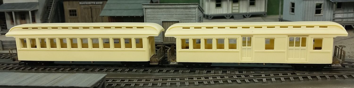

Running out of space, but I wanted a section house. While I was at it I added this tool shed/pump house.
And I made a smaller caboose
And these cars are cast in resin from Chivers Finelines of W.W.&F. passenger cars. If I can get the windows cleaned up better I think I'll build these up.

That tool shed is a D&RGW standard plan for a coal shed, modeled after the one at Rico on the RGS.
It all looks really, really good.  I especially love the passenger cars.  They will look amazing behind your 2-6-0.  Going Pullman Green or Tuscan Red?

Yeah the tool shed is from Design Tech, their speeder shed was a little too big for this area so I made my own.
Want to go green with the PAX cars, assuming I can file all those windows straight.
Chris,
I can't see anything wrong with the passenger car windows.  Sometimes I think modelers get wrapped around the axle about details that no one else will ever notice.  That's one of the nice thing about HO scale, in HO you can do a lot of detail, but in O scale you have to do a lot of detail
