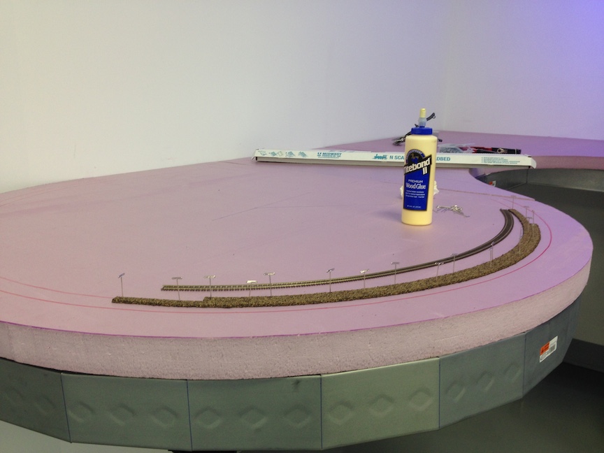

2" pink (Owens-Corning) foam, 20psi, over steel studs. No wood or fiber-based products, anywhere:
I've changed the construction method slightly in recent work, using 3/4" 20psi foam as a base and then laminating 2" semi-cookie-cutter over it for track. In a year's time it has proven bulletproof. The "20psi" is slightly important because it is less susceptible to dings and dents.
I'm definitely a non-fan of Homasote. Dusty, dirty, humidity-intolerant, plus it deteriorates. There are reasons it no longer meets building code as construction sheathing.
How did you bend the steel stud into a nice curve like that on the left????  I'm impressed!
Here's a close-up:
It's actually a many-sided polygon. I marked every 6" with a square - you can see the marker lines - then cut both flanges at the marked points, being very careful that the end of the cut landed on the mark. That way the steel didn't bend at odd angles, both top and bottom cuts were real close to parallel. I didn't "wedge" the cuts, they're just single cuts with the cut flange edges overlapped, shingled in the same direction at every cut after curving (left side under, right side over, for instance). The foam top was the alignment guide. Once I had the general shape, cross braces were inserted to hold the circle, the adhesive* was applied and the facets then fine-tuned to match the foam edge.
* - NOT the glue in the picture. The foam is fastened to the steel with Gorilla Construction Adhesive. I tested several, and it was one of only a couple of construction adhesives that didn't attack the foam and bonded well with the steel.

Thanks Mike!  From the earlier distance picture I couldn't have imagine that is was "sectional".  What a great idea!
