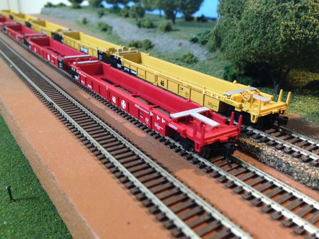

Just recieved the New Walthers Articulated Thralls and while there isnt anything new persay, the wells are the same as the previous versions and it still has the same walkways, but they did get a major upgrade imho. New trucks and couplers! Granted they are of Atlas nature but still a big step up from the ugly walthers trucks.
The paint on the SFLC and TTX cars I have recieved is smooth, and even. The lettering is small and legible under magnification as well.

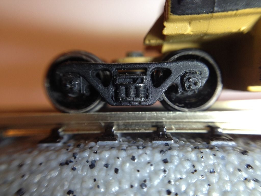

The truck pins are the same hex shaped (garbage) design as on the previous runs and other rolling stock as well.
Because the trucks are Atlas the cars roll smoothly. So far the cars will navigate a 12" curve with no problems.
I have left a string of them running around a uneven surface (carpet as I am doing this test from my girlfriends house.  :facepalm: ) for about 4 hours now and have not had any issues with the cars coming apart or the Accumate couplers failing. The wells are 48' and I have put just about every manufactures 48' Containers in the cars with no problems.
They are nice and heavy so you dont need to worry about weighting your containers for these cars as they are (still) diecast metal.
I really like these cars even if they are a tad oversize, as in the walls are too thick and possibly too long as well.
They also ride a little high, but some BLMA 100t trucks will help that out, and has on my older ones.
Anyway I took some photos....

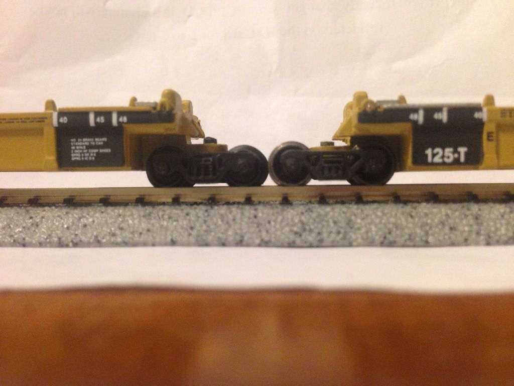

Ok so i took some more photos, this time with the old release, to my modified sets and the new release.
First the old release height. Wish i could measure it for you guys...
The new release,
The modified version with BLMA on the intermediate trucks and Atlas/ MTL on the ends (used what ever i had laying around at the time.)
Now a comparison versus the old and modified.
Also the New and Modified.
BLMA shot.
I also used a silver sharpie to bring out the walkways. Kinda hides the screw a tad...
I know there is a lot that can be done to make these look halfway decent, but the BLMA trucks sure do make it look a lot better imho. I also love that i can just run a string of these and the singles empty. Try that with Athearn/Roundhouse or even Kato, and those are metal as well.  :D
