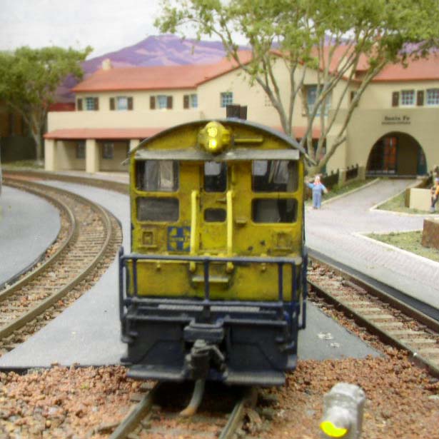

This thread did get me motivated to look at my 'SW8 on a Kato chassis' home unit again.
So Ed, before you get too much further, take a look at this idea.    You can unsolder the 'rear' LED on the circuit board, the one with the light pipe that wanders around and up the back of the cab to the rear headlight, and move that all the way up to the top of that 'light pipe post', so that the LED is actually shining out the cab headlight instead of that dim bulb of a light pipe.    I soldered it to a couple thin wire leads left over from bulbs and ACC'd it right up where the light pipe was, other than the precision soldering a darn easy fix.   That also removes the problem of the odd glow in the cab in reverse.   I also painted all the inside of the cab black and bent the light post a bit to really put that LED right behind the cab headlight.   When I was building custom SW1's on Kato chassis this was SOP, but I never did it to my own until yesterday.
That's a big difference in appearance when operating, and this will be an operating unit.   I'm not sure you'll ever get anybody to see your paint technique but that headlight smacks 'em up side the head immediately.  That's my approach anyway, distract 'em with shiny things.
And yes, she's dirty by design.
