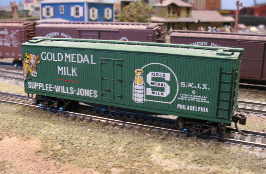

How is the quality of those Clover House decals? Anyone got a close up photo?
Clover House dry transfers were always excellent for me.  Here's a car I did with them over 20 years ago.  Be aware that they are under new ownership.  The original owners retired a few years ago and sold the business.  But they sold the artwork and machinery to the new owner, so I would hope the product is the same.  I always thought the quality was outstanding.  It is more work than decals.  For example, on a car like this, you have to carefully scribe the dry transfers in between the boards so you get the nice effect of the boards going through the artwork.  And doing multi-color artwork (where one dry transfer has to be applied over another one), can be tricky because you have to get the registration right.  But the results are fabulous.
