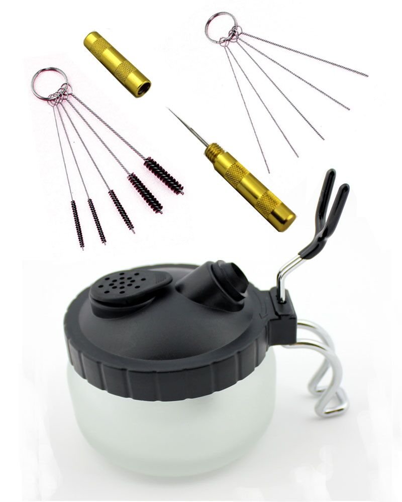

I use this to recapture the solvent and sometimes reuse it after filtering.  You put the tip of the brush and a couple cups/bottles ans spry right into the vessel.  ooh look this one comes with brushes!
https://www.amazon.com/Airbrush-Cleaning-Needle-Nozzle-Holder/dp/B0154HN2NA/ref=sr_1_3?ie=UTF8&qid=1485544439&sr=8-3&keywords=airbrush+cleaning+pot
