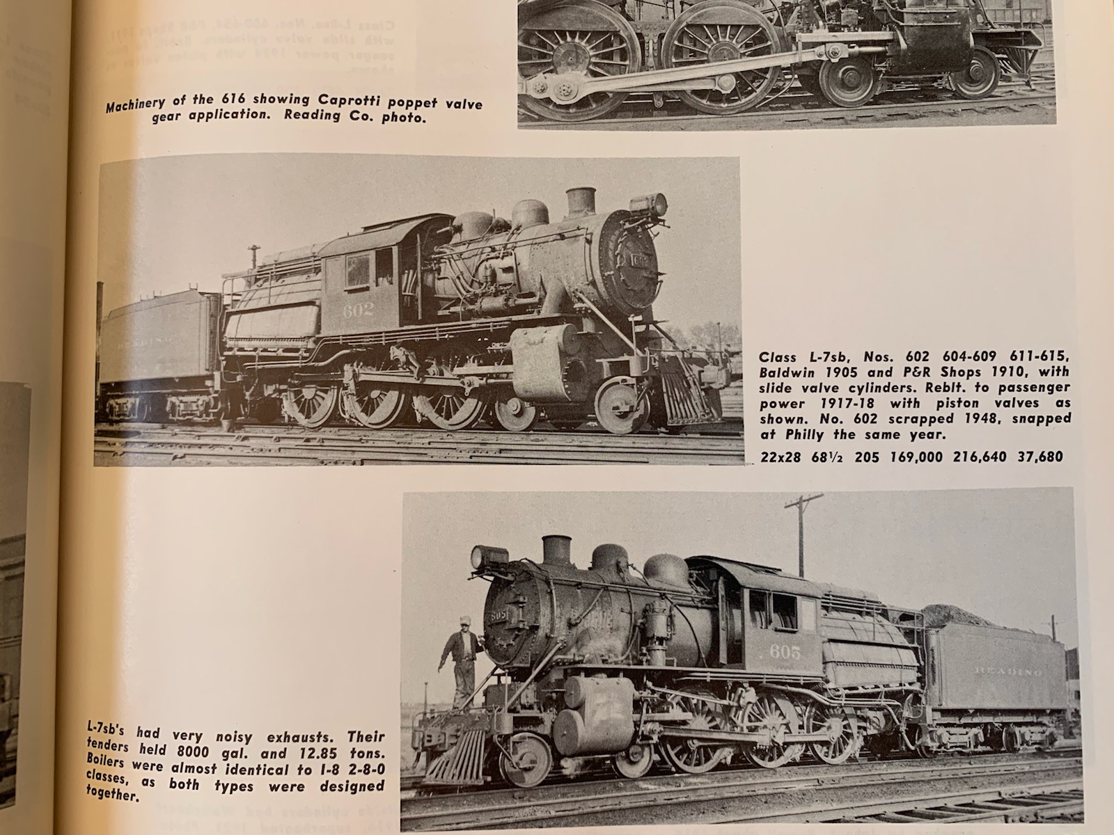

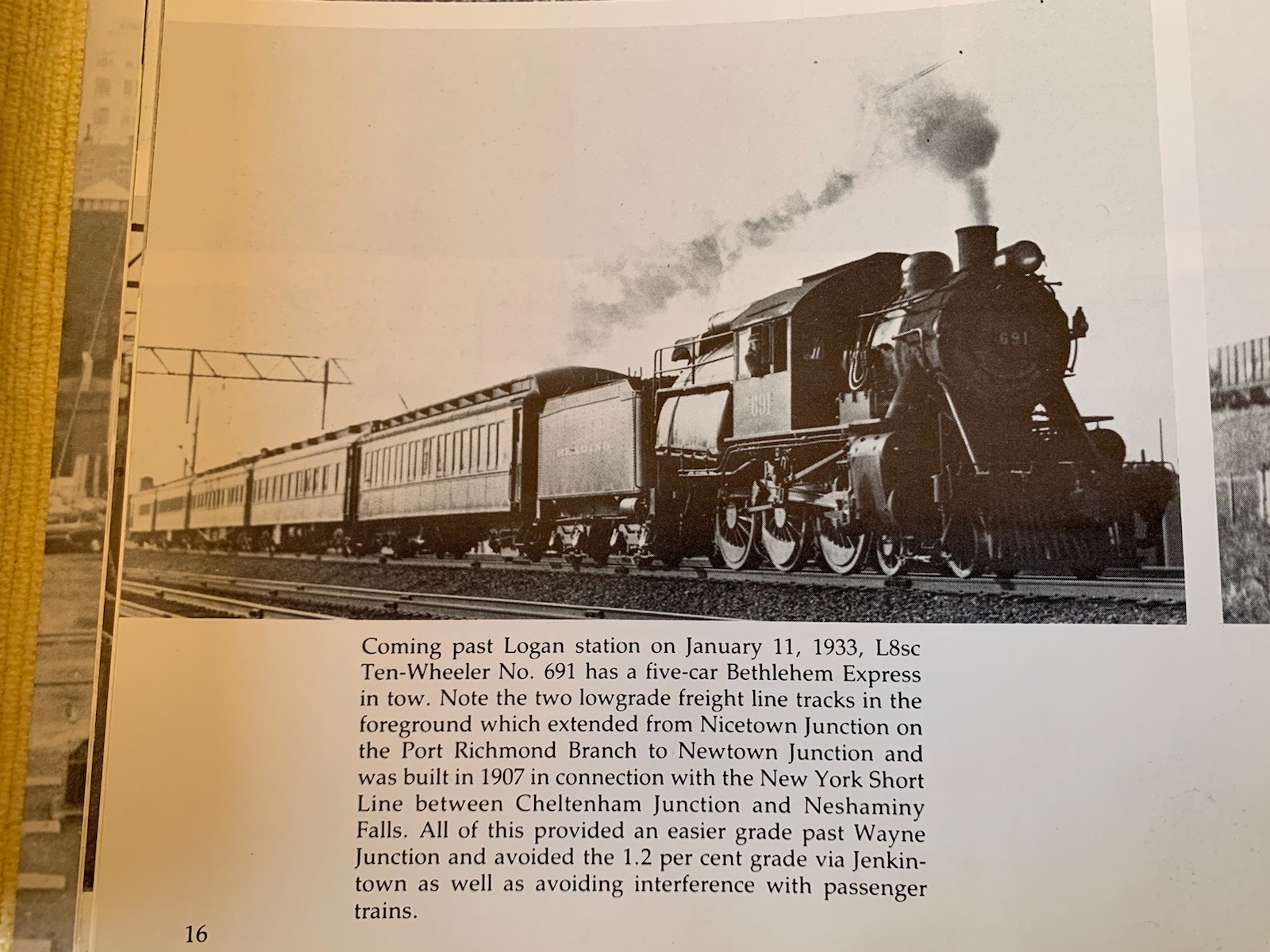

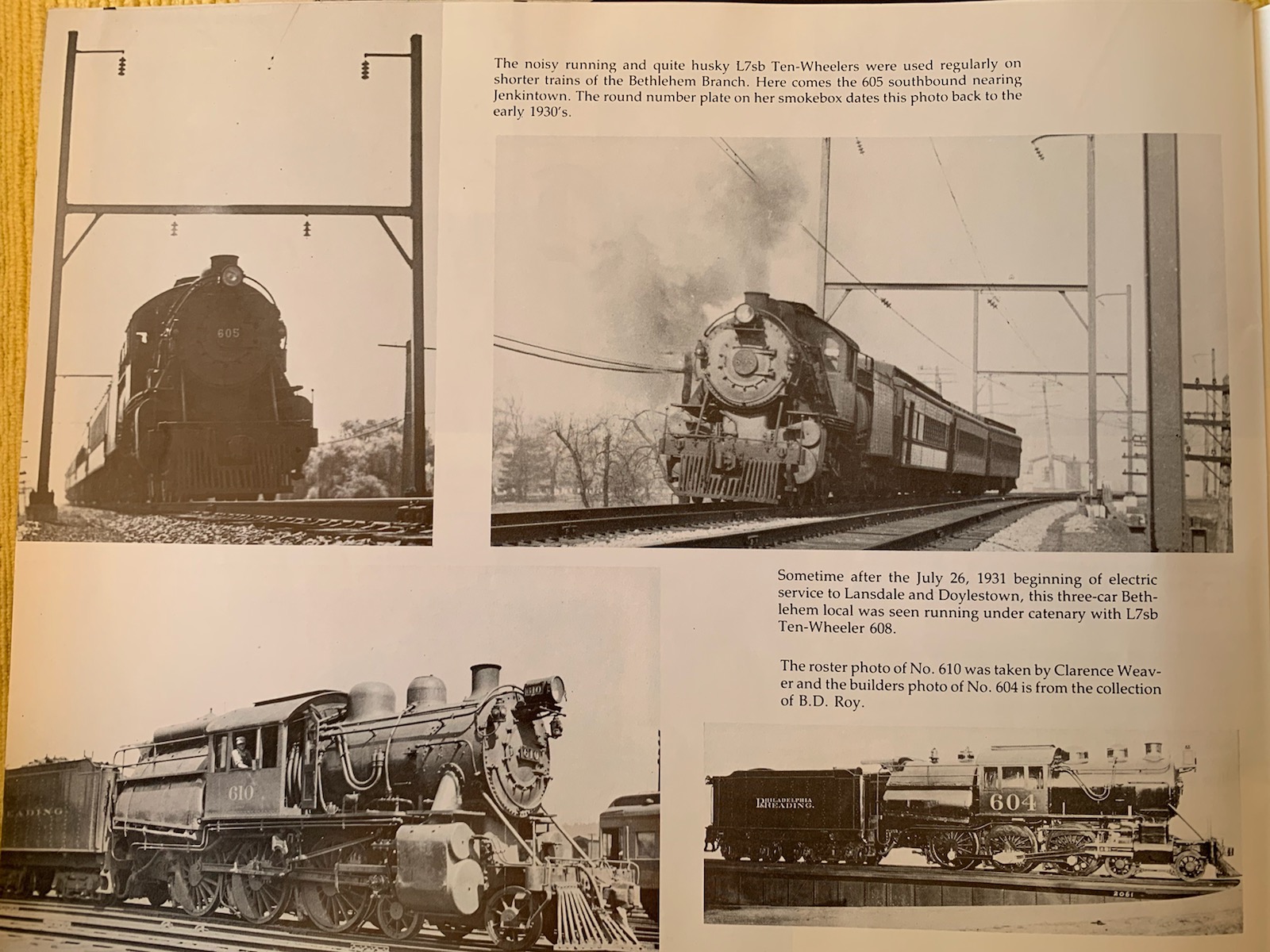

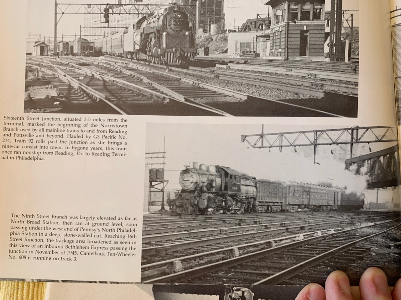

Whoa! This is gonna be awesome.
My Reading steam book is with my Dad at the moment, but I'll ask him to get some photos of the 4-6-0s for you. I know 4-4-2s were more common, especially in the SJ area, but I know ya gotta take what you can!
  • Posts: 26164
  • Respect: +11690
Re: N scale camel back
« Reply #29 on: March 14, 2022, 12:05:36 PM »
@EdKap2 comes through.
