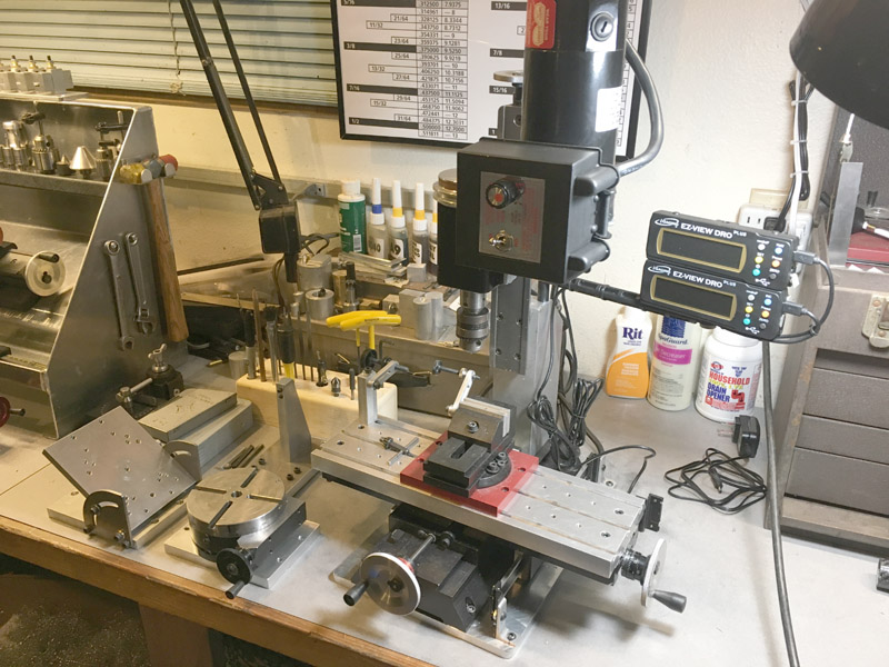

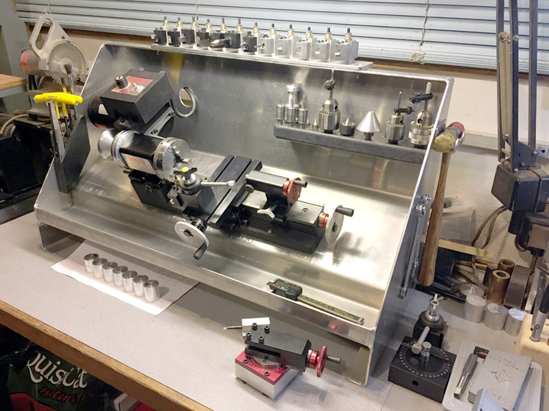

« Reply #32 on: October 18, 2016, 02:07:43 AM »
I am also a fan of Sherline. They are very well made machines. They are great for us hobby guys and not to be compared to R8 machines.
Keep in mind getting the machines is only half of it, tooling is the other half. I have spent a lot of time making my own tooling. Acquiring cutters is never ending!
Just got two axis DRO on the mill and that makes machining much more enjoyable.
Paul
  • Posts: 33747
  • Respect: +5840
Re: Small Milling Machine and Accessories recommendation needed
« Reply #33 on: October 18, 2016, 03:42:53 AM »
Nice setup Paul!
I agree that it is not just the machine but all the attachments and accessories which make Sherline a great tool!  Sherline also keeps coming out with more and more innovative accessories.  The great local English-speaking tech support and easy ordering are also a great perk.  Micro-Mark used to carry Sherline (that is when I bought my lathe back in the '80s). It is too bad they went with the larger (and bulkier) Chinese tools.  I have the Sherline's version of the DRO and I switch it between the lathe and the mill (depending which one I'm using).
