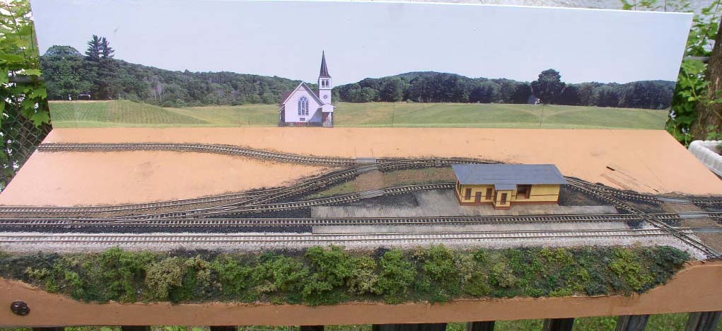

In the middle of that process right now on the Ross Run module.    I've always done track painting first, then scenery, and ballast last unless there's good reason not to - like you're displaying a module and the track - as is - looks so bad you can't stand to look at it.
I've been experimenting with the track painting methods in MR as they were somewhat similar to what I've done before with my own experimentation, but on my logging railroad and steam-era I wanted a lot more weathered-looking ties; i.e. non-creosoted.   So I'm starting with a coat of rattle-can gull gray, then applying a wash of 50% dirt and 50% grimy black - diluted down about 50% on the ties - brush applied.   Then I'm brush-painting rails.    Then a THOROUGH retest of everything to clean up and make sure I haven't messed everything up.   Then scenery, and whatever I'm using for ballast last.  On the logging spurs it will be dirt to about 50% of crib depth.
I'll still do a touch-up after everything, but not much has to be done.
I did the West Hickory module this way and it came out the way I wanted - this is PRR 1920's.    I did the dirt ballasting on the industrial spurs, cinders on the side tracks, and Arizona Rock & Minerals PRR medium gray on the main.   I've got a lot more structures to add and fill in, but the module was going on display at Altoona so I 'ballasted' the sidings.
This isn't Bob's quality of track, it's mostly Peco C55, but I'm happy with the results.  Those gray-brownish ties are what I was really after here.   I got complimented on my 'handlaid' track on that module, and had to vehemently deny it - so what gave me that review was the appearance of hand-stained ties.
