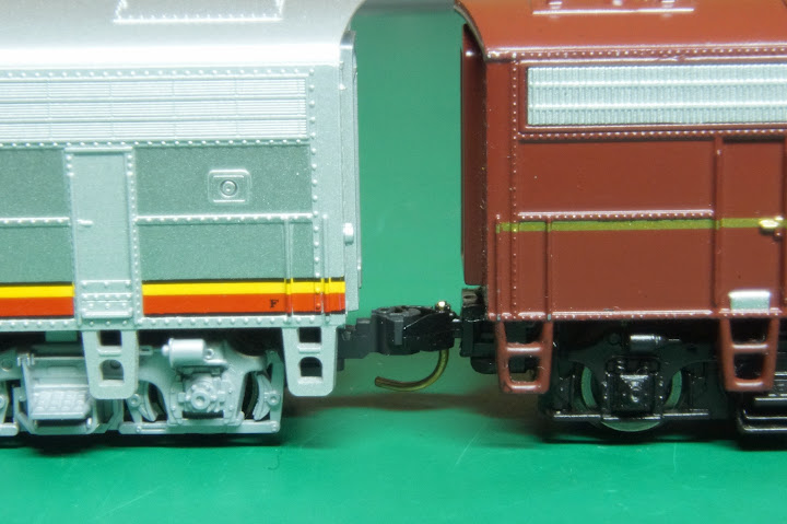

Adding Micro-Trains couplers was a bit hard.  I did not use stock couplers but kitbashed some to fit.
Close coupling is moderately good with this kitbashed coupler.
There is not a lot of clearance between the back of the coupler and the truck.  A common problem with F units.
Here is the rear coupler. I kitbashed an old MT coupler.
I drilled a hole in the coupler retainer. I then used an Atlas coupler screw to hold the coupler in place. Works great.
Top is an old stock MT coupler. Bottom is the trimmed coupler.  I don't remember the MT number.  These go all the way back to the Kadee days.
This is a 1015 MT coupler used for the front and I have greatly trimmed the coupler box.
Top is a stock MT coupler. Bottom is the trimmed coupler. I needed a shim to raise this coupler just a tiny bit.
