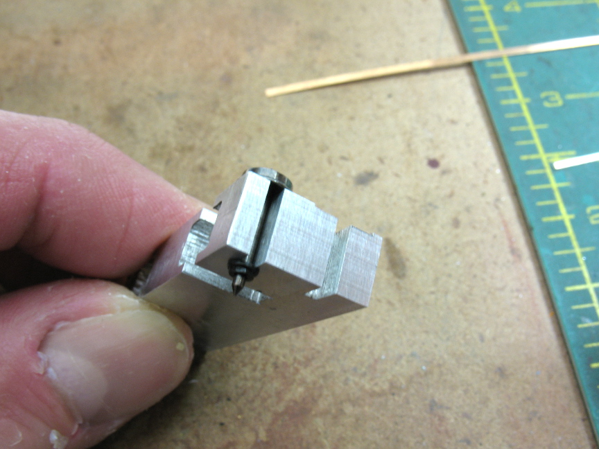

Joe, what did you glue the wheel back on with?   If ACC, I'd never trust it.  Best to go with a 2-part epoxy or Loctite,
or even Walthers Goo.  When that stuff sets up, it is REALLY strong, and it sticks well to plastic and metal.
Anyway, I made my jig and fixed a wheel.  I put the rim back on with Loctite 648 Retaining compound.
It rolls perfectly true, to my eye anyway.  Whether the glue will hold, I have no idea.  I'll put it into a truck on one
of my freight cars so it rolls around in a train and see what happens.

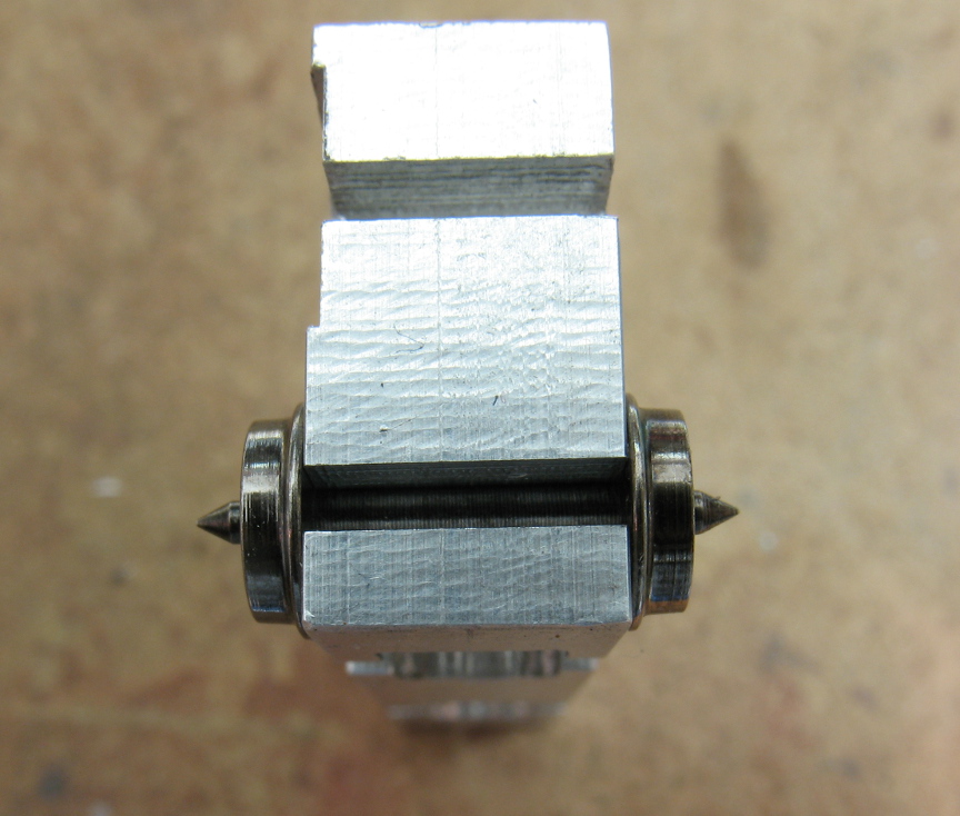

Here's the jig, with a broken wheel in it:
Then you apply glue, put on the other rim, and press the rims snugly so they are flat flat FLAT against the jig.
The other plus here is that you are guarantees that the wheelset will be in gauge (assuming the jig is square and is
the right width).
That jig block is the same one I milled to do the quarting for my 0-6-0.  I just keep finding uses for it, and cutting other notches
and doo-dads in it for other purposes!
By the way, the axle in the jig in this next photo has a reflection on it that makes it look like there is room in the slot.
There is not.  That slot is cut to exactly fit the Fox Valley axle (.058"... probably supposed to be 1.5mm).
I cut the slot with a 3/64" end mill (.047"), and then just made another pass to take off another .011" to get .058".
(And no, I didn't get it perfect in one shot... I just kept taking off .003" at a time until the axle just dropped in... I'm not
that good with a milling machine!)

I think this could be done with a block of styrene and hand tools.  The more I think about it, the more I realize that the precision
of that slot isn't all that necessary.  As long as you are holding the one good wheel flat against the other side, and as long as the chunk of styrene is exactly the correct width, it ought to work fine.  I will repeat this exercise just cutting a slot in some styrene with a
razor saw.
I envision starting with some .250 x .250 styrene strip, and then glue some .040" + .010" to it up to 0.300".
It might turn out to be a hair big, because it's just styrene strip, not precision-machined,  so after glueing it up,  cut the slot,
and test it with a good wheelset.  Assuming it's a little too wide to drop the wheelset in, just flat-sand it down by swirling it
on a flat sheet of sandpaper.
None of this would be as "perfect" as a mill, but it doesn't have to be.  Remember, the diameter of the wheels is very small.
So the chances of having a variation in the width of the styrene block by more than 1 or 2 thousandths across the diameter of that wheel are pretty remote.
What all that means is that if you are just "careful", the jig should turn out fine and the wheels should end up pretty darn
square to the axle.
                                                                  I'll try this and take pics.
Now I really wish I had not thrown away all those broken wheelsets I've come across over the past few years.
(and if anybody doesn't want to try to fix theirs, I'd be more than happy to have them before you throw them out.    :) )
