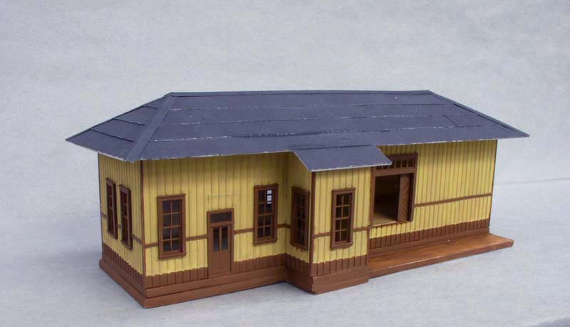

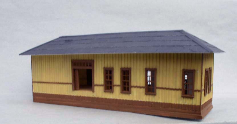

The scratchbuilt West Hickory depot project continues on.   This is one of those projects that demanded a lot of front-end painting before assembly; paint the walls and trim before glueing everything up, paint the windows before insertion, etc.   So it looks a lot more finished than what it is - still a lot of detail to do.
It looks 'high' because it has to be set down in a foundation so that railhead height is about even with the front door bottom - 6" on the T-trak module.
I ended up settling on Pollyscale "TH&B Cream" and Testors "Military Brown" when I compared them to other PRR depots on the same line that long outlived this one and some color shots survive. The Oil Creek and Titusville freight depot at Titusville (now their headquarters) is a PRR building of the same era - only 14 miles away.  http://2.bp.blogspot.com/_2G3albEzma4/TL-pmQDnakI/AAAAAAAACt0/yVsgG2UQf4w/s1600/Titusville+Station.jpg   While I really like that 'three color' scheme with some red, I can't find any evidence it was used up here.
Just put the tarpaper on a few minutes ago, lots of touch-up do do there.
The windows and doors are Tichy.  The only trick I did here was to cut the freight side doors open and put a high floor in there - this will be right on the front edge of the T-trak, be the center of attention, and I'll likely have detail on the inside where it is visible.
I consider myself a card-carrying ATSF modeler and a logging modeler, so doing something PRR is way out of my skillset, but it's kind of fun.   At least it explains why I've built an L-1, two PRR cabooses, have a Bachmann doodlebug (one ran on this line) - because 'someday' I was going to model the HVRR/PRR interchange at West Hickory.

Very nice! I, and a few others use Pollyscale Aged Concrete and Roof Brown.

I asked an ex-PRR/PC/CR engineer (from 1955-1997) what the official colors were the PRR used (the tan/brown combo) on their various buildings and he said that while there may have been official colors at one time, the paint crews pretty mixed whatever they could that looked close in shade... With the obvious result being those shades could very a great deal from building to building.
