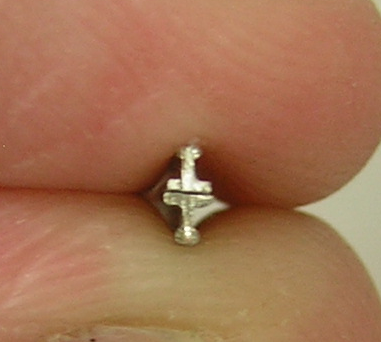

Curiosity got the best of me, so I decided to scavenge some Atlas rail from one of my broken #10 Atlas turnouts.  Lo and behold, a full length piece of Atlas rail fits perfectly in the CVP tie strips.  The base of the Atlas rail measures between .053 and .054 with my calipers: a mere .001-.002" narrower than the weathered ME rail I have, but that seems to be enough to make a difference.  Here is crappy shot comparing the two rail cross sections (Atlas on top, ME on the bottom):
The Atlas appears to be ever so slightly narrower.  Here is an end view of the two rail samples embedded in the CVP ties (ME on the left, Atlas on the right):
Note how both ME rails are canted to the left while the Atlas rails sit true in the ties.  It remains to be seen how full-length pieces of ME un-weathered rail will fare, but at least Atlas rail presents another option.
