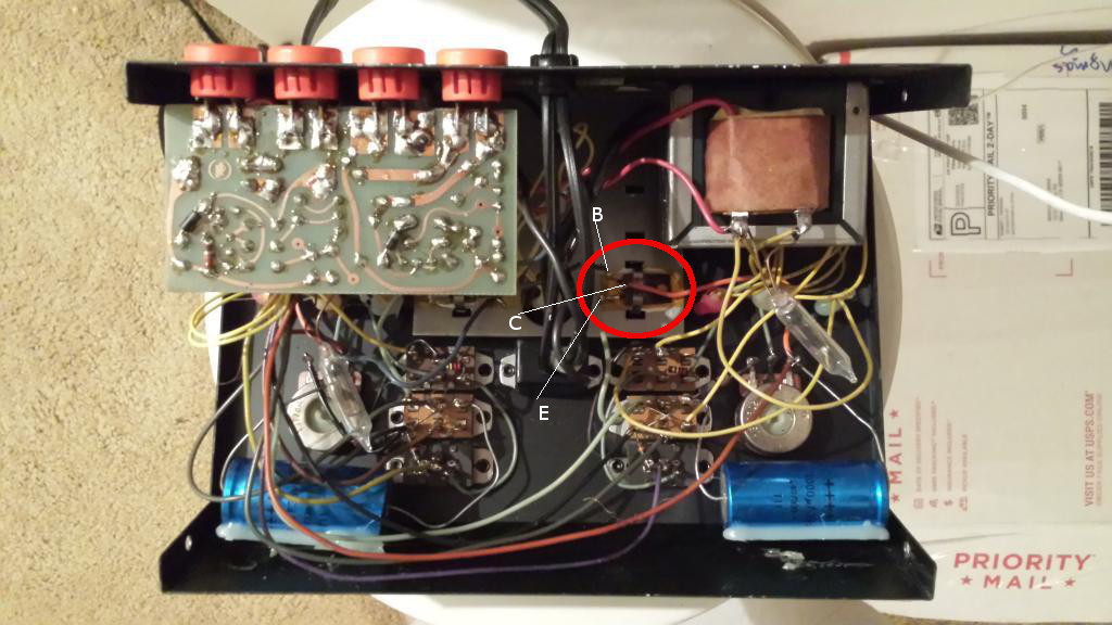

Part number off this (circled):
On the glass bulbs... yes, since you were getting weird readings, unsolder one lead on each one, and then measure the resistance of them.  It should be zero (a dead short).

  • Posts: 6500
Re: Troller dual power pack
« Reply #54 on: March 15, 2016, 07:04:32 PM »
Thanks, Don.  I didn't see that.
Okay, so those are NPN power Darlingtons.  Surprisingly, that part number is still available
(although any decent high-powered NPN Darlington would probably do.
Terminals   B   C   E
Since it's NPN... I'll take a slight guess here and bet that it's just a current amplifier here, so we should
see the base voltage rise and fall as you turn the throttle speed up and down, and I would hope that if it
does, you'd see the emitter rise and fall too.
sd75i  -
Here's a little test.  See what you get if you set your meter on DC volts, hook a small load on the throttle outputs like a grain-of-wheat lamp, hook the "-" meter lead to the case, and then put the "+" lead on the
"B" (Base )of the transistor shown in the photo below.
Note: I don't know which transistor is for which throttle side, so you'll have to try both.
Turn all the momentum and braking off.    Turn the throttle up and down and see if
the voltage on the base of that transistor rises and falls.  Then do the same on the "E" (emitter).
If the Base voltage is rising and falling, that would tell me that most likely all the rest of the throttle is good,
so if we're lucky, this will eliminate a lot of guessing.  If the Base voltage is dead, then we have to keep digging.
« Last Edit: July 02, 2017, 03:36:44 PM by mmagliaro »

sd75i
  • Posts: 290
  • Respect: +16
« Reply #57 on: March 17, 2016, 07:19:21 PM »
      Ok I did that test with the measuring of circled B and E and got No reading.  Both sides.  If it helps,  I did accidently cross B and C with + voltage lead and throttle light lit up?  It didnt matter whether throttle was off or on full.  Im trying to get part number now.
sd75i

  • Posts: 35391
  • Respect: +6683
« Reply #59 on: March 17, 2016, 07:59:27 PM »
The 2 large blue cylinders with leads on each ends are electrolytic filter capacitors (caps).  I assume each one is for each throttle. One lead is welded to the metal end (negative) and the other one goes into a black a rubber plug (positive). Put your meter on DC and 20V range and measure the voltage between the leads of each cap.
Then leave the negative lead of the meter on the negative lead of the cap and then use the positive lead of the meter to measure the voltage on the B, C and E of the transistor corresponding to the side where the blue cap is (left cap to left transistor).  Take the measurement on each lead of the transistor while you are turning the corresponding throttle knob from minimum to maximum and note the voltage readings as you turn the knob.  That might take 3 hands!  :)
