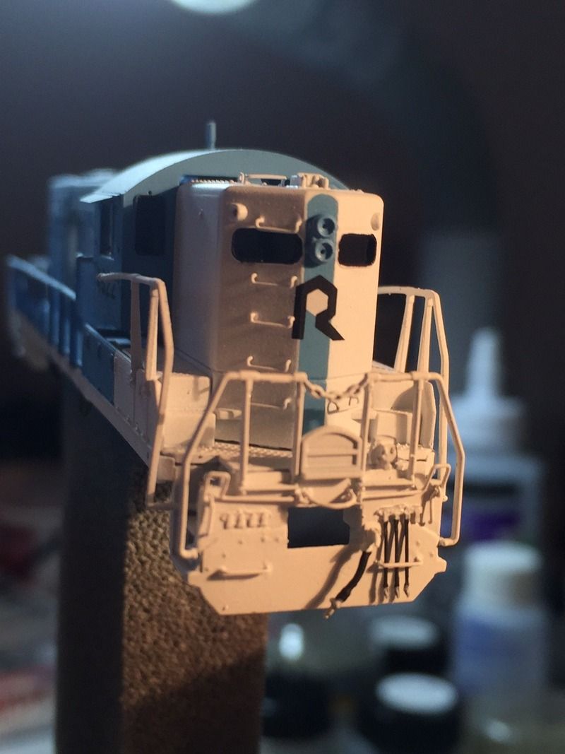

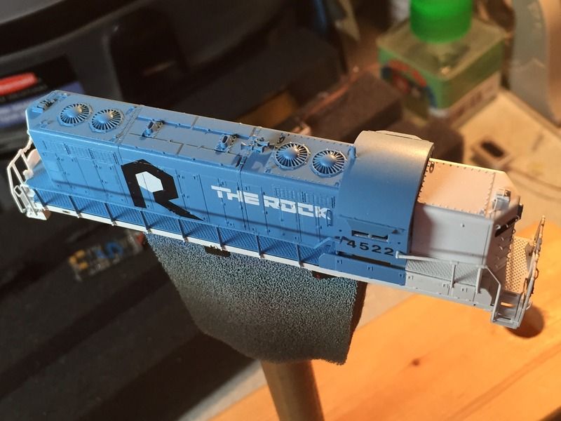

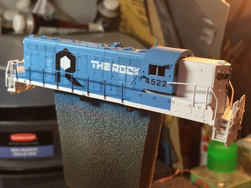

As for me, after last weeks embarrassing paint faux pas, the cab was stripped and repainted, decals applied and sealed, and more details added. Some weathering and final detailing will finish up the shell.

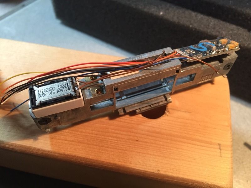

Also milled the frame and started work on the Loksound Micro and speaker install.
Bob

That Rock loco is REALY nice. Who's MU connections did you use?  I thought maybe BLMA but they look more 3D.
Craig

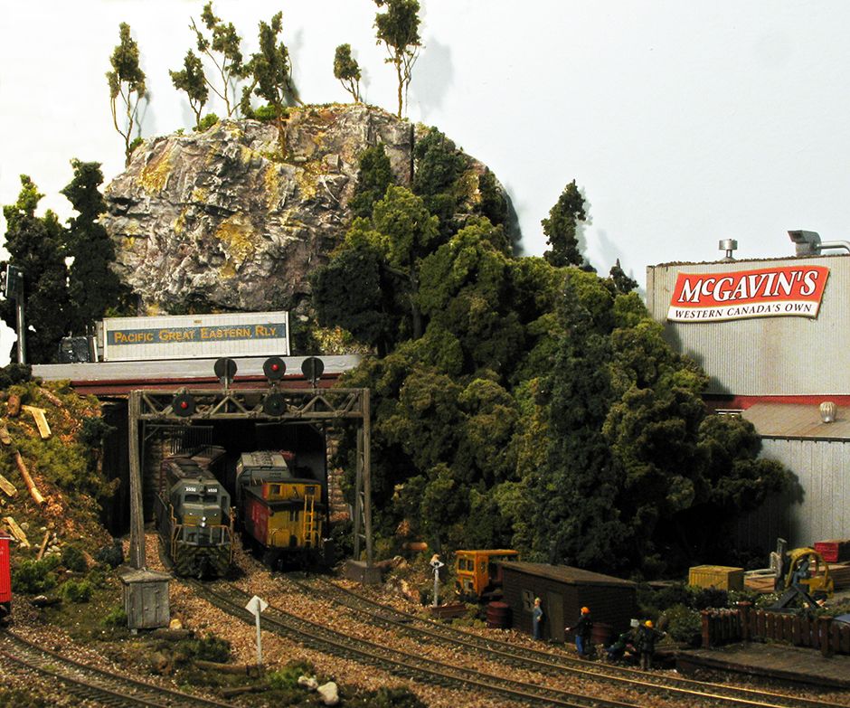

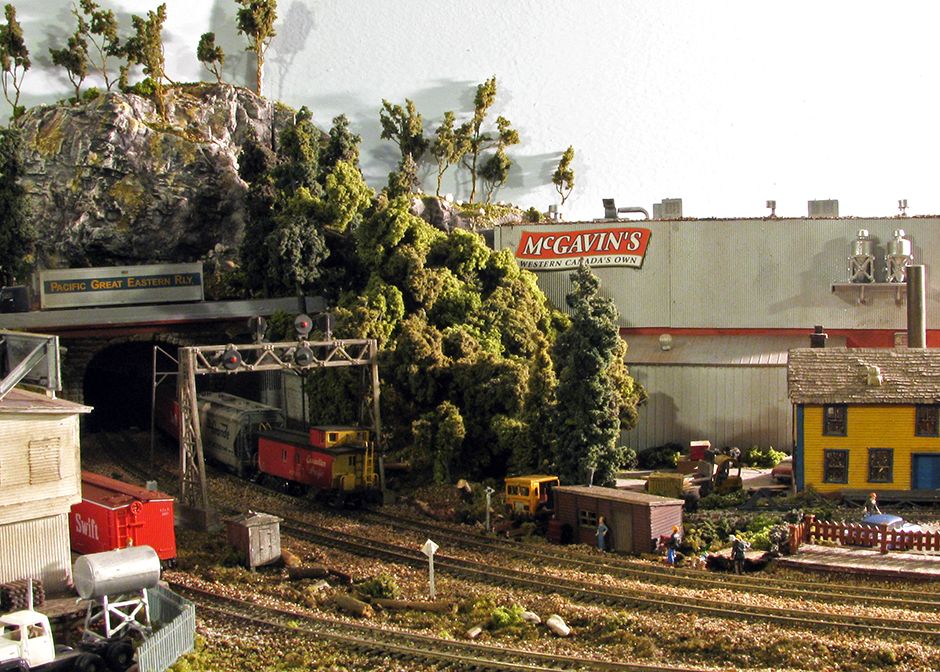

I've just finished the scenic divider for behind the tunnel. Whatever I put there had to be easily removable because I need to get in and have free access to connect the joiner track yet I wanted to hid the break.... I came up with a cliff face.
I used Woodland Scenics molds, joined three castings together and then adhered them to 0.40 styrene and a wooden/foam base that fits the space. The rocks were coloured, decorated and trees planted. The right hand 1/r of the casting was then cut off and adhered to the backdrop. A piece of backdrop was glued to the back of the casting frame and the casting was set in place above the tunnel portal, easily removable.
I like the overall look; adds some "grandeur" to the entrance and covers up a multitude of sins....

Nice backdrop.... awesome!
I added some more rock behind McGavins.... looks better I think....
