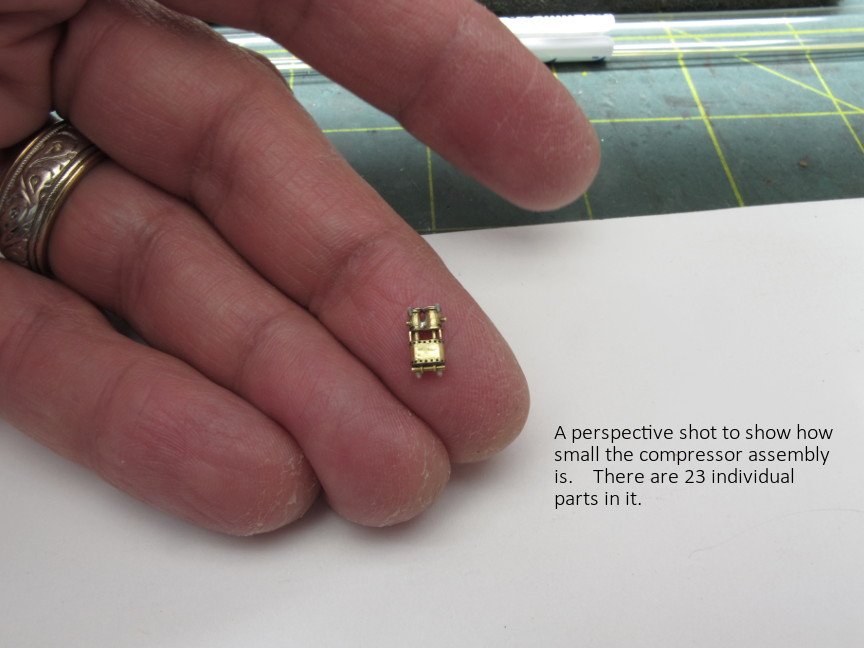

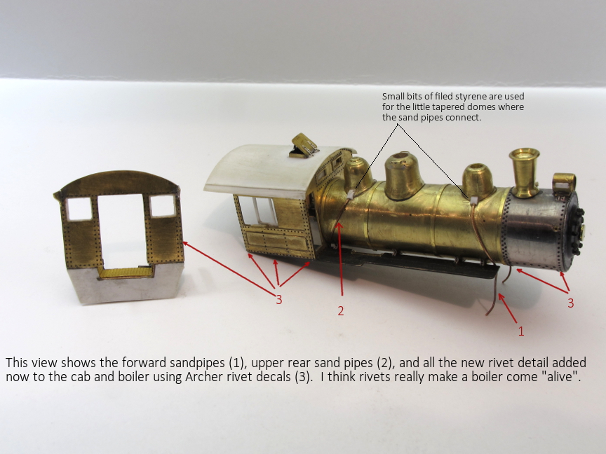

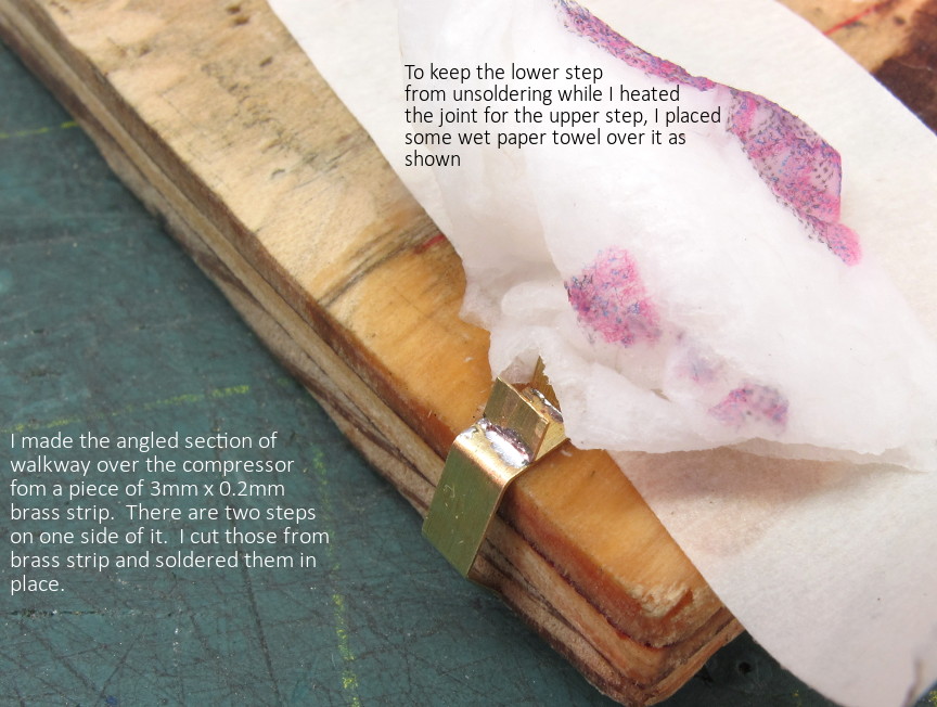

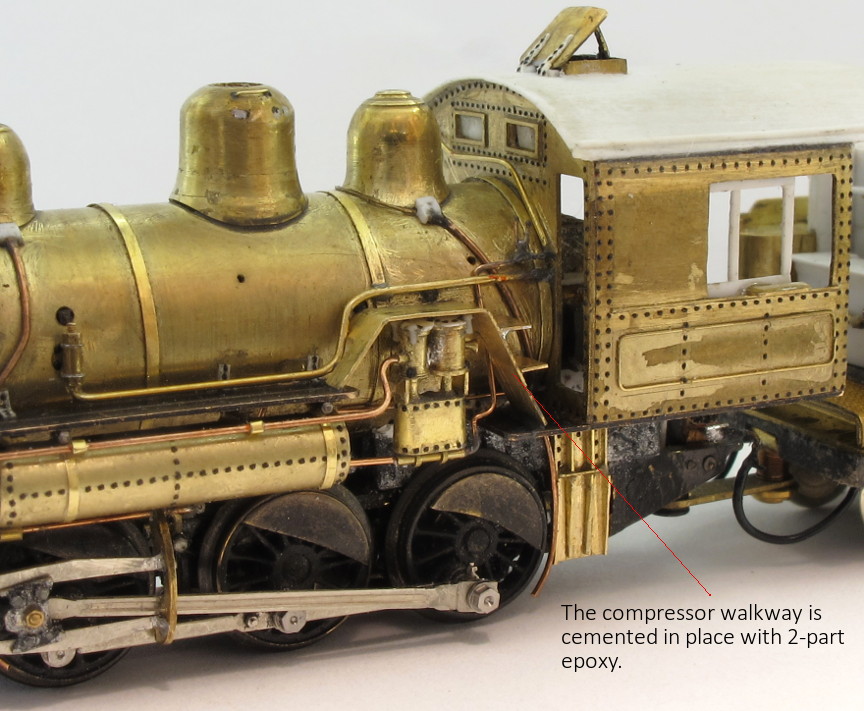

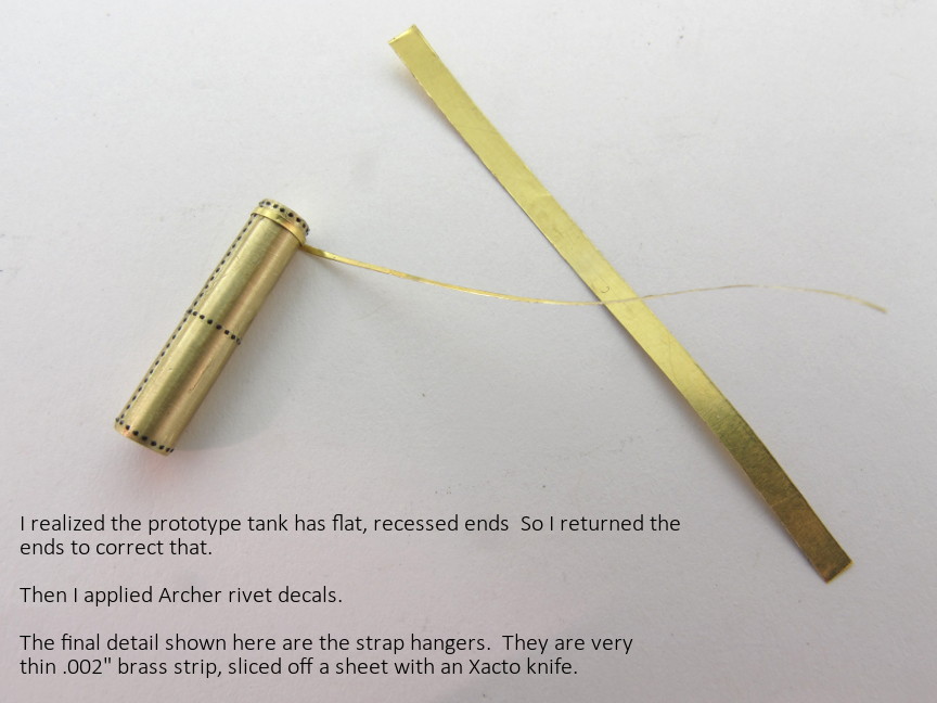

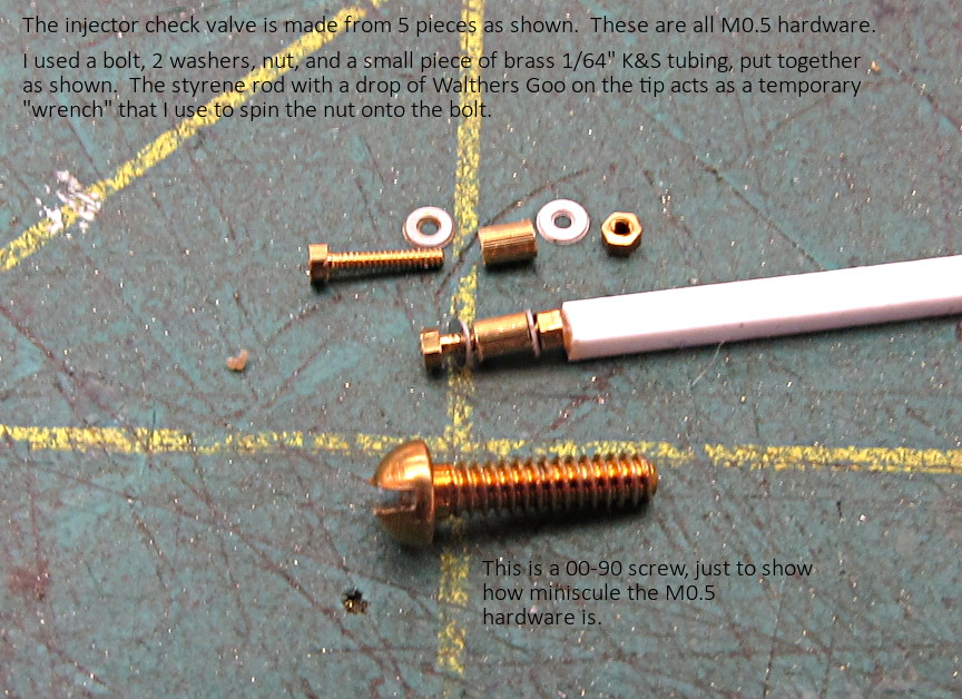

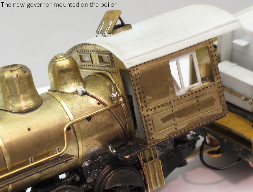

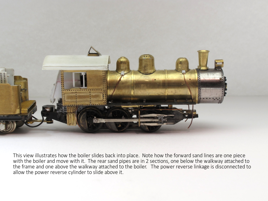

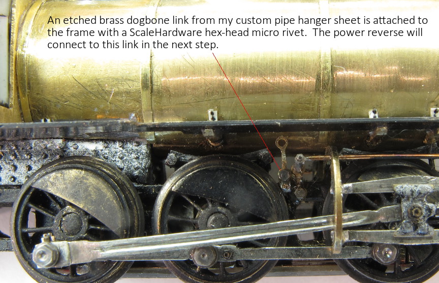

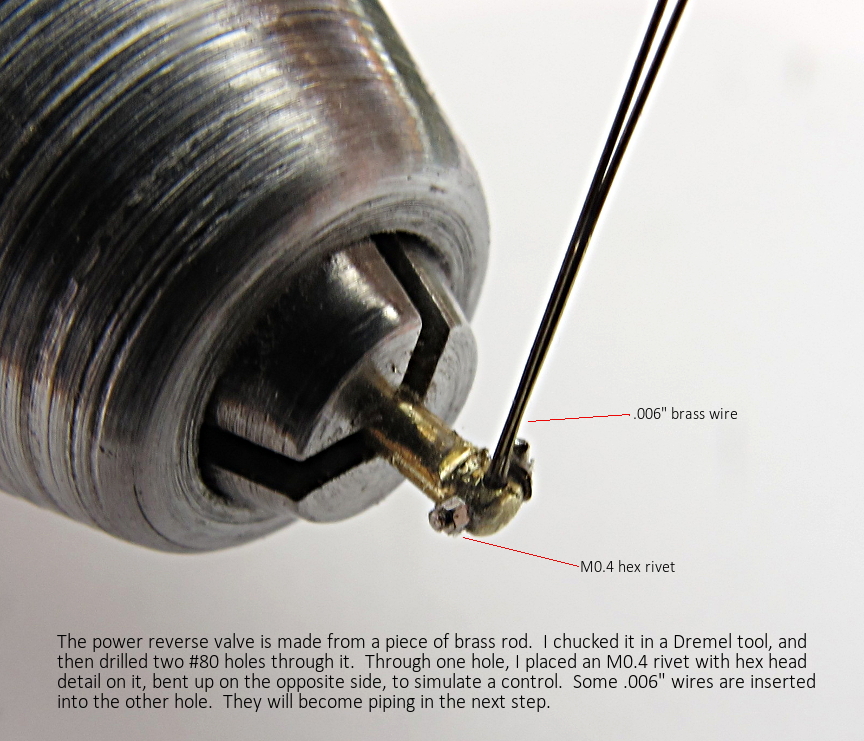

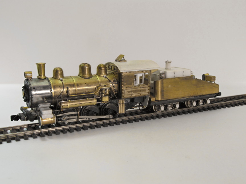

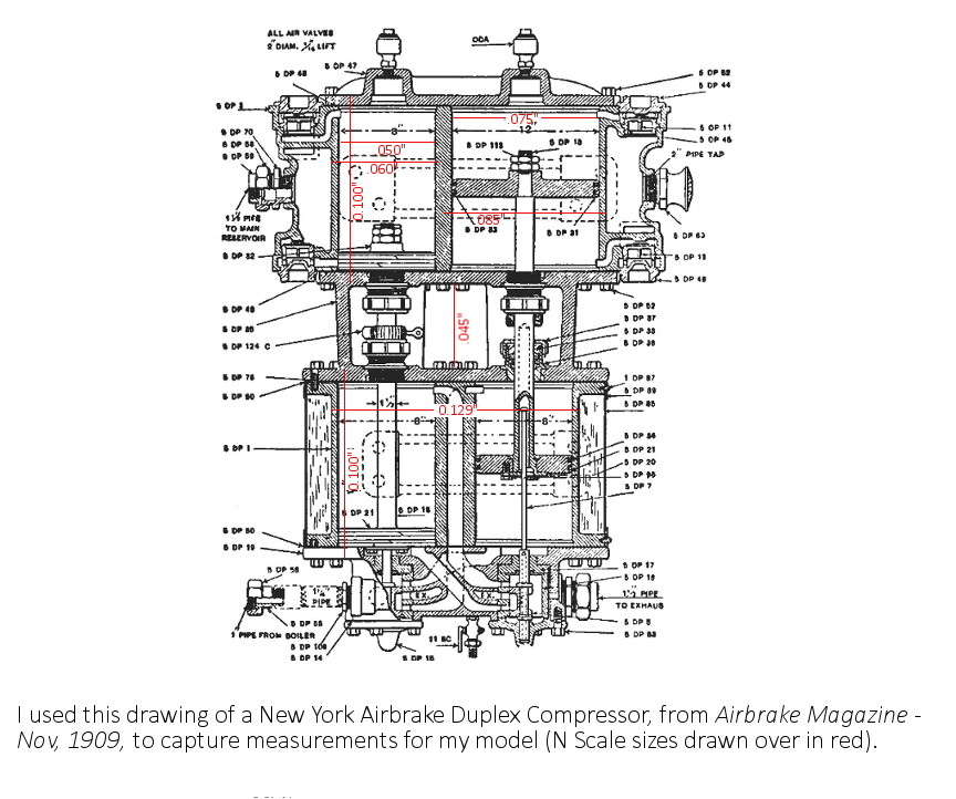

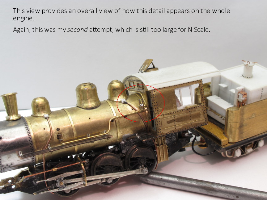

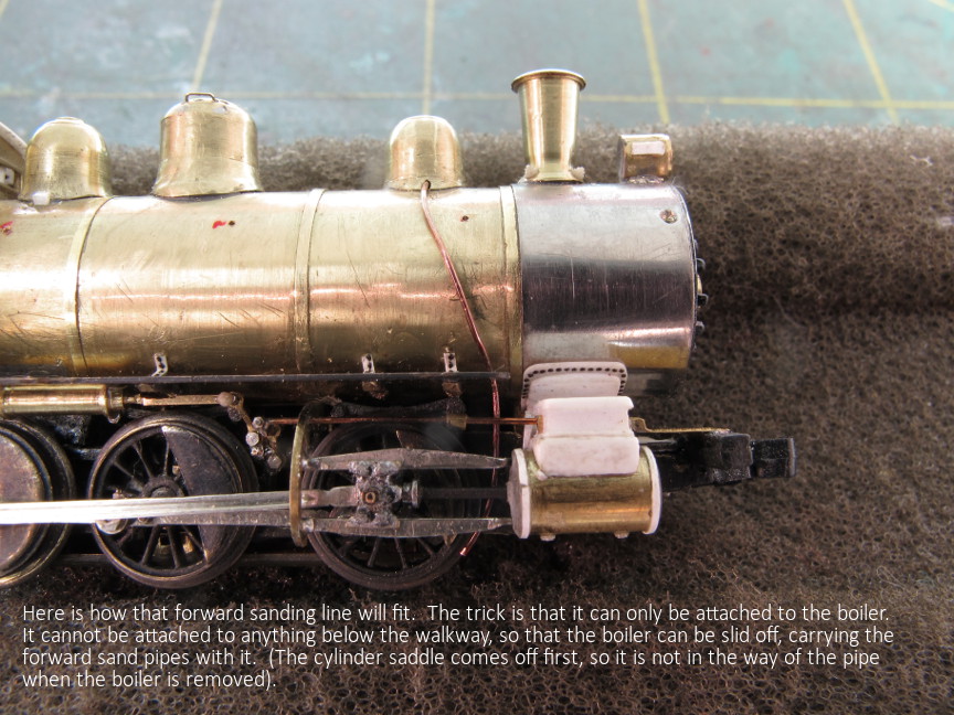

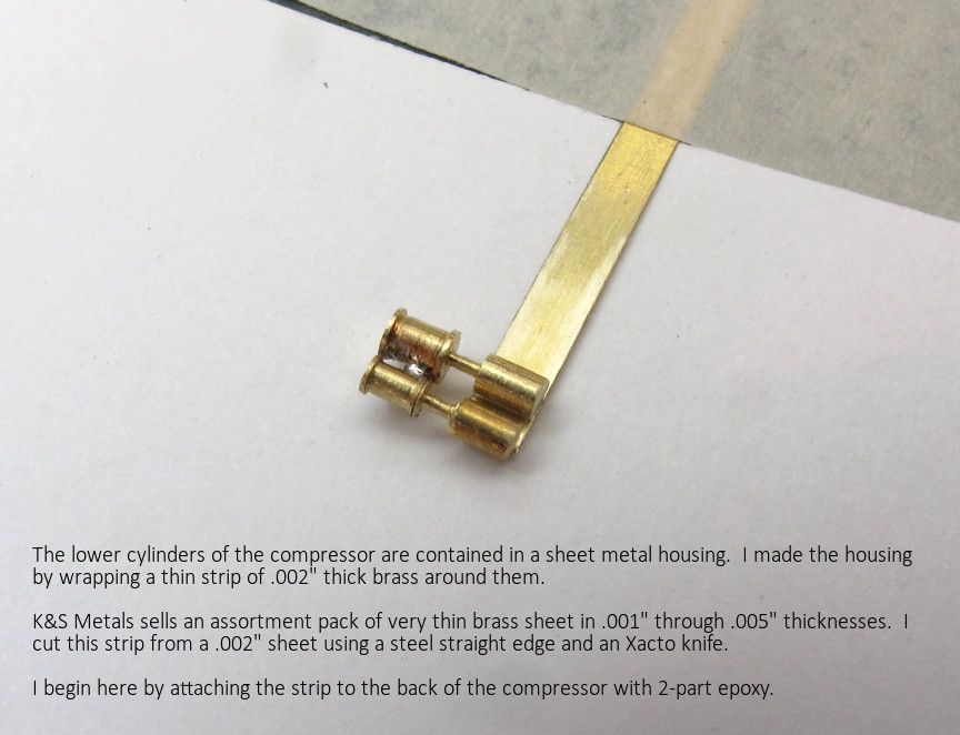

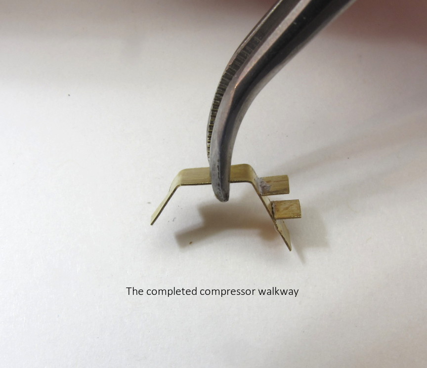

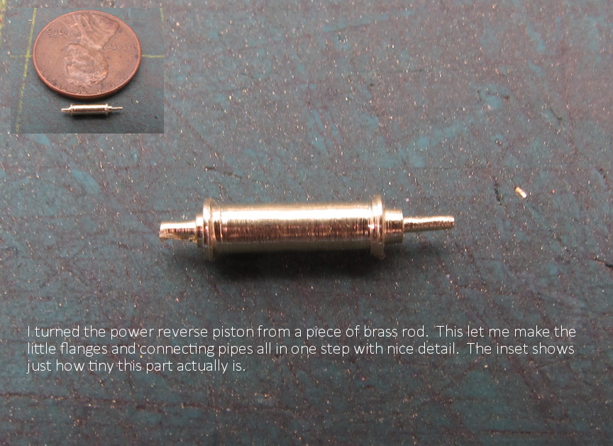

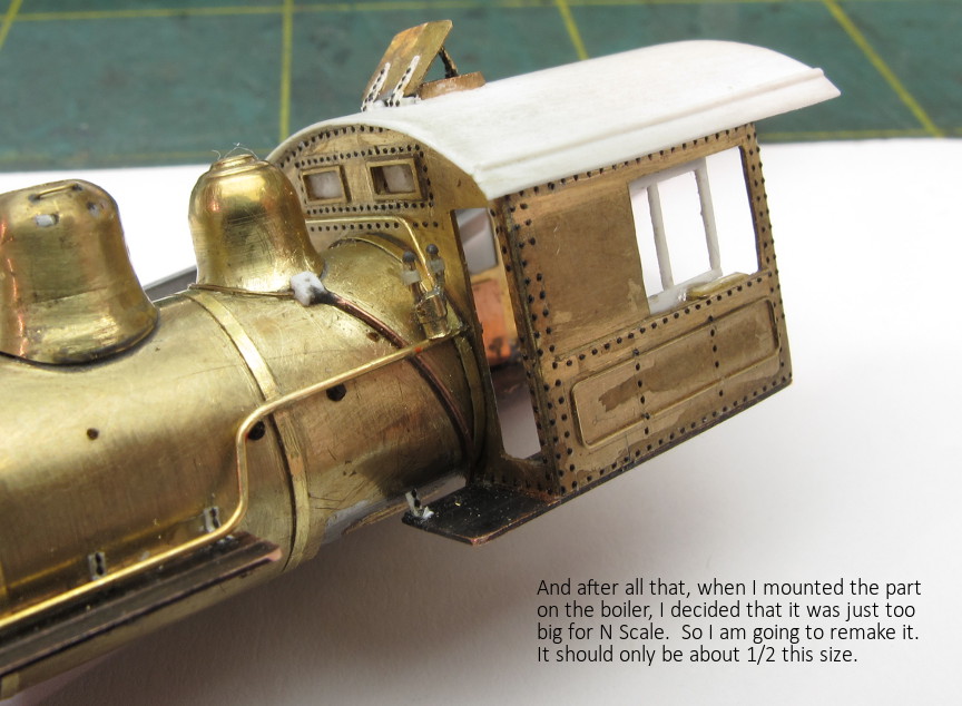

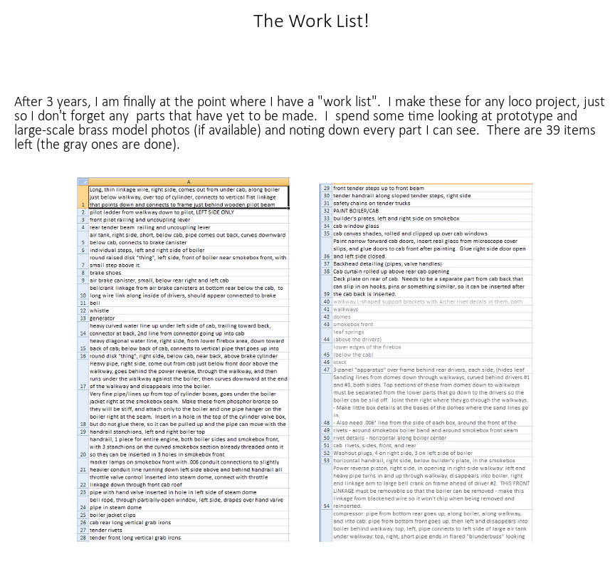

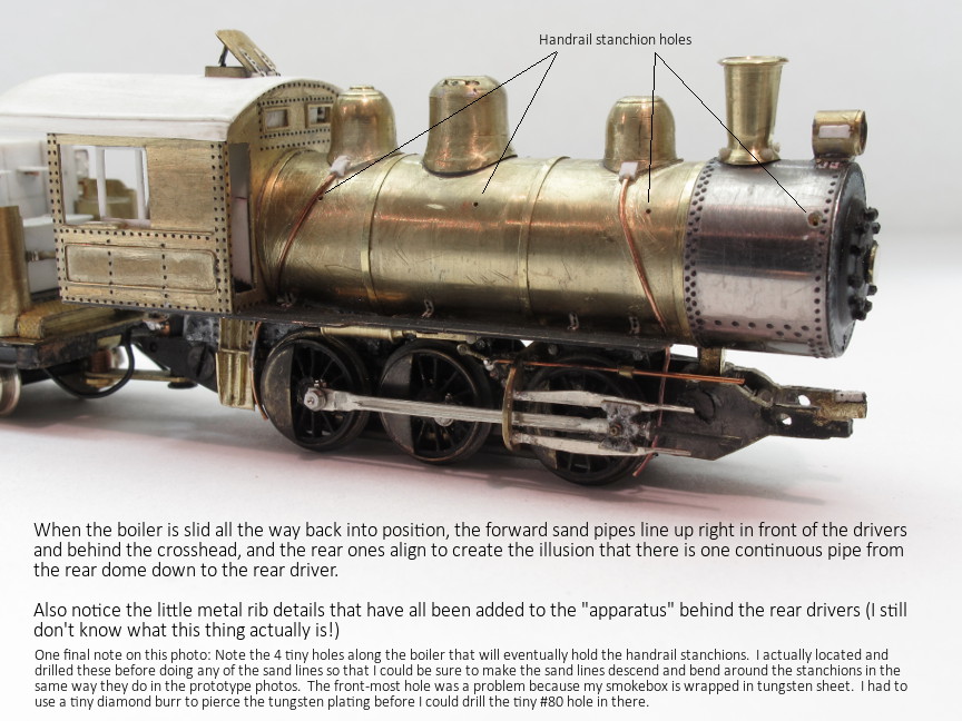

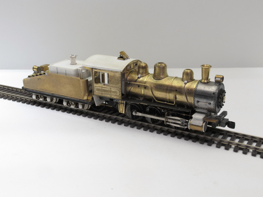

« Reply #313 on: September 12, 2017, 11:03:43 AM »
+12

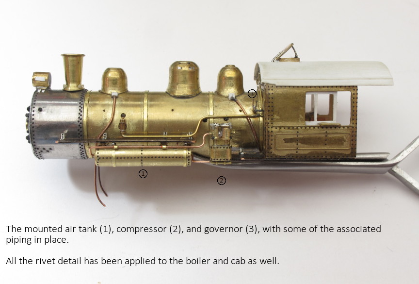

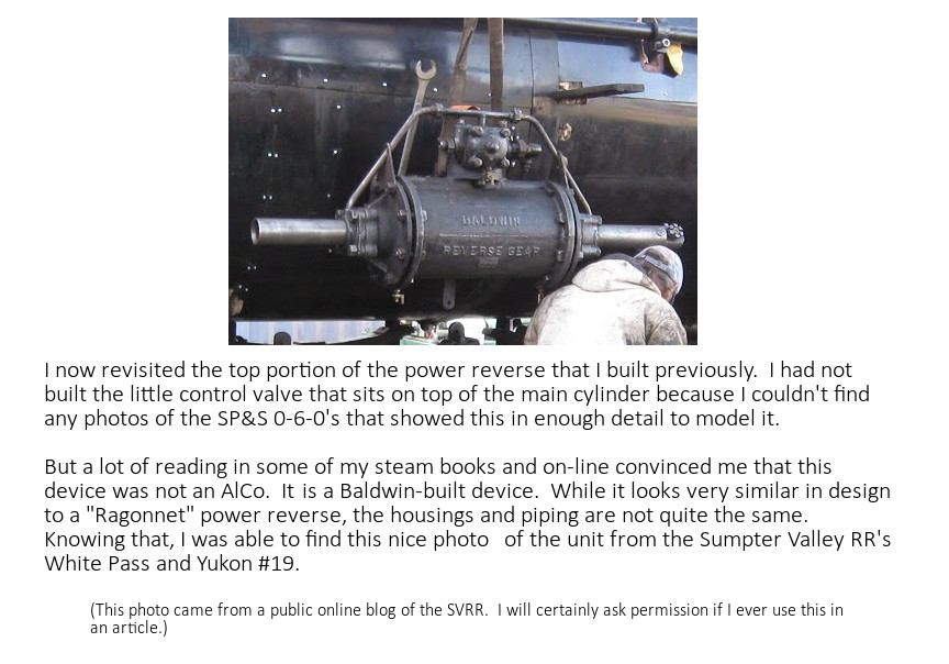

Here's the latest update folks.  There are a lot of photos in this one as I haven't posted in a while.

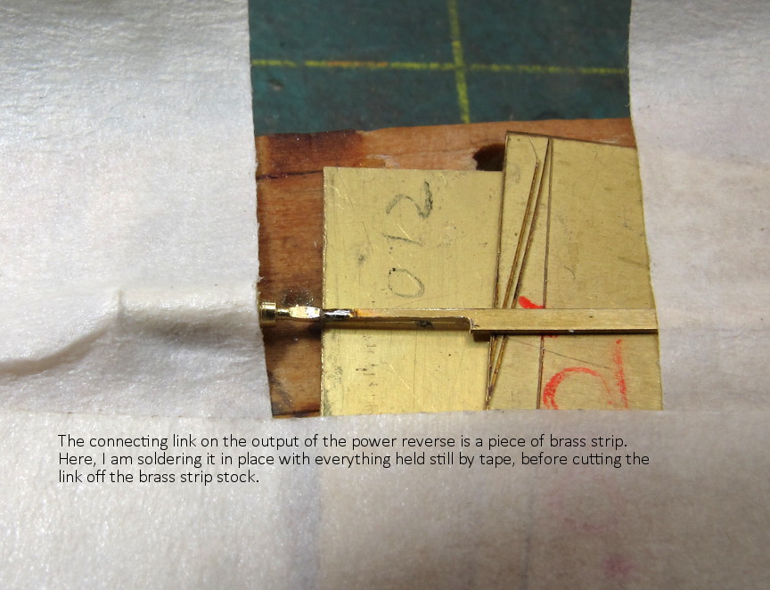

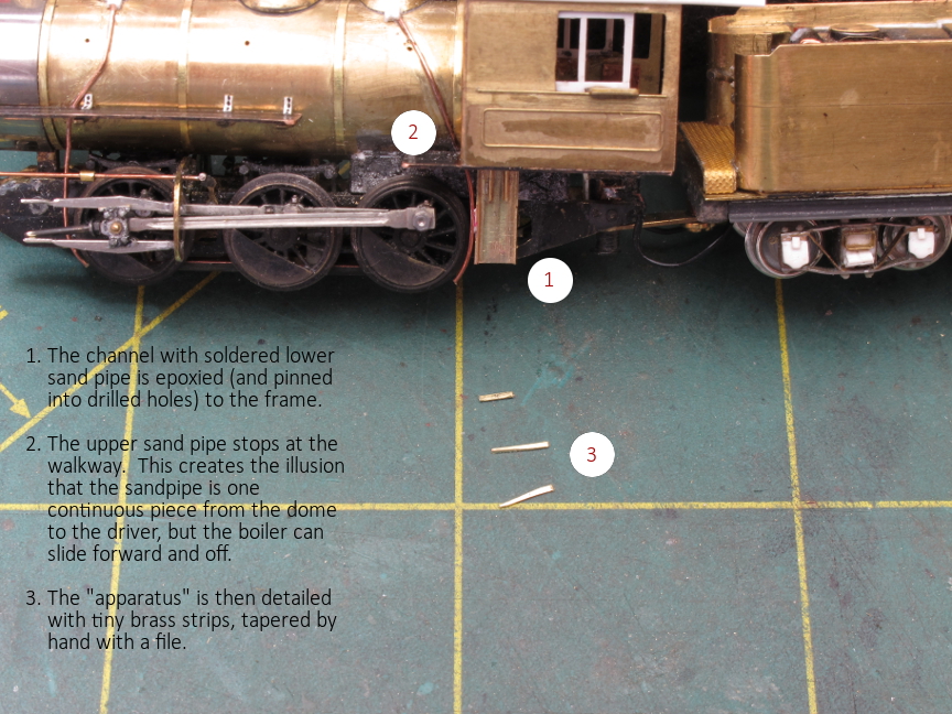

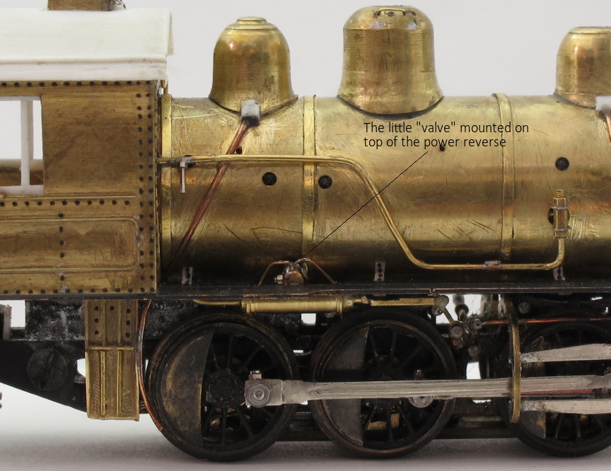

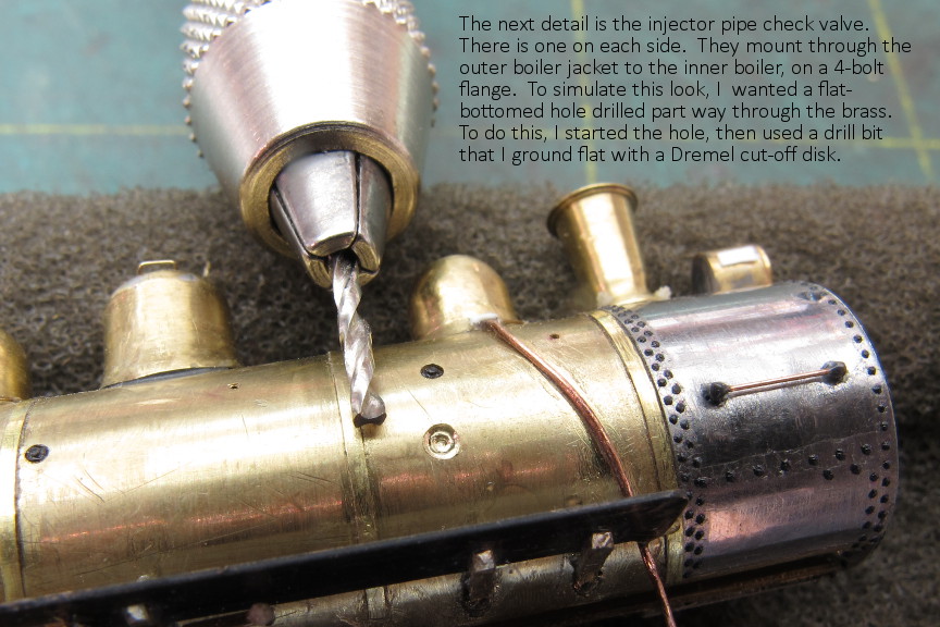

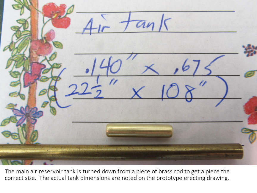

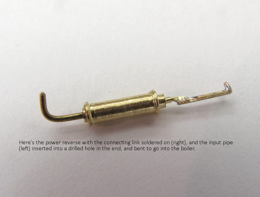

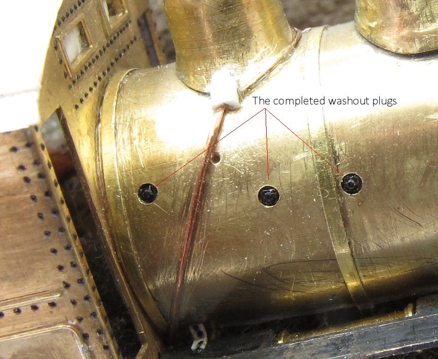

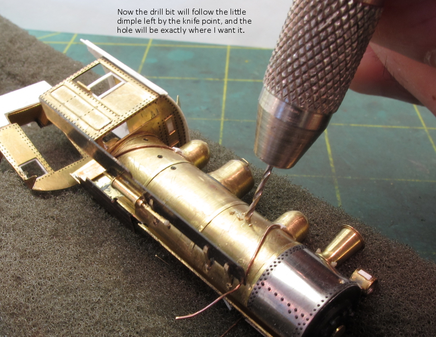

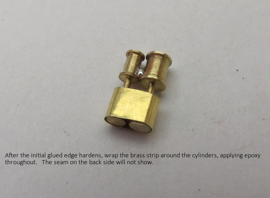

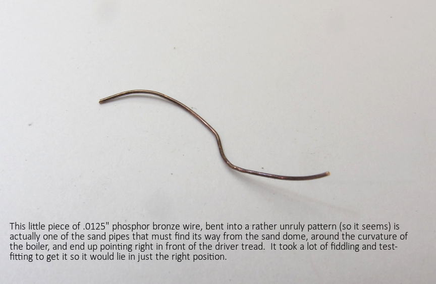

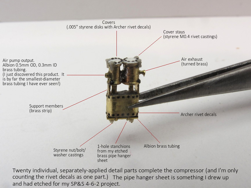

Covered in this installement are a lot of "appliances" on the boiler:  sanding lines, power reverse, air brake governor, compressor, air reservoir, and more.  And lots and lots of rivets!

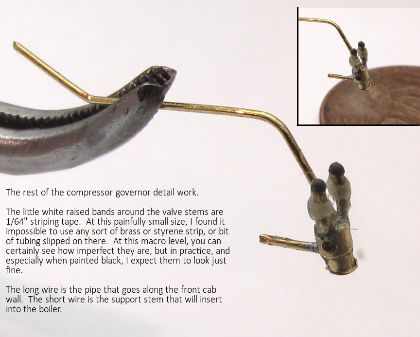

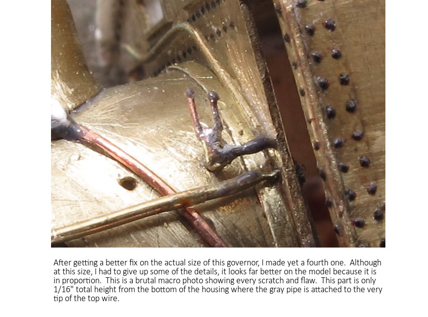

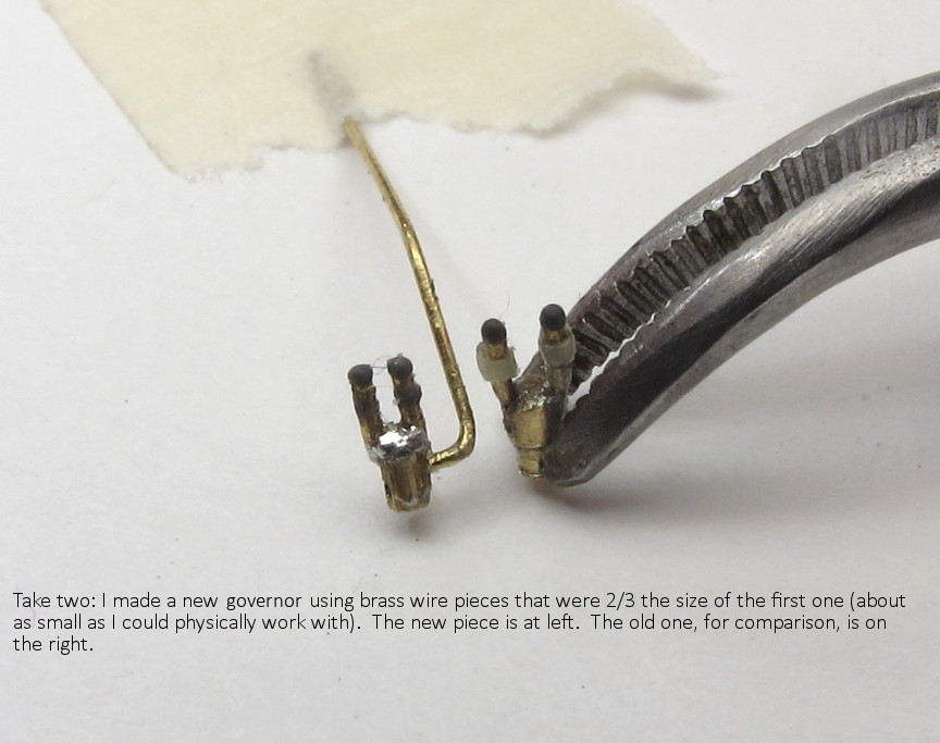

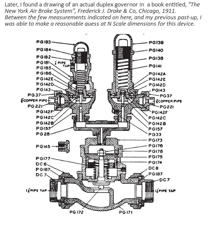

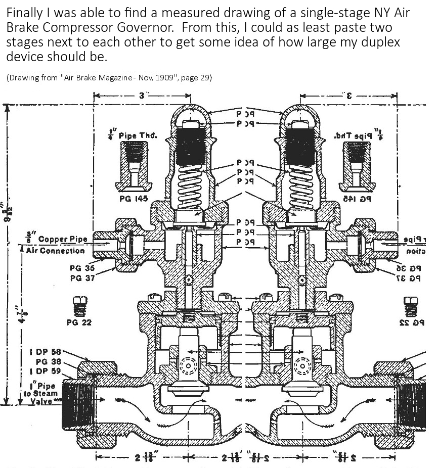

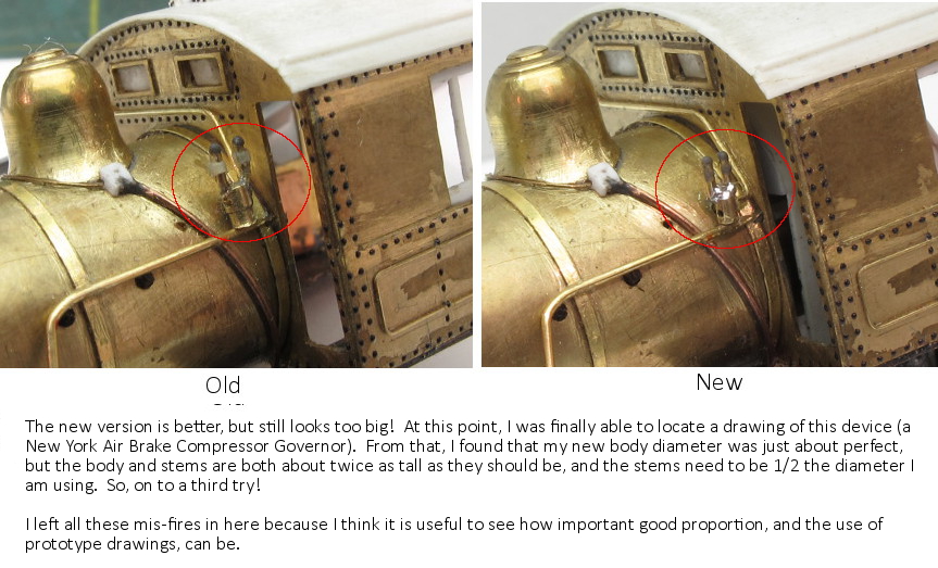

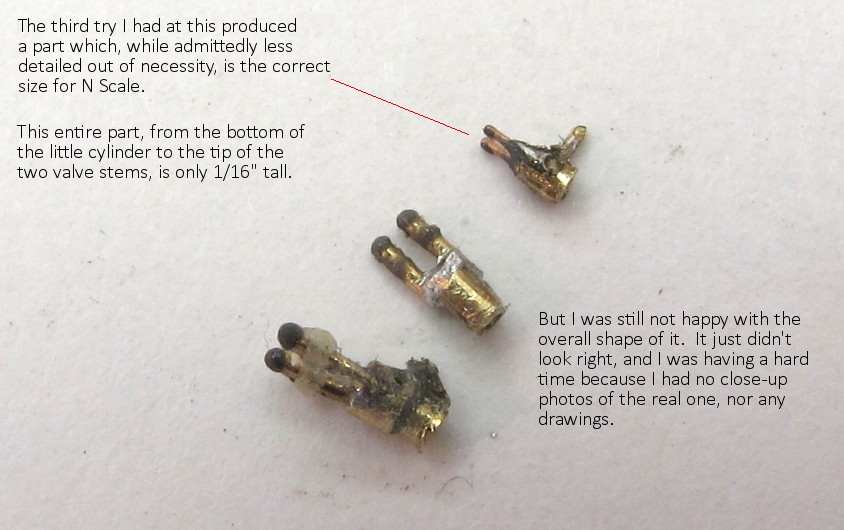

This next group shows a lot of trial-and-error, getting a compressor governor that is actually down to scale size.
It took a while, because I didn't have a drawing at first and had a hard time getting a handle on just how small this thing needed to be.

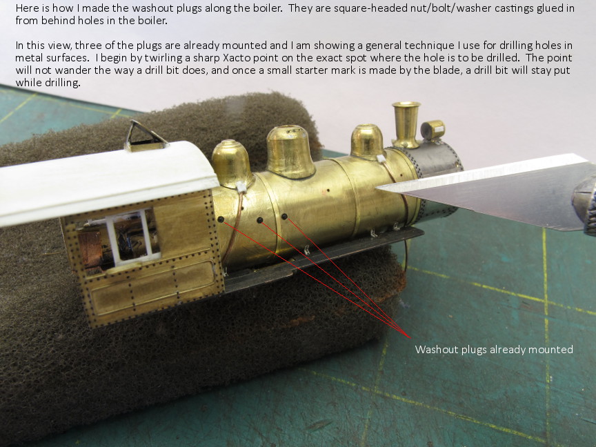

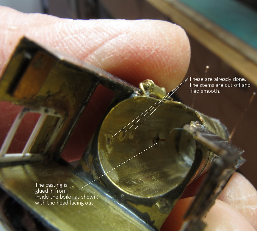

CNR5529
