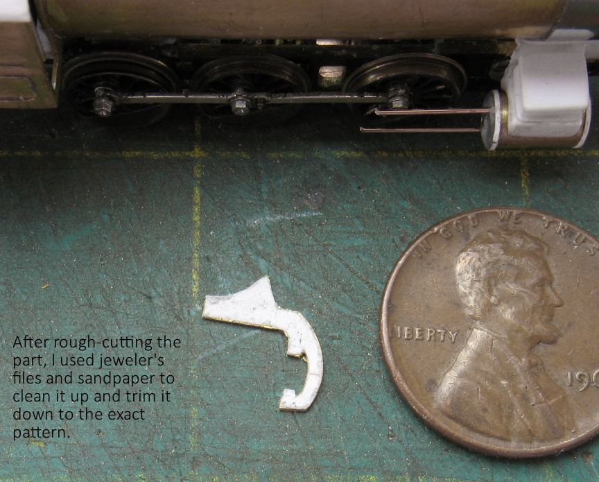

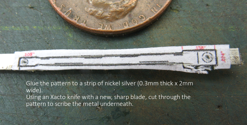

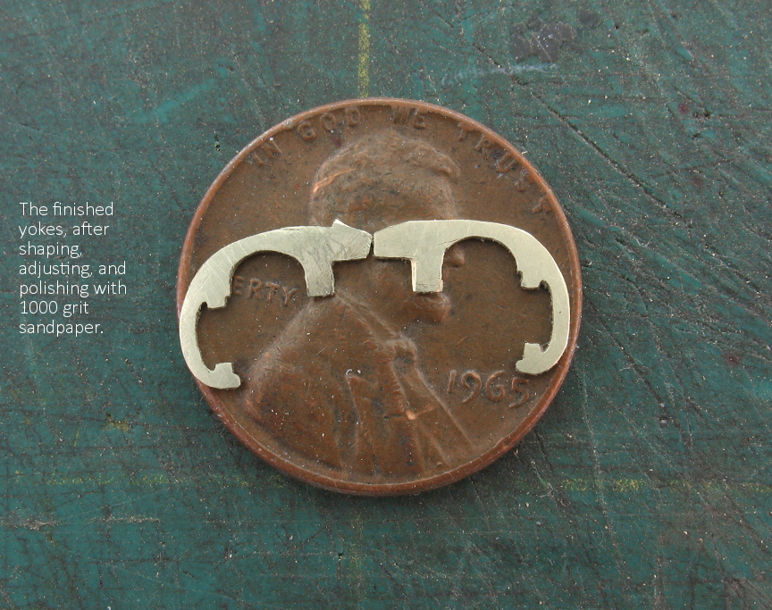

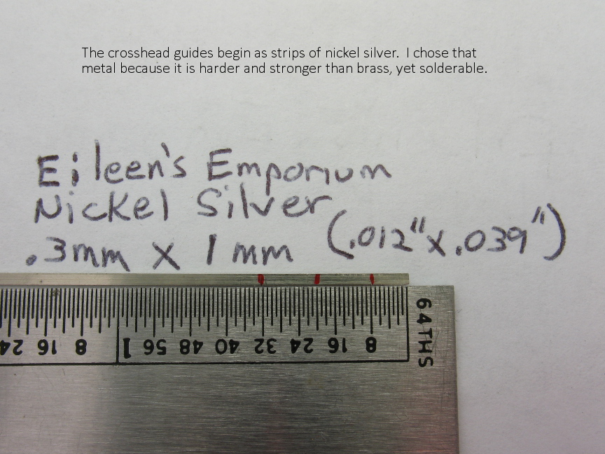

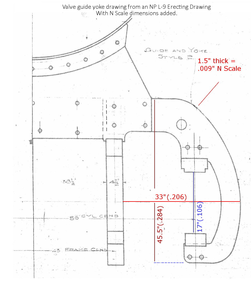

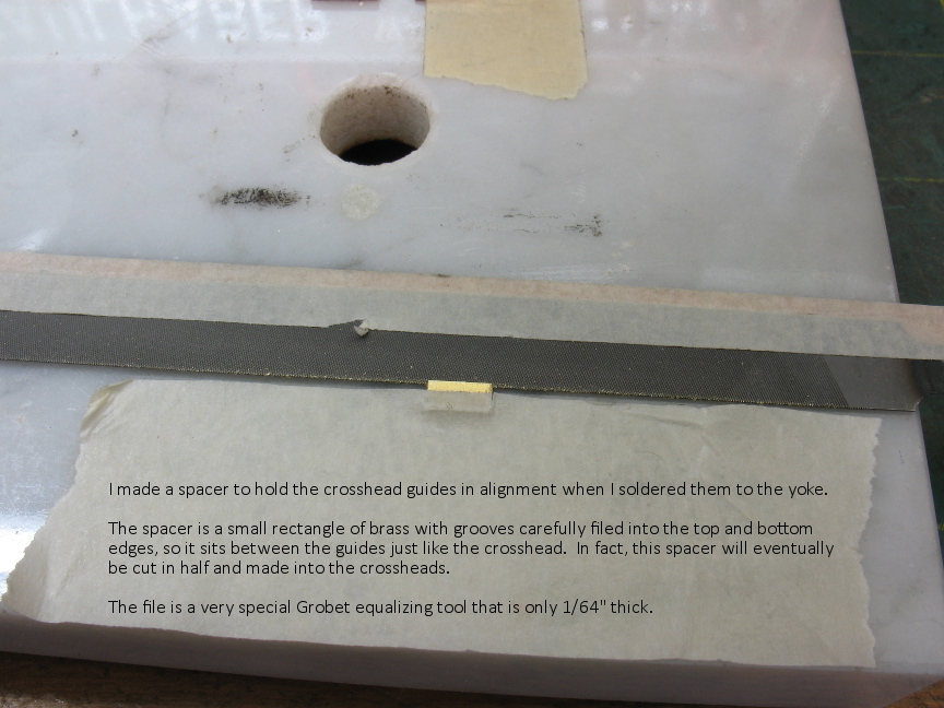

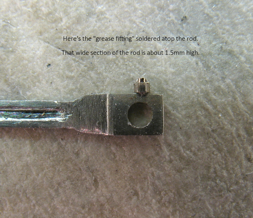

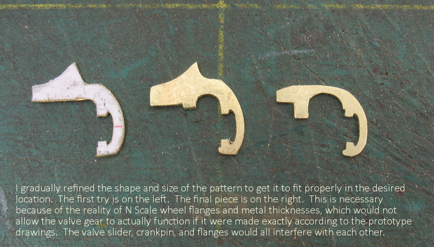

« Reply #224 on: April 19, 2017, 12:46:13 AM »

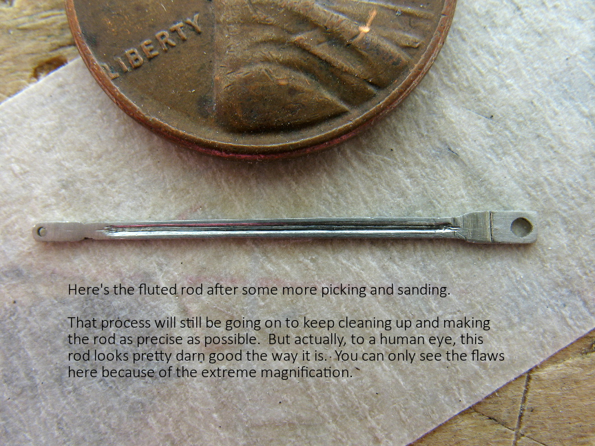

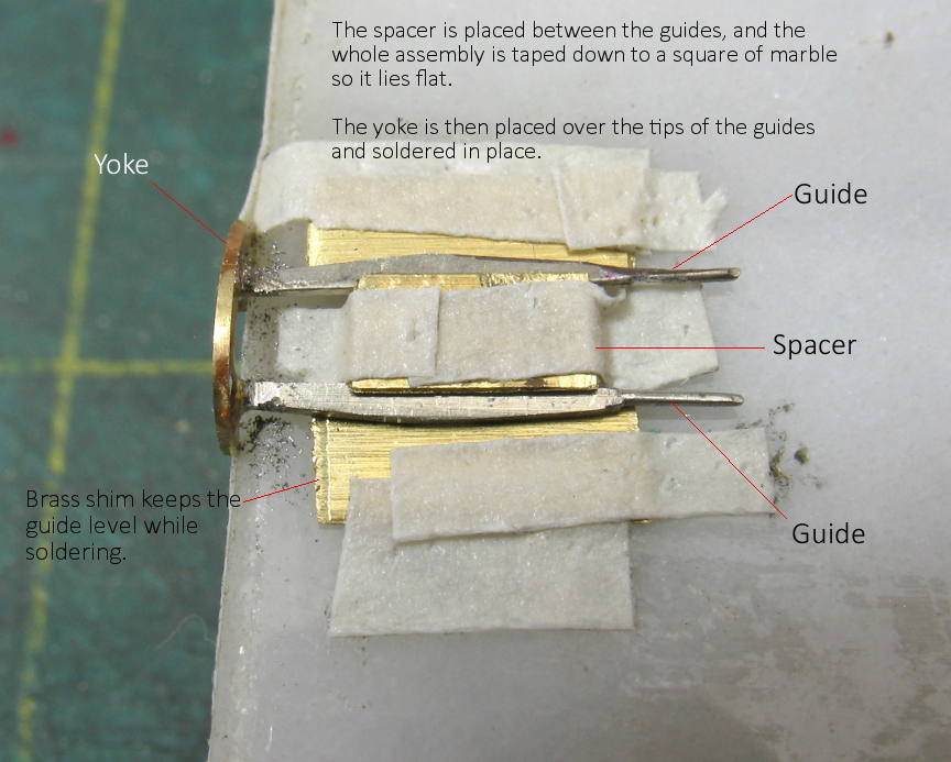

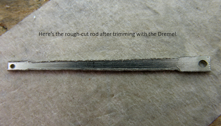

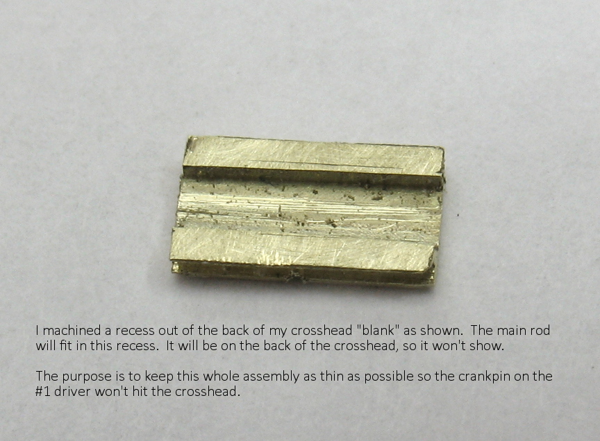

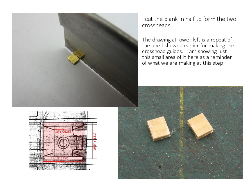

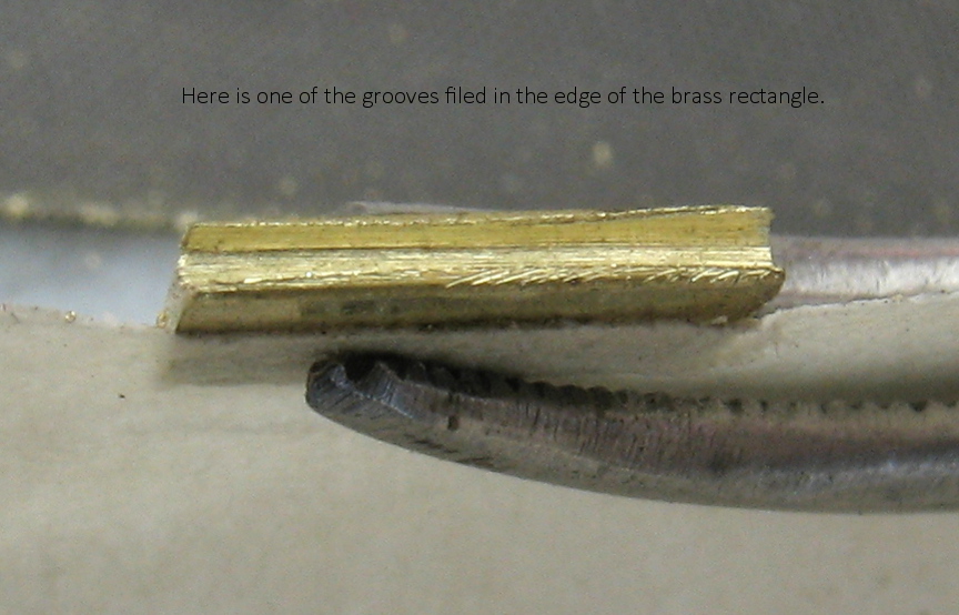

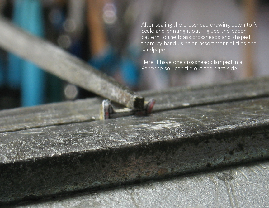

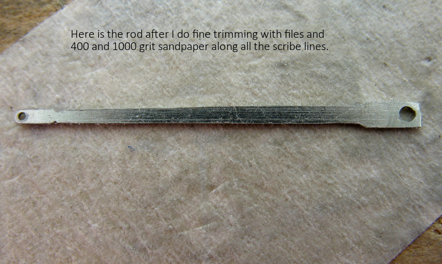

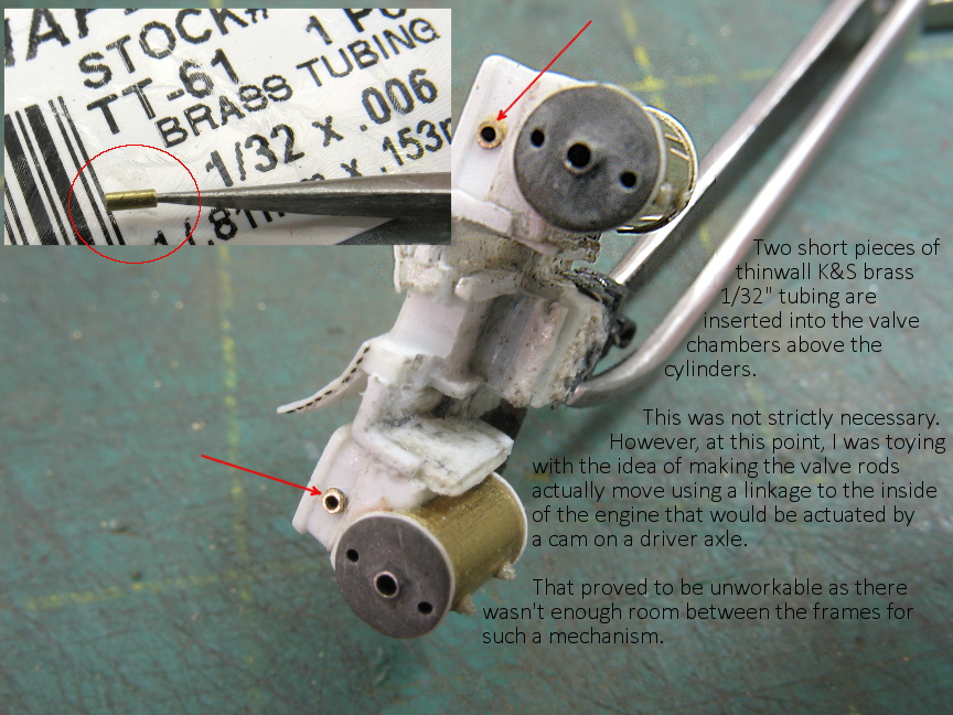

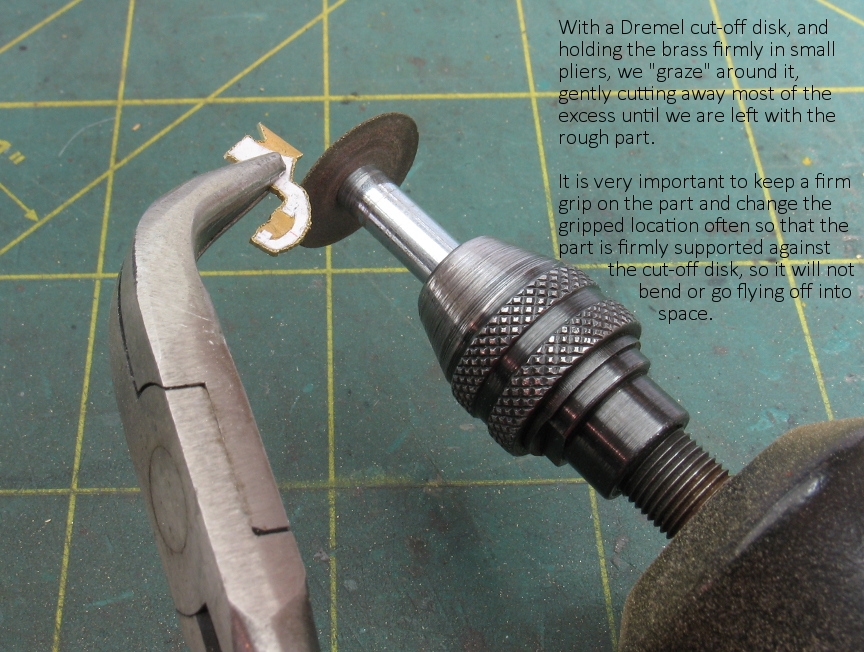

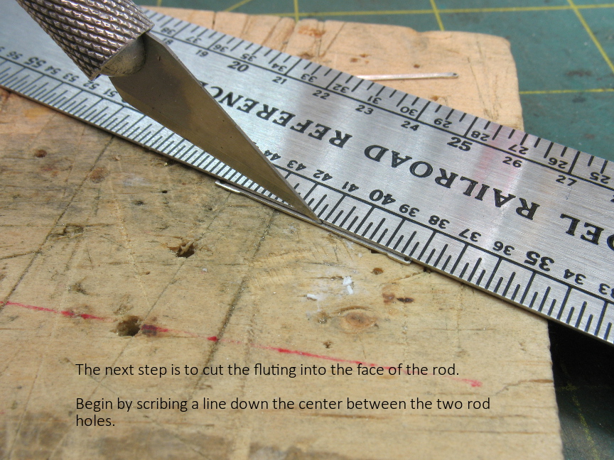

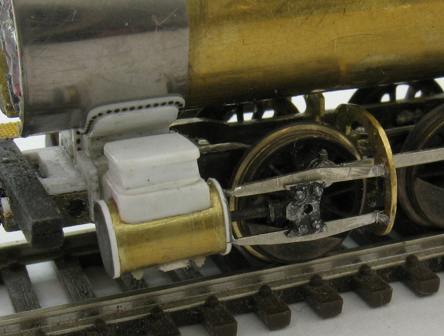

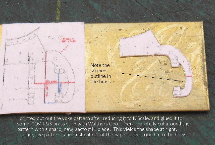

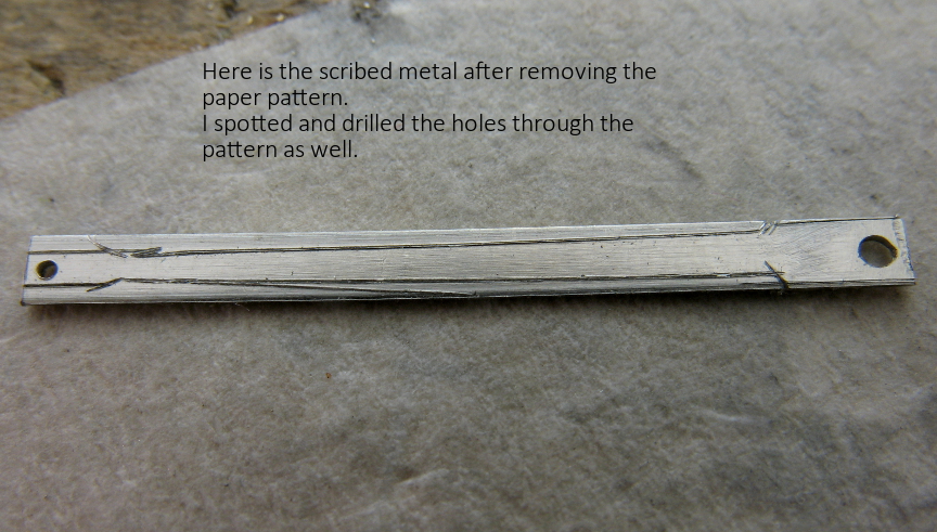

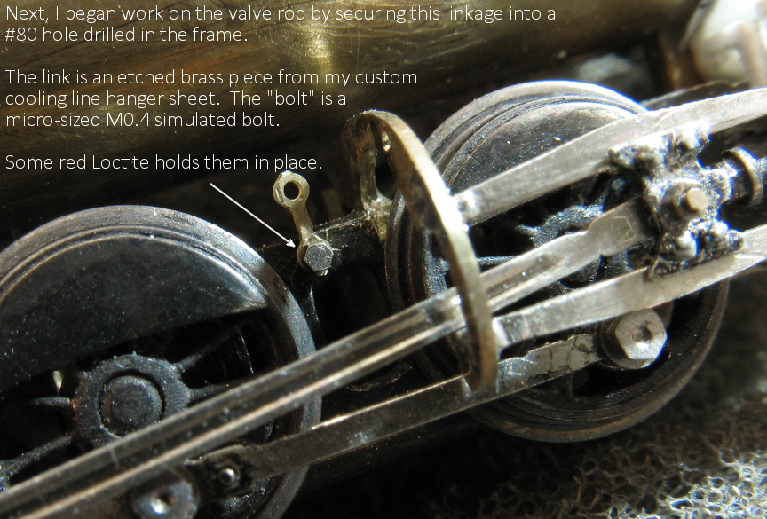

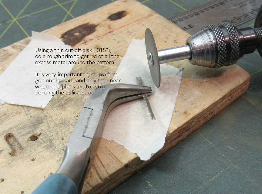

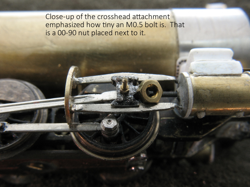

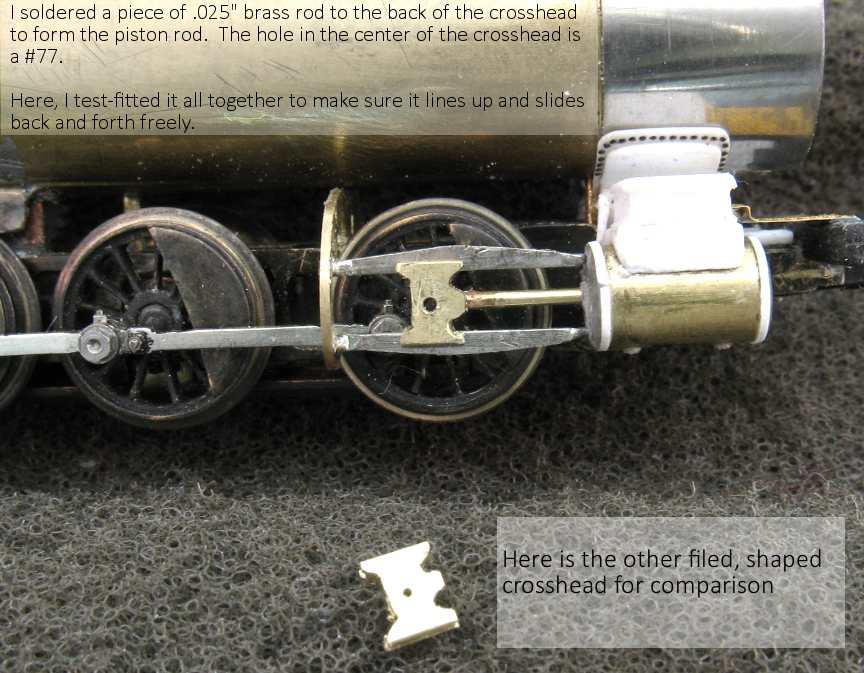

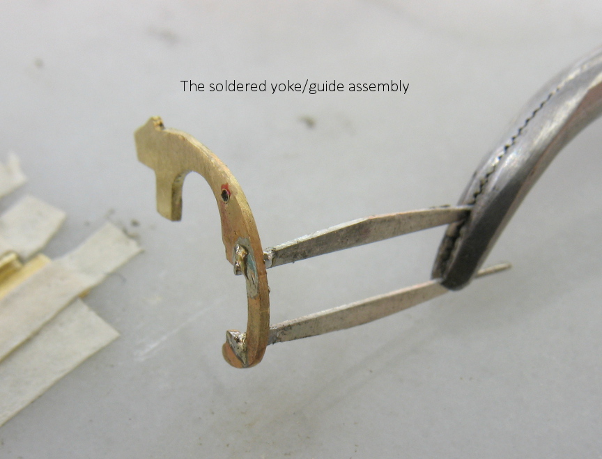

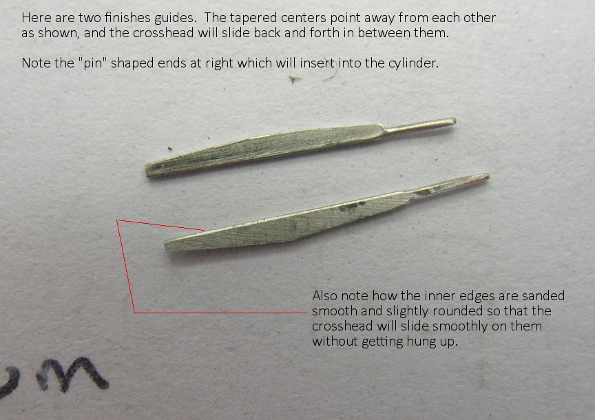

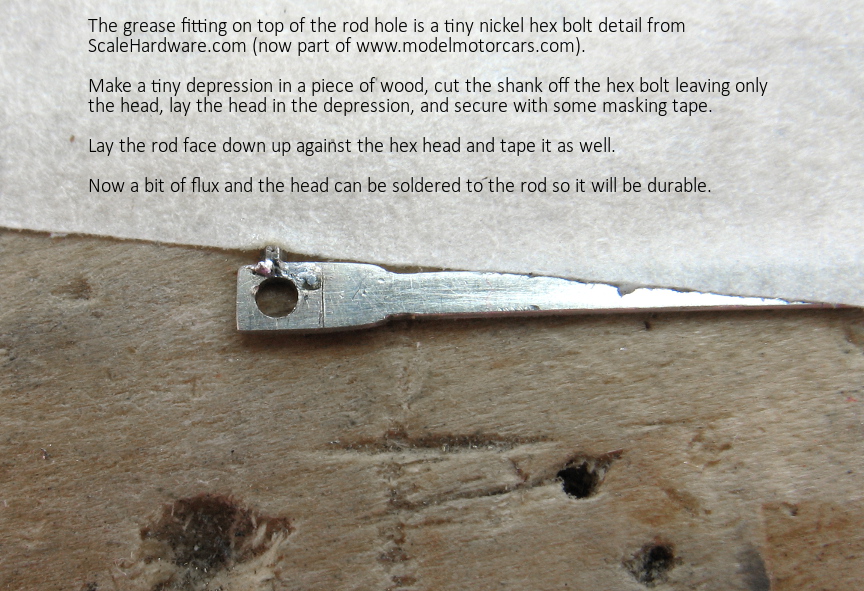

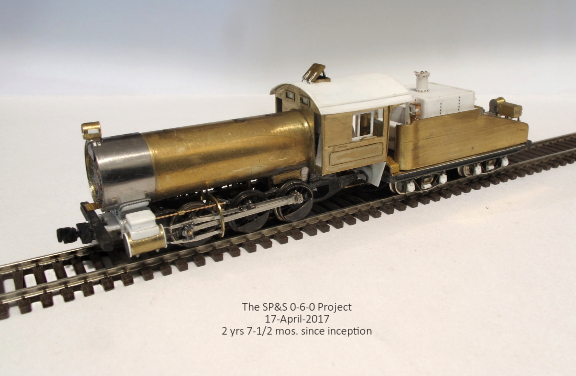

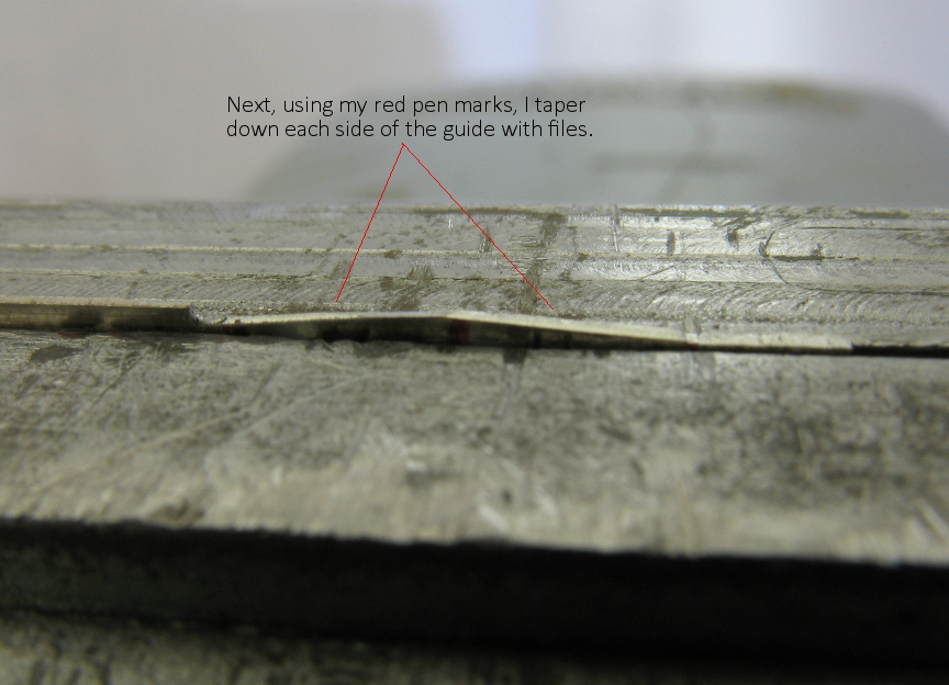

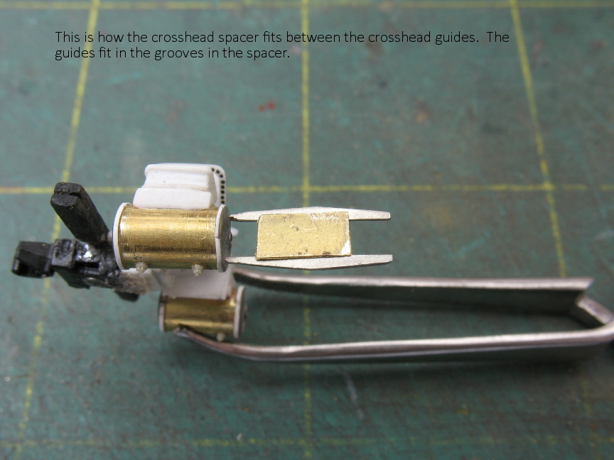

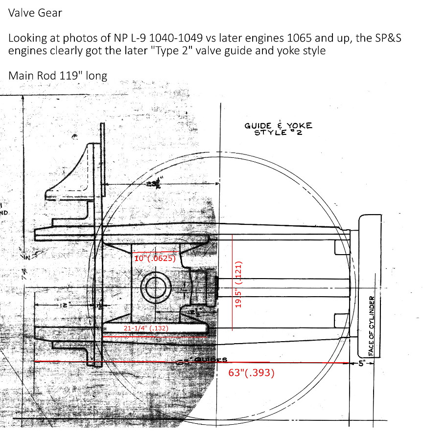

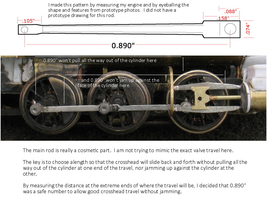

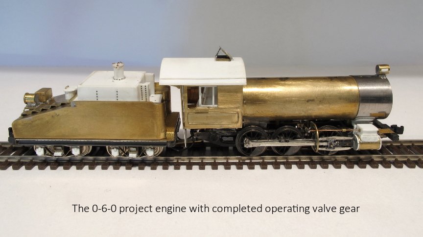

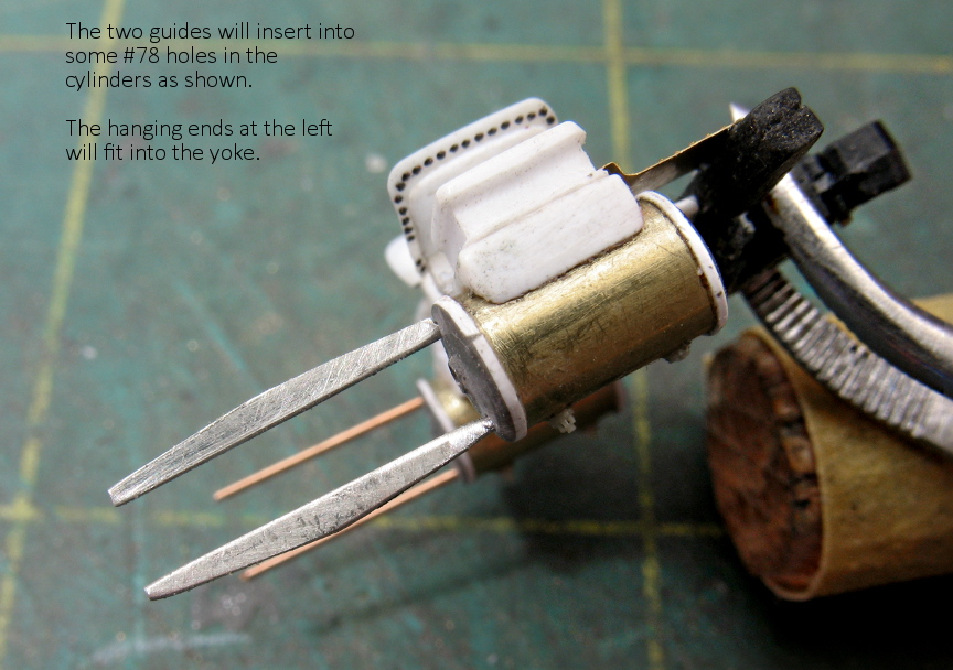

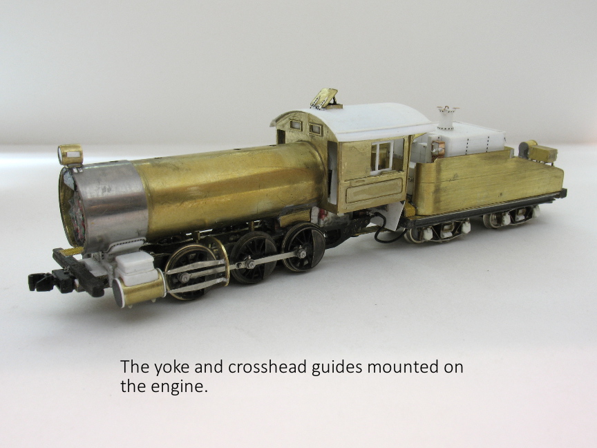

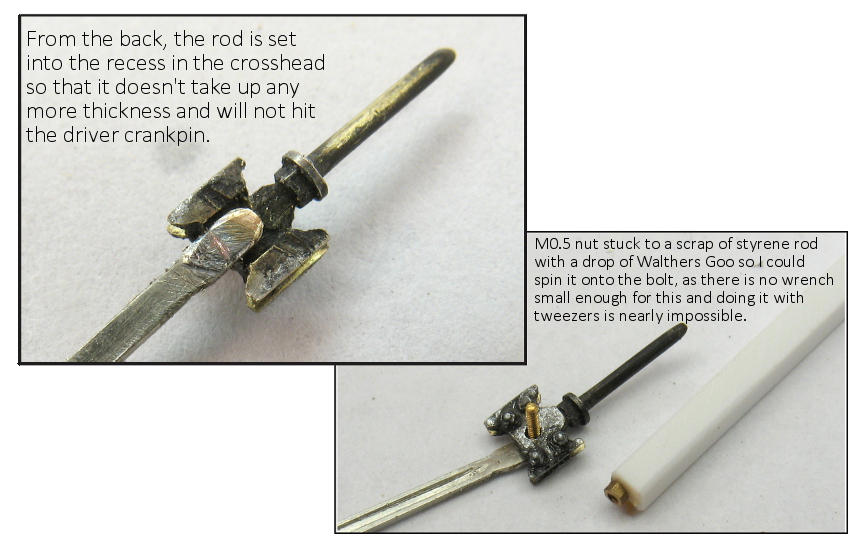

Hello again, everyone.  It's time for the next update on my 0-6-0 steam locomotive project.
The topic this  time is... valve gear.
In a word, making working, sliding, good-looking valve gear from scratch is, well, difficult.  But at long last,
it is done.
Here we go!

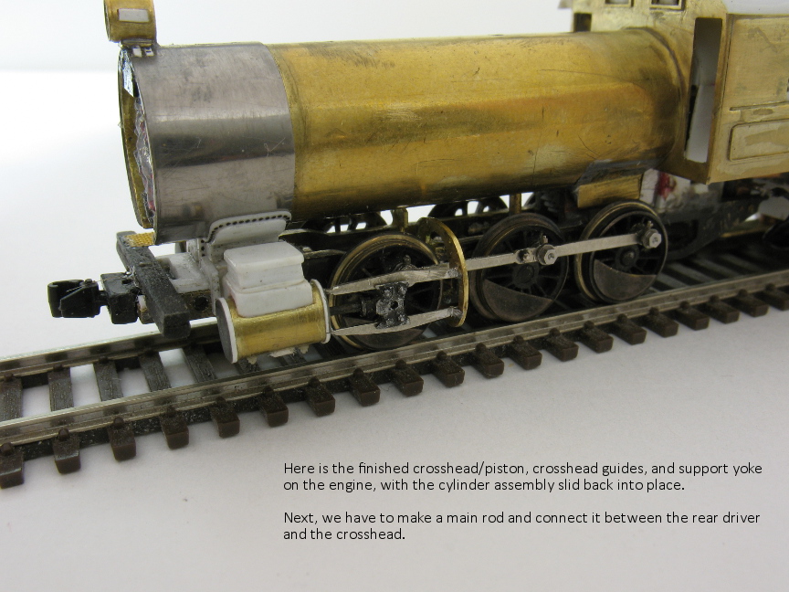

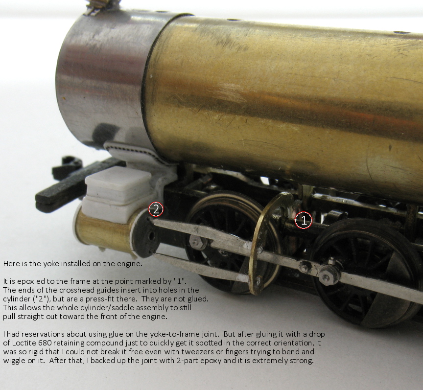

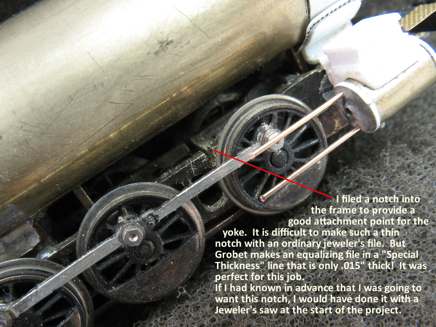

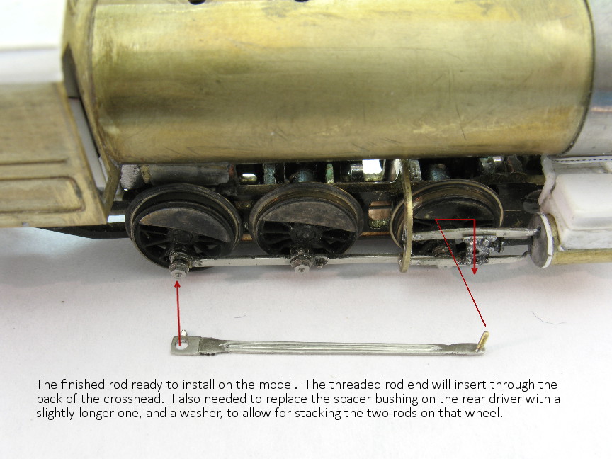

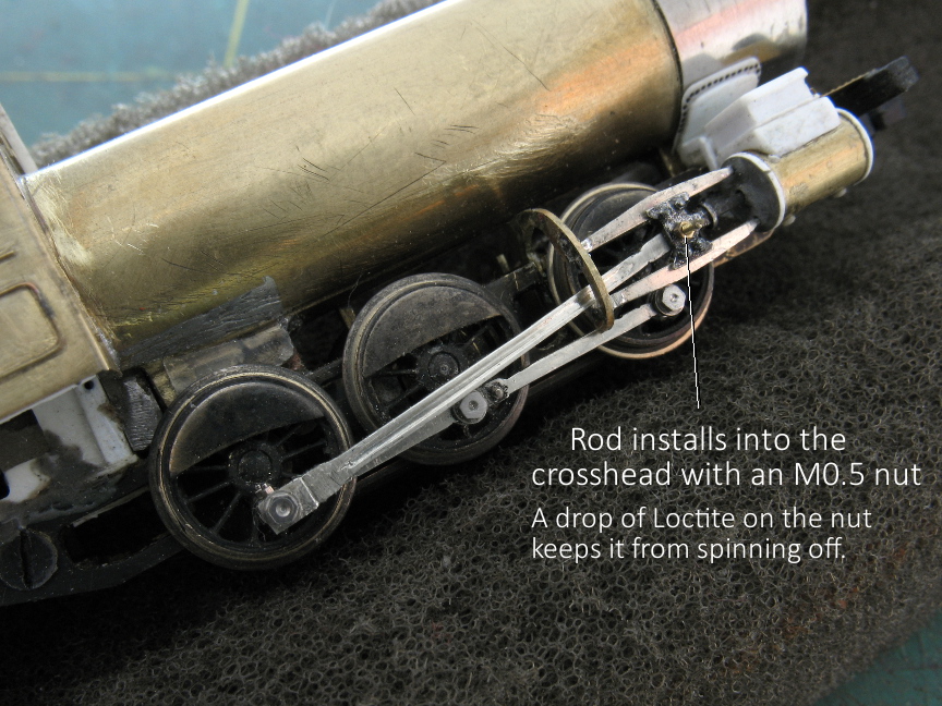

And by the way, yes, I realize that in this photo, the two yokes have slightly different shapes along the top.  I still had to do some filing and reshaping on that top edge to get them to slip correctly in under the boiler.  By the time I got them installed, they were both the same.
This next photo is a larger size than my usual posted photos, so you can click it out of the forum browser and view  it in a separate window with more zoom if you care to.
