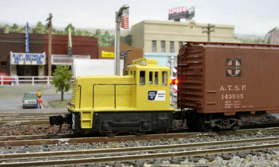

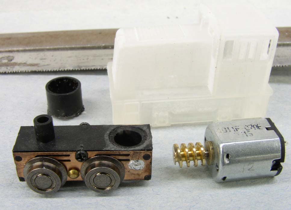

Did this as an experiment for a customer and it's worked a little better than I thought.
1)  Take one of the TU7T's chassis with the 3.5v pager motor, and replace it with a Kato 12V 11-105 motor (which is like several others now)
The Shapeways shell is made as a dummy, takes some modification and tinkering, but other than the coupler pockets, works even though the motor barely fits.   The real trick is filling every available spot with lead.
Customer wanted an Aarmco Steel color scheme, made the decals.  I have a video of this running but it will be a day or so before I process it.
This is intended as an operating, functional tiny switcher - not a novelty, so performance and tractive effort first.   Specific goals for number of cars, slow-speed, pickup, and delay uncoupling were met.
Randy have you found 12v version of that motor without using the Kato chassis?
