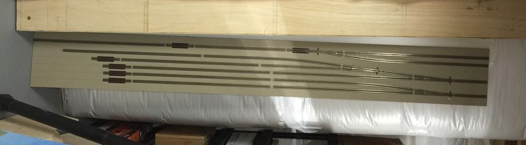

Here is one more part of the puzzle that I've been working on.  This is the other end of the staging tracks:  if the curved turnouts correspond to Mojave, then these would correspond to Bakersfield:
Right now this is just built onto a sheet of 12" x 96"  plywood, but I intend to install it as soon as the partition wall to support it is in place.   I originally designed this with hand-built #12 turnouts, but when I saw that the #10s were actually available I figure I would give them a try.  (Hopefully they will perform satisfactorily but if they turn out to be problematic then I *will* rip them out and put hand-built ones in their place.)  Note that in addition to the four staging tracks (which will run into the bottom of the helix), there is also a siding track for parking a track-cleaning train.  The topmost track (with the two re-railers) is going to be used as a decoder programming track and for speed-matching locos.
