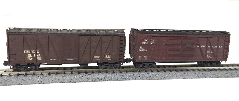

Finally got my "missing" Northwestern car, and now that I'm over my initial excitement of having the "war emergency" cars made in the first place, I see some of the shortcomings a bit more clearly. The grabs are godawful... :facepalm: Still, with a bit of work, these can be made to look very nice and fill a BIG void for us transition era guys, and they tell a story, one of wartime steel shortages, ingenuity, and hardships.
Here's a few shots of the C&NW car, as is, with the original roller skate trucks, and with replacement Fox Valley wheels....I do love the roof and mine came with a fine straight running board and brake wheel attached...

As to the ride height, the top of the car is right on, scaling off at just under 15' at the running board. That's accurate.
The challenge is the floor elevation, which should be at about 44". However, the MT coupler gauge puts the botom of the floor at close to 44 scale inches, 43.68" according to my caliper. That would result in the floor elevation to be just a tad too high, the thickness of the floor.... but of course we have this very same challenge with every car where the MT standard is used for body mount couplers. Truck mounted couplers are worse, to allow for swing clearance....

Well, a couple more shots, weathered and with the "roof handles" clipped. I'll replace those with wire, the rest of the car will have to do for now...
