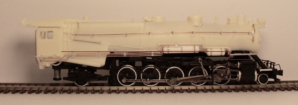

Here's one way I think the boiler height gives itself away.
If you look at the prototype photo posted by the OP, and follow the walkway along the side of the engine,
notice that it starts at about the same relative position on the cab as the model with the upgrade/urethane shell.
At the end, the prototype walkway takes a step down and lands almost slap on top of the cylinders.
Now, back to the model  shell, the walkway jogs up and down (and that's already a compromise we have discussed).
But ignore that and follow the line from the cab all the way to the cylinders, and you can
see that even with the jog downward in the walkway at the front end, it still sits quite a bit above the cylinders.
It should be more like the red line in the photo below:
EDIT 2:
Another place to look is at the lower edge of the firebox.  Notice how low it sits relative to the
trailing truck and the rear driver on the prototype photo as compared to the model.
nscaleSPF2:
I really hope you take all this discussion and helpful (I hope) critique in the sprit in which it is intended.
I am looking at this from a perspective of thinking about what relatively minor and achievable things
you could do to make this a better model, given that shell and that mechanism.  It seems to me
that altering the walkways to match the N2, and lowering the shell a little might take some work, but
they are not horrible tasks that involve messing with the mechanism or putting the engine at risk.
So to me, it seems like it would be worth it to make those changes because I think they would
go a long way toward making this look like a proper N2.

nscaleSPF2
  • Posts: 383
  • knowwhatimean?
  • Respect: +103
Re: PRR N2 Steam Locomotive Build
« Reply #25 on: August 23, 2015, 08:48:20 AM »
Enough, already.  You guys are over-thinking this.  And you are certainly not hurting my feelings.
The engine is going to get painted as-is, and then we will take another reading.  Unlike the real world, anything that gets done here can be undone.  After all, it's only a toy train.   ;)
