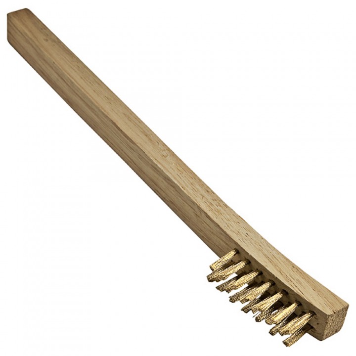

One of those furniture refinishing brass brushes does a good job. (They look like a slightly oversized
toothbrush with a wooden handle and brass bristles... like this:
But in the end, it doesn't clean out all the solder and I usually end up using the Xacto blade method
to finish up.

The brush Max shows is exactly what I use. But I prefer stainless steel bristles - stiffer than brass.
