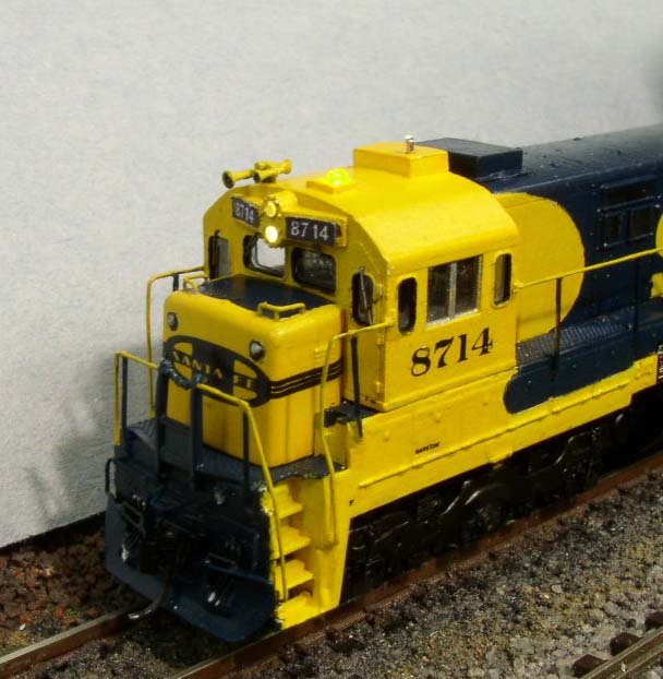

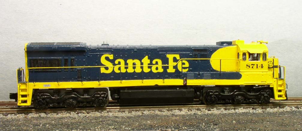

Back in March of 2010, Scott ran a nice article in RMC on kitbashing a U36C from a Kato C30-7 and a U30C shell.
I had a U36C I'd bashed several years ago from a Trix U28CG, which is really sort of a Phase 1 U30, and frankly, not that far off.   I extended the radiator wings with styrene on that one.  Looked a little odd from the top.  And the detail on that was a little rough.
The deliveries of GE U36C's started in 1972 - that's the year I model.   They were the 'cover girl' on the 1972 Annual Report, with #8706 on the point of the Sea-Land train over Cajon.  If there's such as thing as a 'cover girl' on my layout, the U36C is it.  That dates the railroad, and is the slickest, newest, and most modern power I have.
So here's mine - with thanks to Scott for giving me a plan, and a better way to do this.  Basically, you're taking the entire radiator section and rear end off the C30 and grafting in onto the rest of the shell from the U30.
I took it up a notch on what I could do - replacing all the plastic handrails and grabs with real wire, adding GMM details, and putting in one of my favorite features - a Stratoliite flasher and constant lighting unit from Richmond Controls.  Unlike my first attempt, these LED's are scale-sized.  I pretty much threw the book at this one - everything I know how to do.  Z couplers, and another salute to the number board technique that John Sing developed.
About the only glitch was the additional battery box on the fireman side, I added that from an old Trix shell.   I'm sure there's louvers and latches that might be wrong, but on a dark blue body that's darn hard to spot.  And this is one of two units on the layout that have zero, none, no weathering and finished in semigloss - as in 'just delivered' condition.   The other is my SD45-2.
The sunshade, cut lever, and MU cables are etched brass of my own design that I supply with my CF7 kits.  The window is open for the addition of an engineer.
And here's one with the flasher running and the headlight on.
Decals are Microscale, by the way.  The builders plates came from the really old 1972 set that had those on it.

Randy,
Did you use a Kato U30C?
If so, how did you do the handrails since the way the handrail piece holds the walkway piece, I would think that would be really hard.
And maybe even unsteady.

Randy,
Yes, that's 90% of it.  I glue up everything on the walkways with ACC and cut all the handrails off.  I'll paint and decal anything that would end up behind the final handrails, so most of all that is done on what looks like a finished shell.   Assembling them on the shell, rather than on the workbench, is the trick I learned from Tom Hoover.
Drill horizontally .020 for the stanchion wires.  I fabricate the horizontal handrail wires out of .010 wire first, then add the .015 soldered stanchions starting from the center, dividing each area in half.  ACC into the walkways ("L" shaped at the bottom, not straight in)  That really helps keep everything straight.   I don't cut the stanchion wire to final length until later.   I can tweak any adjustments and resolder if necessary; then trim the stanchion wires to final length.   Final step is to grind off any excess length and solder with the edge of an abrasive disk in the Dremel.
Same process as on the RSD15's that John Sing posted - just did those two at the same time I did this one.
The wire handrails are really, really solid and hold paint with no issues, and can take a hit and easily rebend.   I have approximately 40 units I've done this to plus another 40 or so that I've done as custom work for others.   As they go on AFTER a shell is painted, it's entirely possible to do this on a previously-painted shell.   What's impossible is doing fine painting or decaling around them after they are on.
