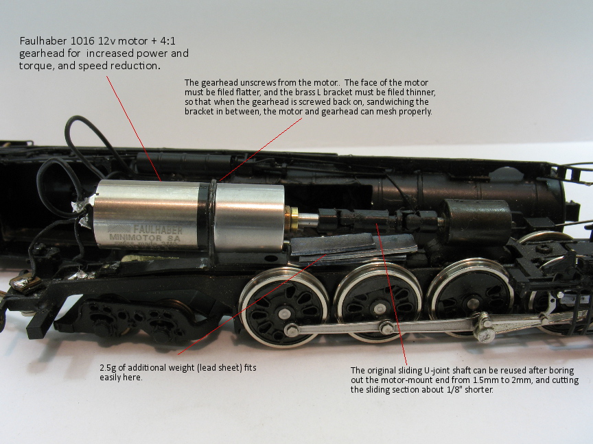

Here's a coreless motor/gearhead upgrade in the Hallmark 4-8-4.  You don't need the smaller 8mm gearhead.
There is plenty of room to use 10mm all the way through.
That's a Faulhaber 1016 + 4:1 gearhead.  Diameter is 10mm.  Total length is 16+7 = 23mm.
As you can see, if you are crafty, you can unscrew the gearhead from the motor and then screw them
back together with the original motor mount bracket sandwiched in between.   This is not always trivial.
The Faulhabers do have a plastic front plate on them, so that with care, you can flat-file some of that away to
make up for the .020" or so thickness of the mounting bracket.  But be careful.  If you file away too much of that
plastic housing front, you compromise the structure of the coreless motor and it won't run because
the "basket" (a.k.a. armature) will move ever so slightly, just enough to hit the housing on the inside.
These things are made to incredibly tight tolerances, so if that basket or the shaft bearings are upset the least
little bit, the motor won't run.
Anyway... it works great.
Top speed of the stock Hallmark engine at 12v clocked at 167 scale mph.  The gear-reduced top
speed clocked at 39 mph.  If you want more speed, you can use a 6v Faulhaber and overdrive it to 12v.  You'll get closer
to a top speed of 70 mph that way, and these motors are tough.  Check the current draw, and as long as you are not getting close to their maximum rated current, they will be fine.
