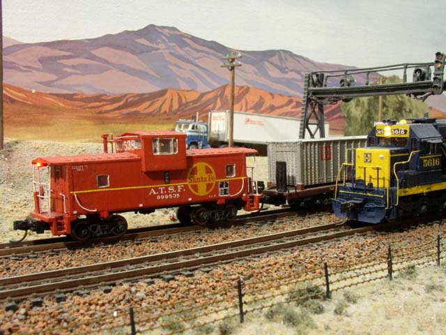

1)  Did a full rebuild on a BACHMANN (not Atlas) extended vision caboose, which is shorter than the Atlas and closer to the 538-class Ce-8's.  I put the Richmond Controls lighting package in it (DC)  that does one interior light LED and one end red marker up under the roof edge where it belongs.     I replaced the Bachmann trucks with MT roller-bearing, and then put the Richmond Controls supplied metal wheels and axle wipers in it to power it.   Works great.   http://www.randgust.com/999538%20caboose%202.jpg

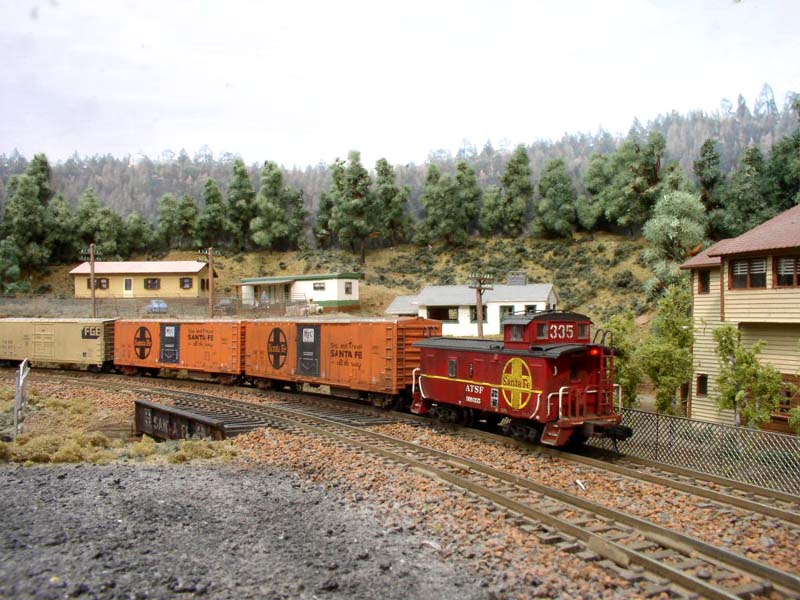

2)  Did several Intermountain caboose rebuilds with Kato caboose frames, basically splicing the bolster areas around the Intermountain center frame so that I had end-axle pickups and wipers (and 8x8 pickup instead of 8x4 with axle wipers).   Lot of work that you couldn't see.   Same lighting package, same great results:  http://www.randgust.com/999335_flagstaff.jpg

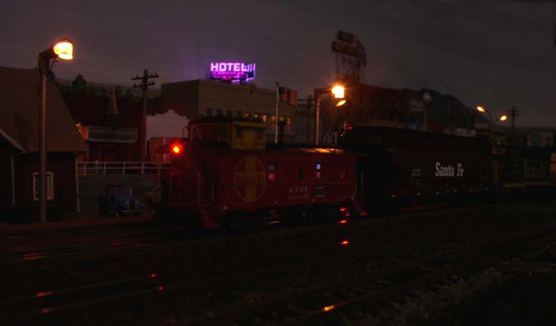

4)  Pretty much same as #2, only for a local Ce-3 caboose that runs both ways, I wanted two marker lights to work depending on direction of travel.  Jim custom-built the circuit for me, it's on a Kato frame as it runs through lots of grimy yard and industrial track.  http://www.randgust.com/99962108.jpg
Overall, I'm very happy with these lighting kits.   I'm evolving toward full night switching operations at least in the yard, and it's really, really nice to make sure the tail end of the train is still with you.   And as you can see in the photos, they are visible, but I wouldn't call them laser-pointer bright at all, and the interior is anything but too bright.   May be DC as I'm running things no move than 5v most of the time.
