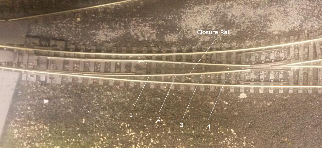

Pardon me whilst I steal your photo and annotate!  Perhaps this photo, and some more
detail, can help get to the bottom of this.
So in the photo below, the engine is backing through the turnout, from left to right?
And the wheels progress along the indicated "Closure Rail", following along the noted
locations 1, 2, 3, 4 ?  Is that right?  And about where (say, between 2 and 3? ) does the wheel climb up
and over the rail?
Perhaps the wheel starts to lift just as it rolls from the point rail onto the closure rail (at the hinge joint?)
This is indeed amazing and perplexing.
and over the rail?
From left to right. And between 2 & 3 is about correct. I seriously think there is not enough downwards pressure from the springs onto the rear drivers. Maybe just a fraction more is required, but not enough to deprive the 3rd set of traction.

photos can have distortions so I am not stating this is "TRUTH"
just me looking things over.
I made a track gauge for the photo.
the rails on the left are wider than the rails on the right.
they get closer together starting between 1 and 2 and stay about that same gauge
for the rest of the way.
I am trying to figure out how the flanges get forced up.
if the gauge narrows there, it will force the wheel into the outside of the curve rail
a little after the narrowing...
victor

victor miranda
  • Posts: 1604
Re: Kato FEF and Peco code 80 - oh dear.
« Reply #36 on: February 04, 2015, 06:10:51 PM »
Hi bobthebear,
you have said you have checked it,  what I see does not look out of tolerances...
just maybe one side of the spec and then the other side of the spec.
perhaps where it changes causes the problem.
in any case, something is allowing the flange
to get enough traction to go up the side of the rail.
victor
