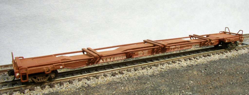

Finished up my converted Flexivan spine car to an ATSF Ft65 container flat yesterday.
These were Mark IV cars that were converted to conventional container service in 1972, with the removal of the turntables and a constructed rack systems for 20' and 40' containers.   N Scale Kits is a Mark II car, so this is a foobie for sure, but the rather distinct appearance of these cars in a 1970's Super C train transcends those details.   All the racks and braces are soldered brass.

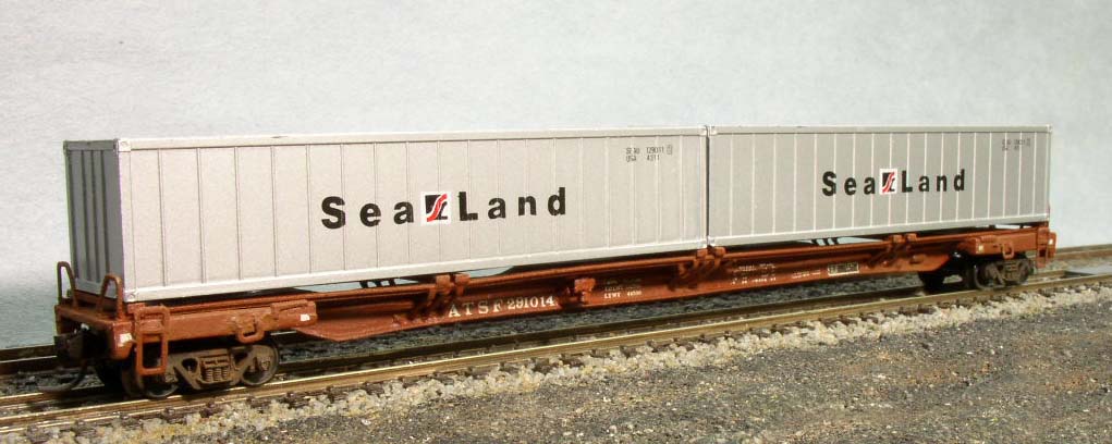

Loaded, the skeleton flat nature is the very distinctive appearance:
Here's a couple of them in the Super C, about 10 cars back, but still you can spot them in a photo:

Earlier I posted "Very nice", now I'll upgrade it to freakin' awesome! True example of a master is when the finished product doesn't show just how difficult is was to make. Outstanding work.
No kidding, +1

Good enough for me.   8)  I am curious though, if the car should have different trucks in the 1970s.

More than likely, yes, but if anybody has ever made Rockwell High-Speed trucks in N, I sure can't find them.   At some point they went to conventional roller-bearing trucks on the prototype, but likely after '72.
http://www.railcarphotos.com/PhotoDetails.php?PhotoID=47612
I'll likely change them out if they are ever produced, and if they actually work, simply because they are different just like the entire car was.     Because of the long bolster distance =  high truck twist, this car has a wide radius with body mounts and was a total failure until I went back to truck mounts - couldn't do 15" radius.    First couple of tests on the frame resulted in proving, once again, that pewter will distort if impacted to a concrete floor from 52" in the air.
UP had them on some cabooses, too.   But there appear to be incredibly rare, just never caught on.
I hadn't seen that one shot you posted of 291001, which is as late as I've seen one with Rockwells on it, and it's also interesting because the 'frames' are all bent-up.
