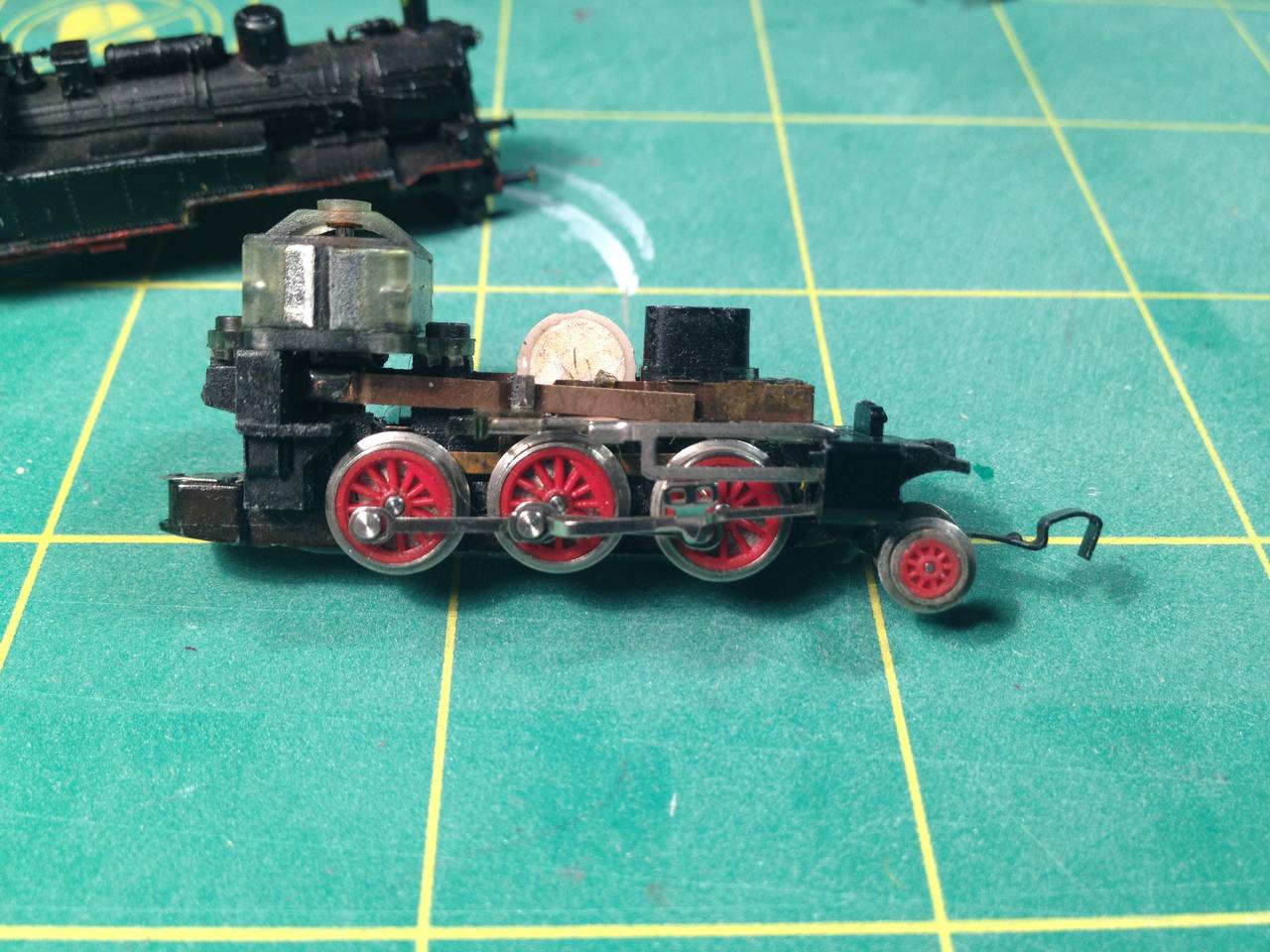

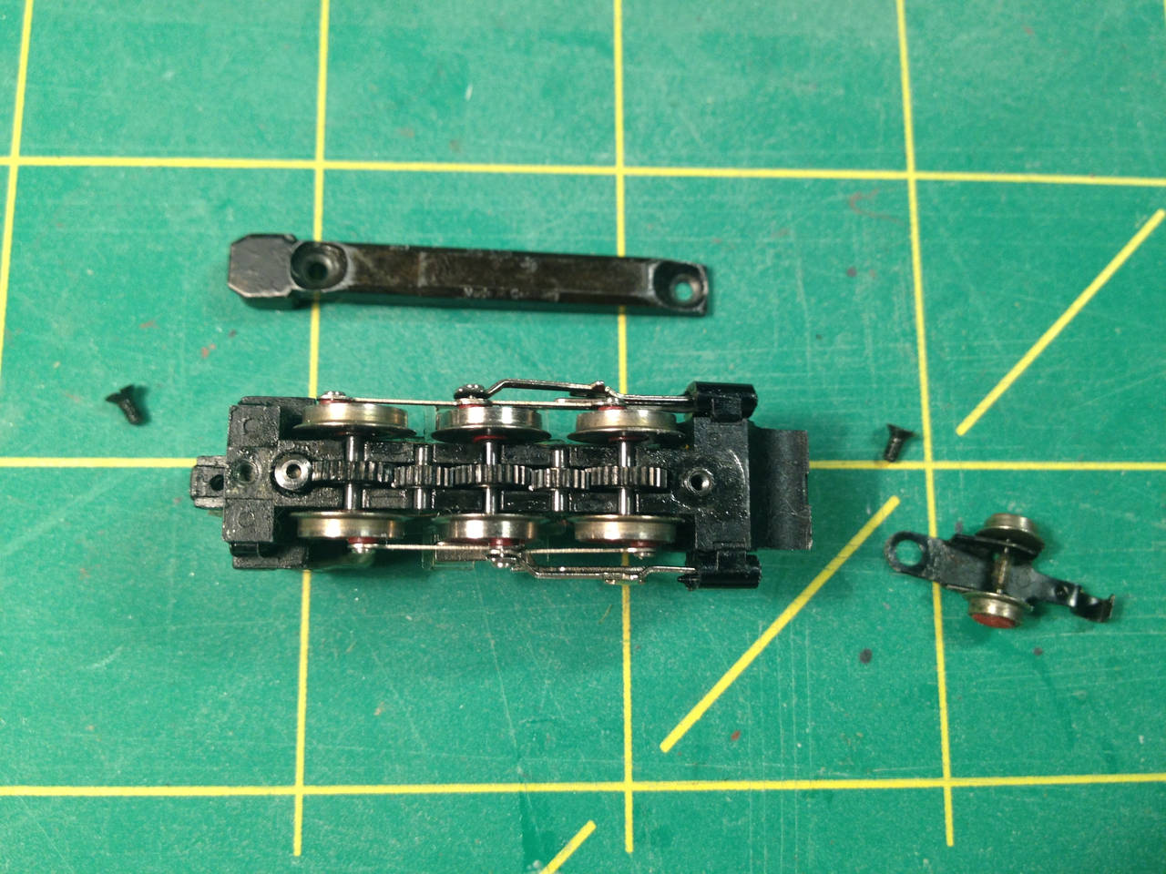

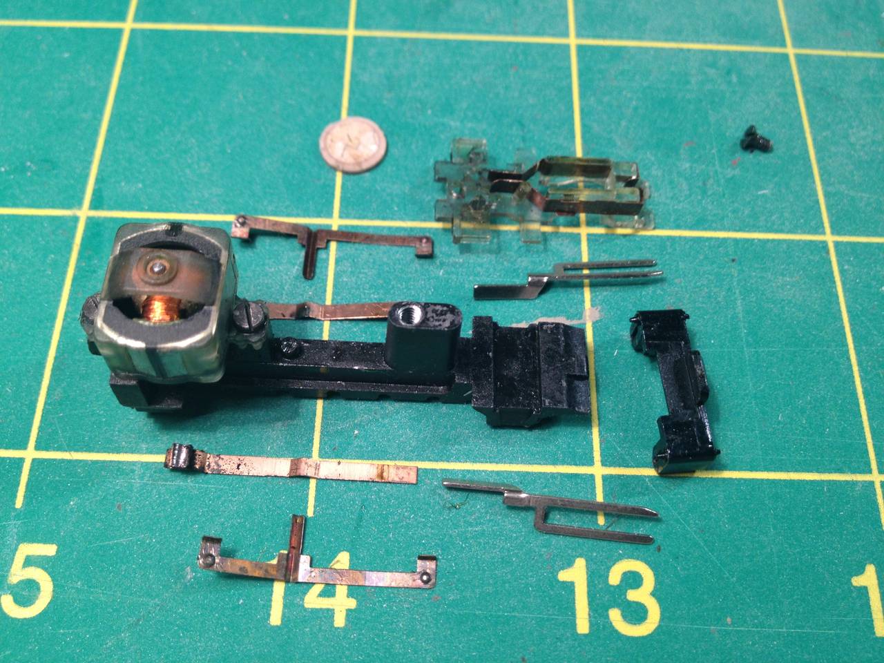

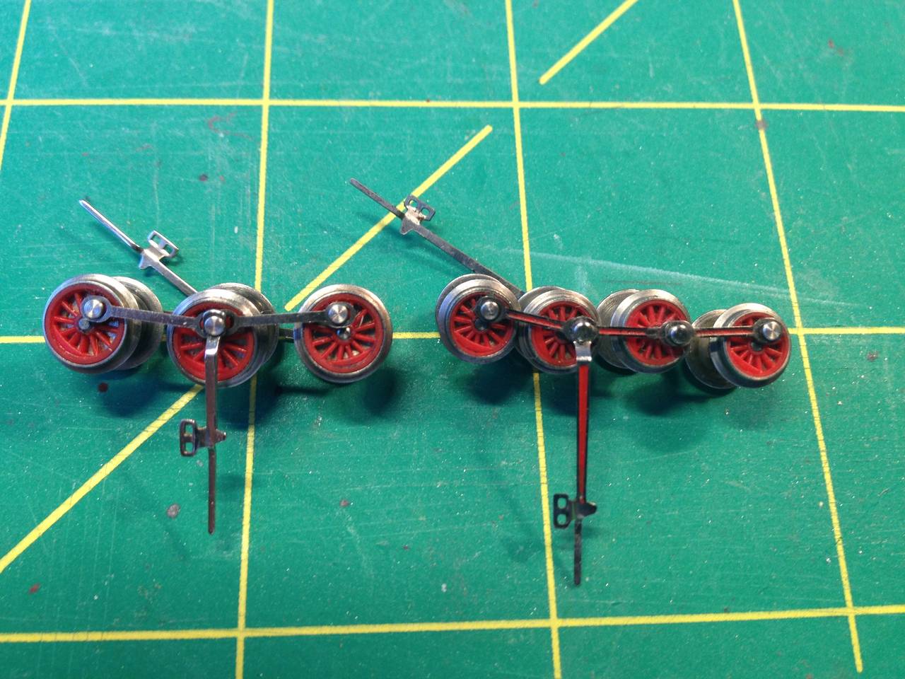

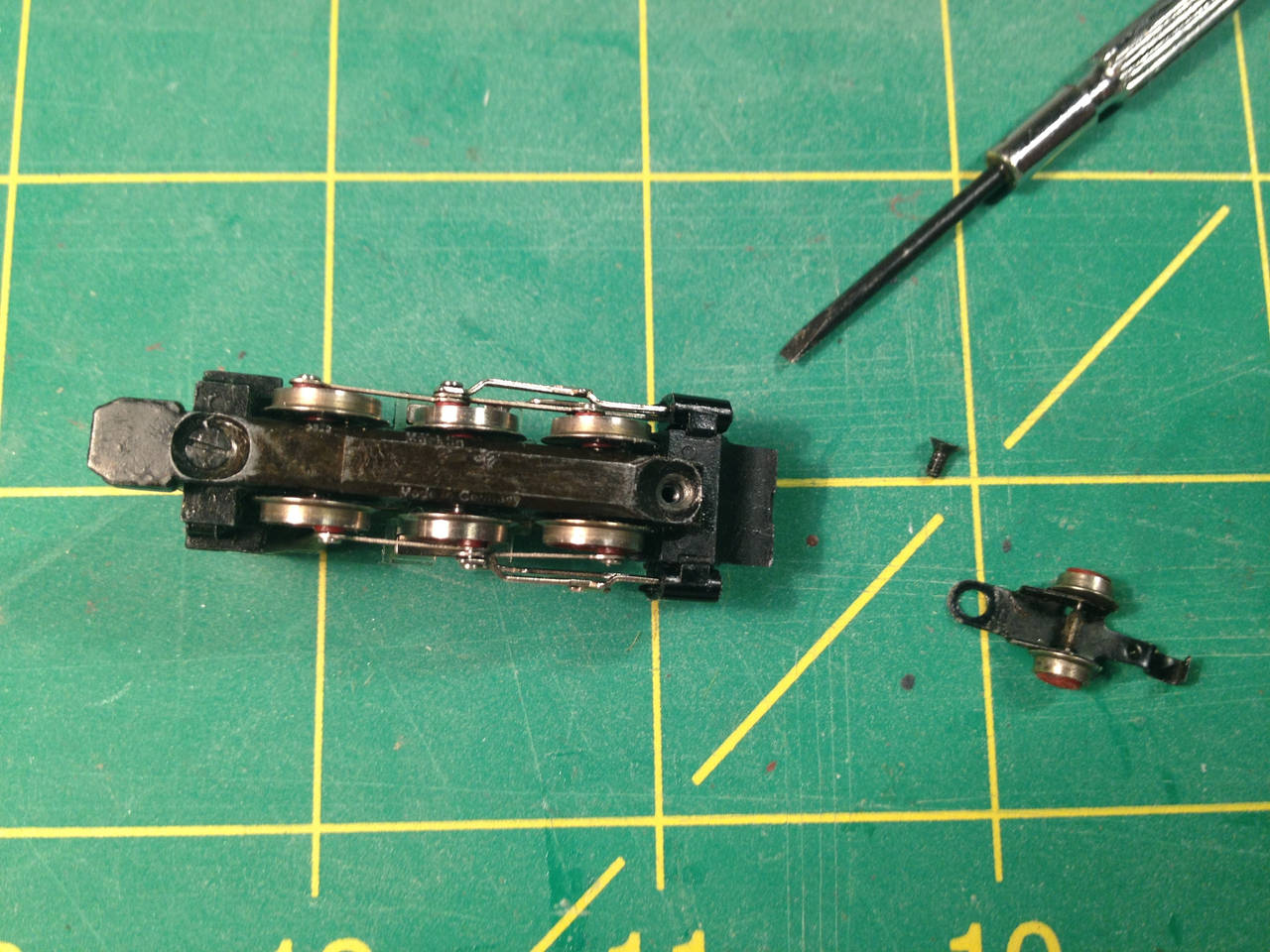

Many items that I had ordered arrived over the holidays and I had a chance to test run the Markin 8895 on a loop of Rokuhan Z scale track. My DC throttle is an MRC 1400 and it does not have PWM, which I've heard can improve the slow speed performance of the 3 pole motors. Since this is not a true Z scale throttle (with current limiting circuitry) I made sure to not exceed 8 volts during the testing. The locomotive runs good but I did see some jack rabbit starts and intermittent stutters during slow speeds. My next test will be done using a Z scale throttle with PWM to see if there's any noticeable improvement. Will try to post some video of the testing now that I've opened a Vimeo account.

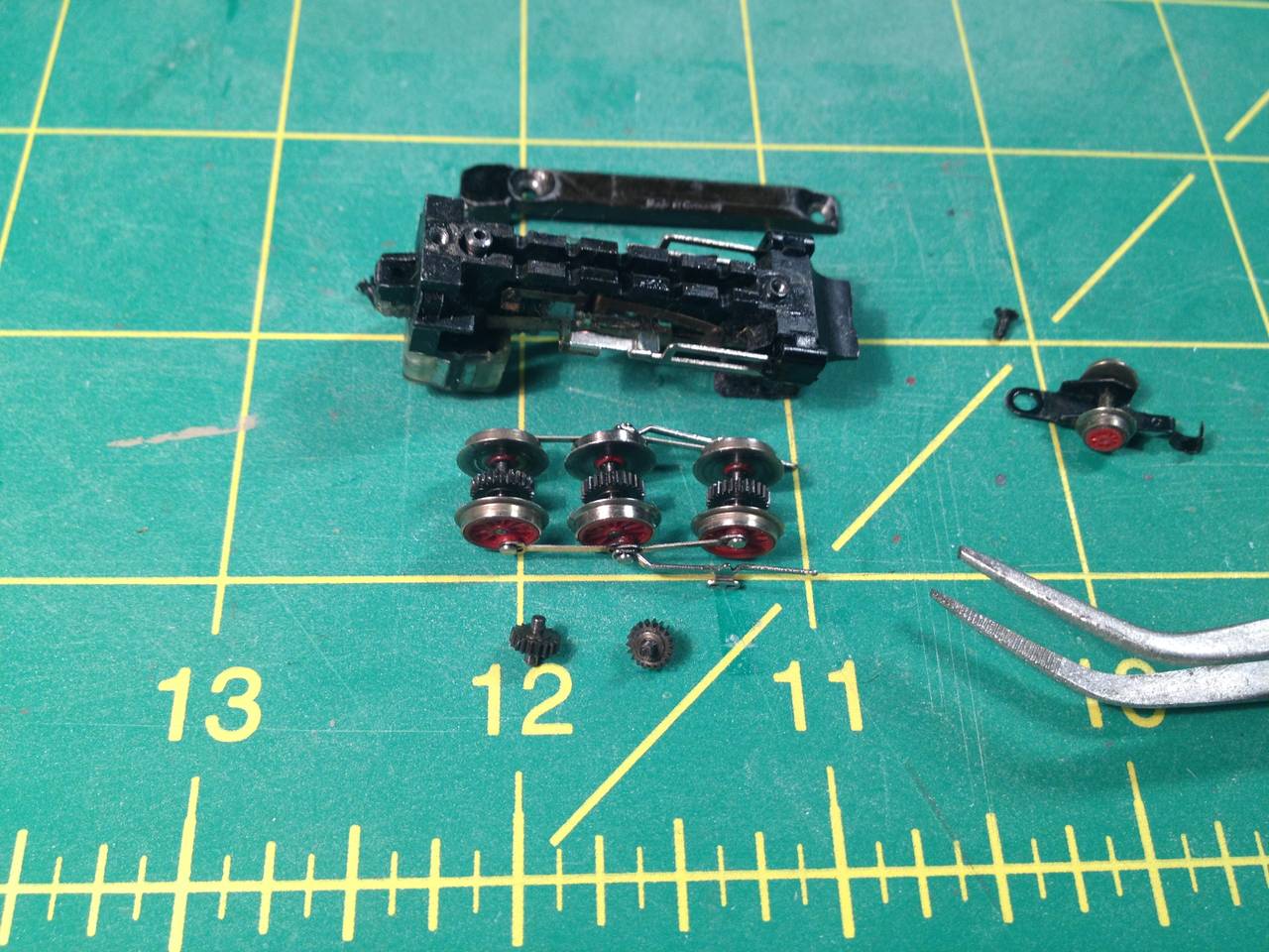

A second Marklin 8895 was acquired via Germany and the test runs were similar to the other loco. I decided to take it apart (and document my progress ) so I could practice getting the driver & rod assembly reinstalled correctly. Some cleaning of the chassis, motor brushes, wheel contacts & brush holders will be done as well as adding new lubricant before I try putting it back together.
Once I master the task of re-assembly then I'll feel confident in modifying the chassis (grinding/filing) to accommodate the RLW kit pilot & valve guide assembly. Still no luck on finding new longer main rods so I may have to cut the originals & solder in some brass strips to extend them. Will post another update once I get it cleaned, put back together and running again.

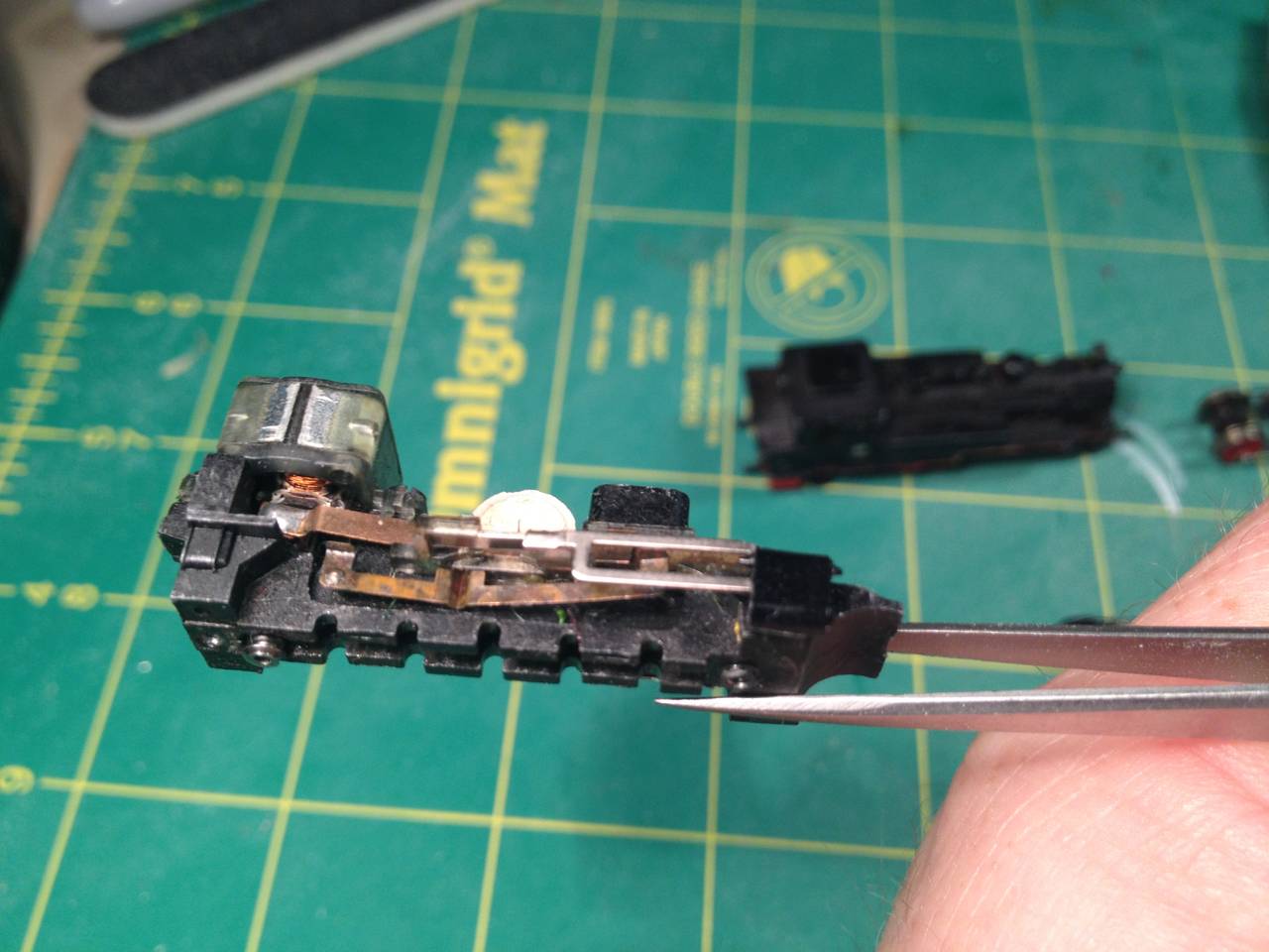

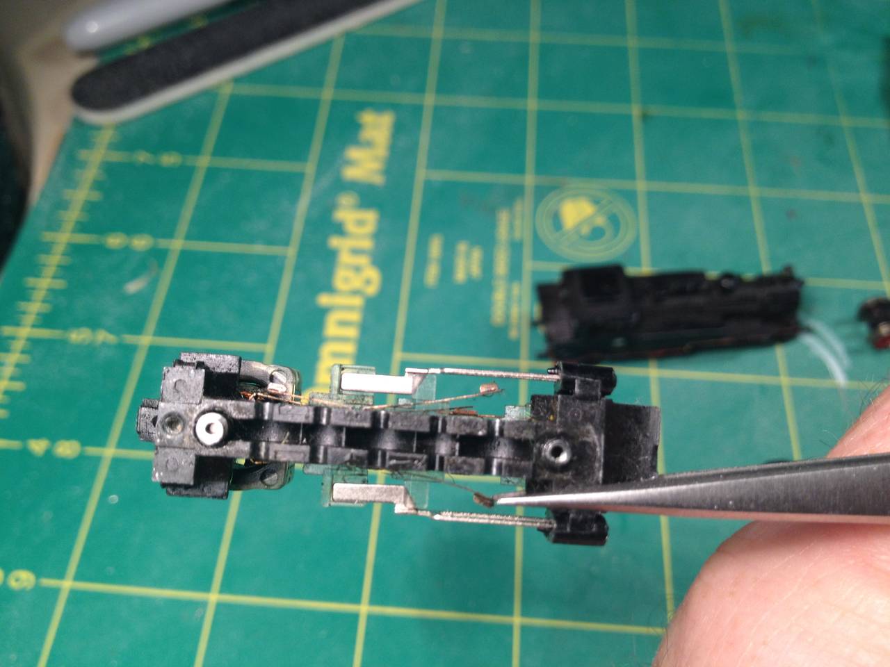

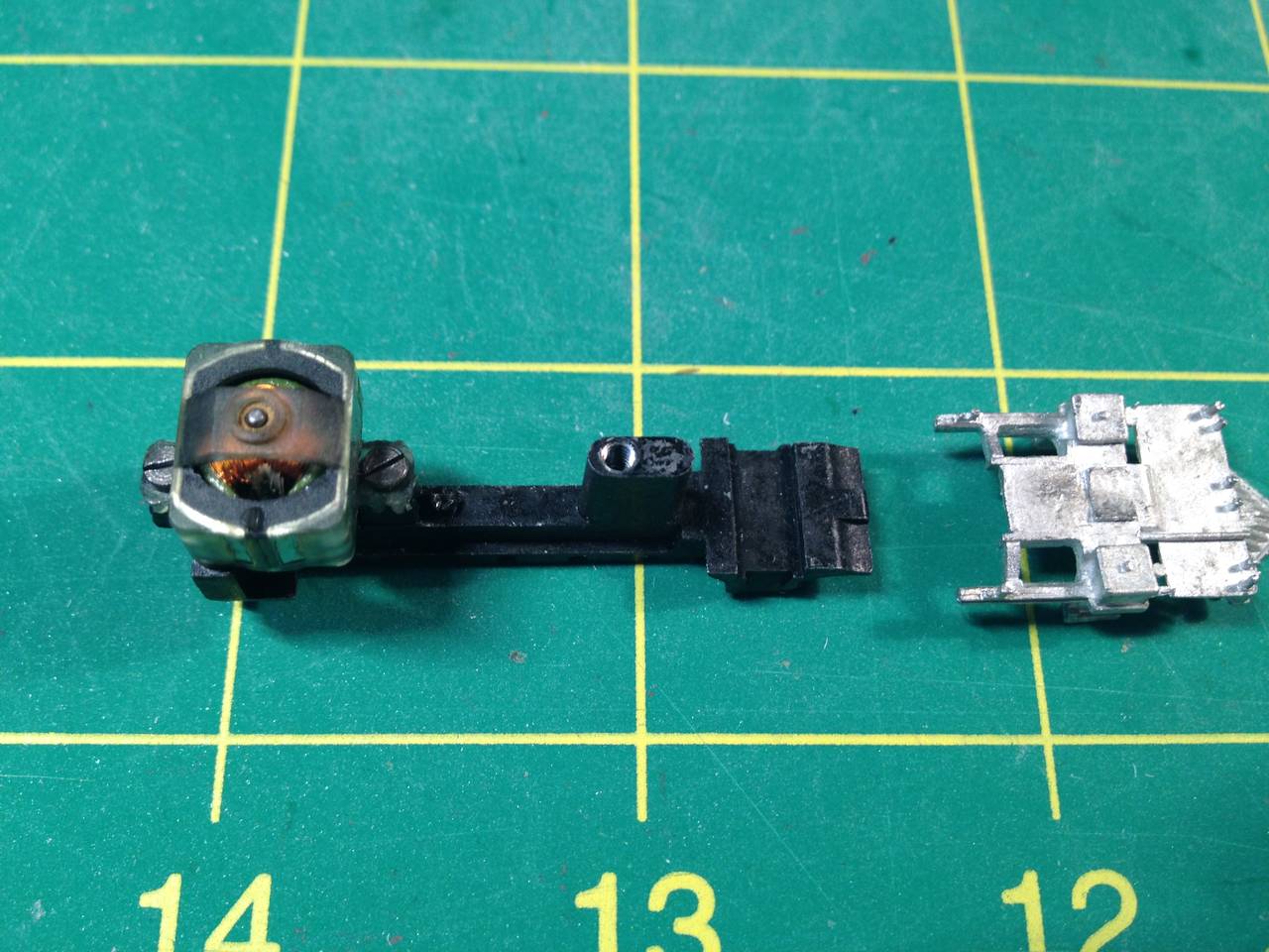

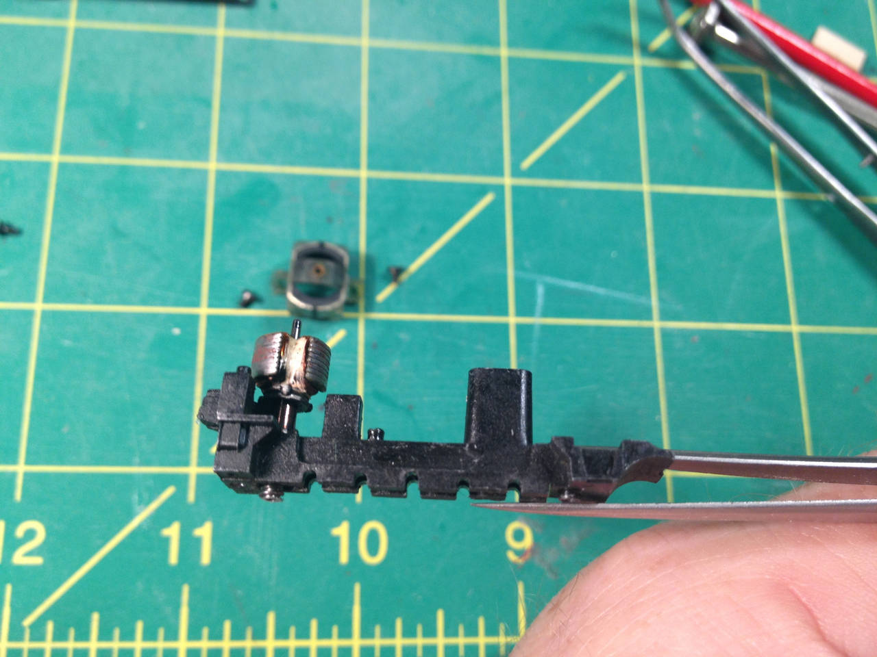

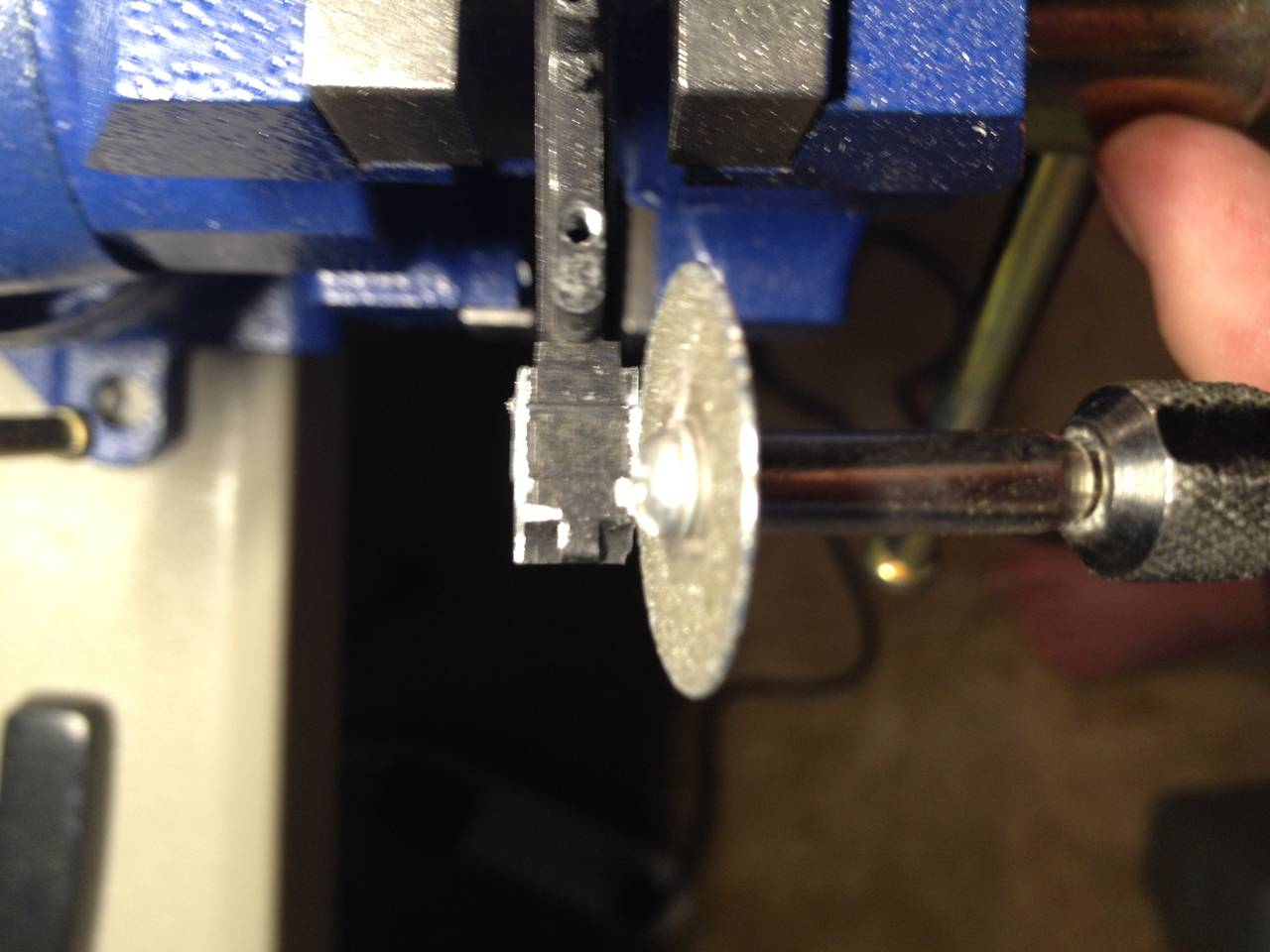

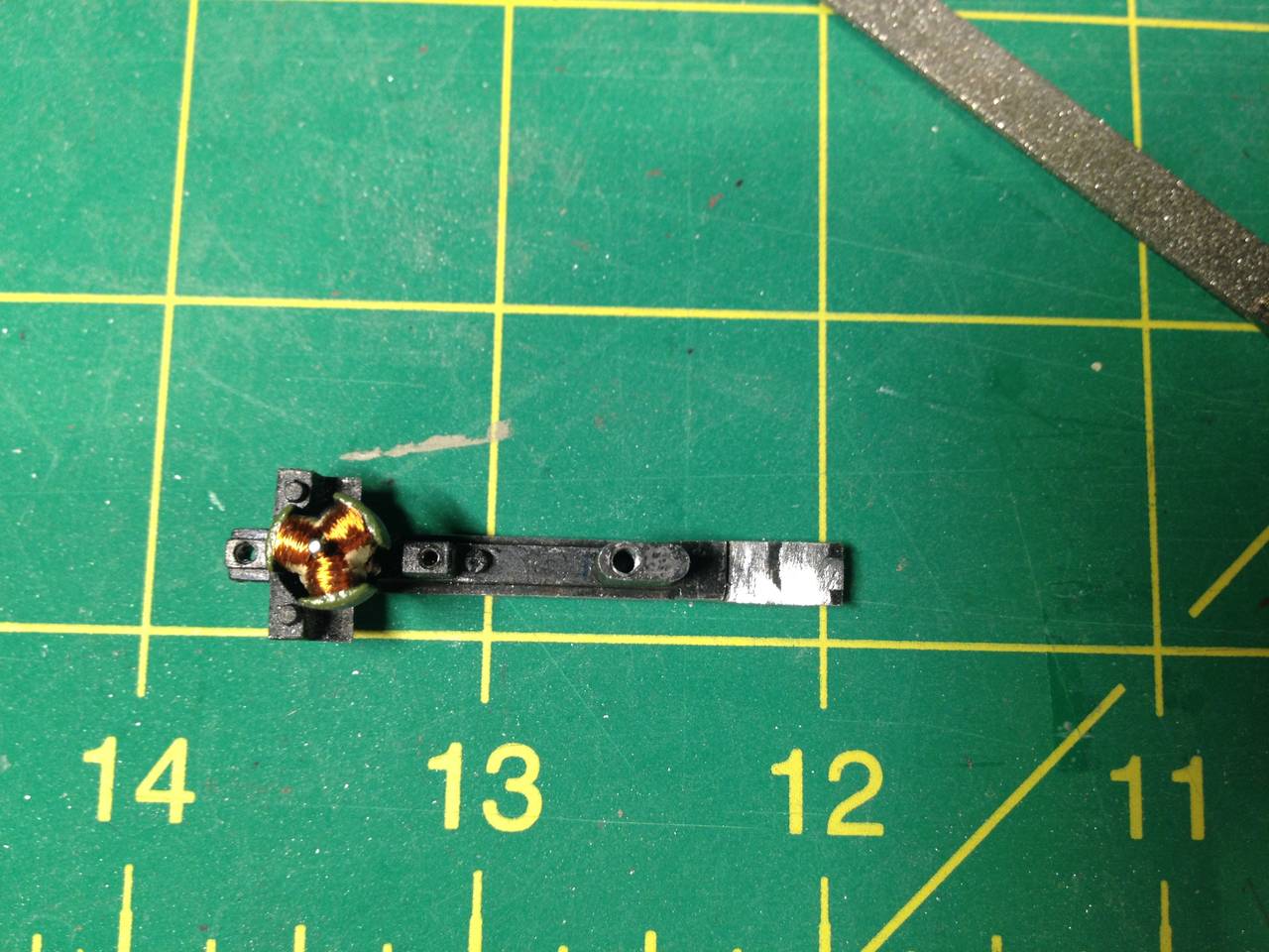

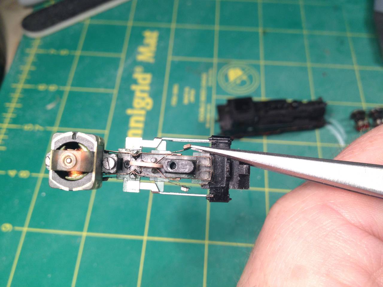

Sorry for not posting any updates on the build but I had been waiting for some parts to arrive. During the reassembly of the Marklin chassis I broke off a small tab on the clear plastic brush holder which holds the wheel wiper strip against the motor brush strip. Managed to find a vendor on eBay that does Marklin tune up & motor replacements and also keeps used spare parts. Once the replacement brush holder arrived I put the topside components back together and then figured out how to align the driver wheels and reassembled the complete chassis. Much to my surprise it even ran like it was supposed to on my test track so I now had to push forward with the build.

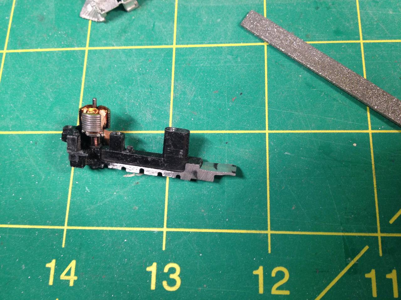

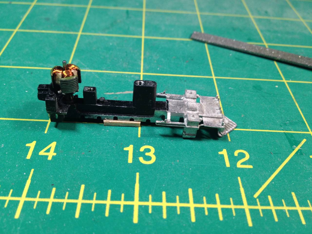

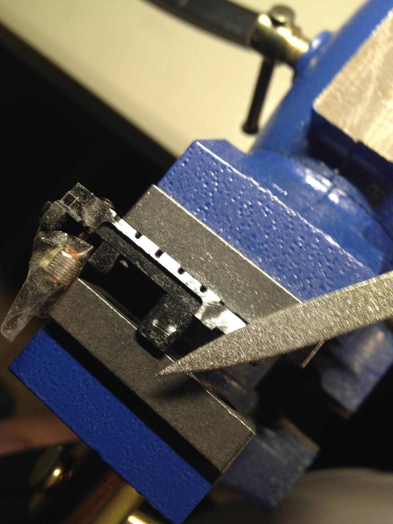

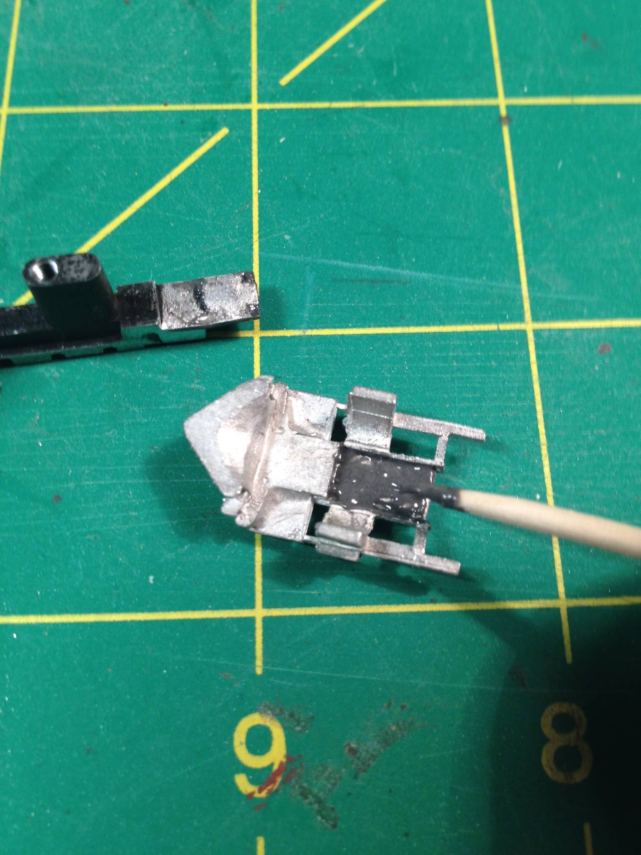

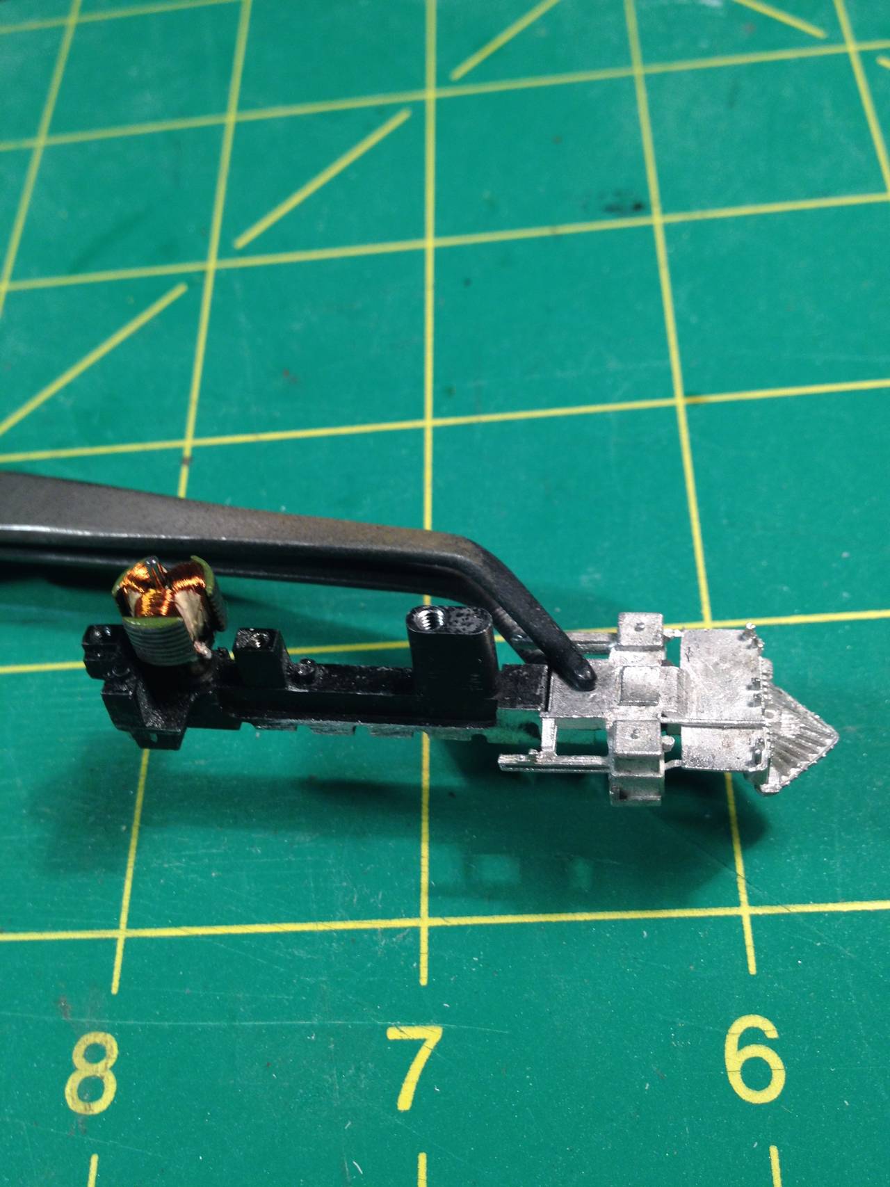

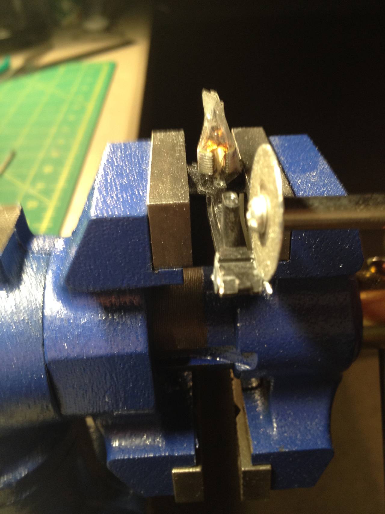

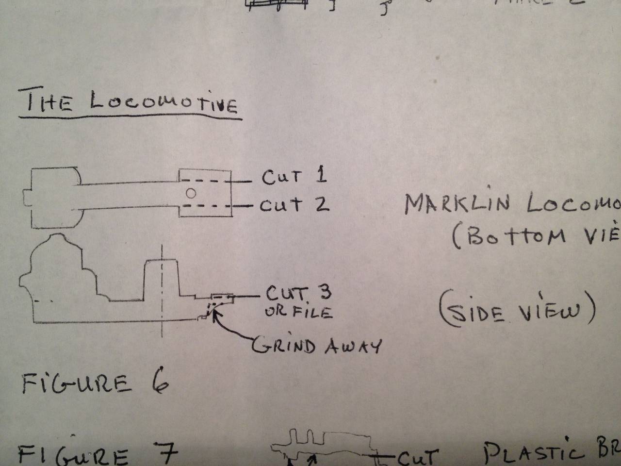

First major step is to attach the cast metal pilot assembly onto the frame but you have to cut & grind away sections (per the instructions) to allow a smooth fit. I clamped the frame in my vise and first used a thin metal cutoff disk in my Dremel to remove the large tabs on either side. Then followed that up with careful filing with some diamond grit needle files to get the final shape correct.
Some additional filling was required while test fitting the cast metal pilot until everything looked ok. Then a small batch of JB Weld was mixed up and applied to the underside of the pilot. A large pair of locking tweezers was used to clamp things overnight until the epoxy cured.

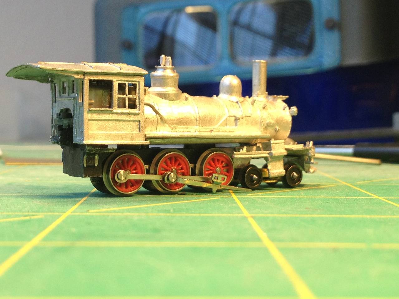

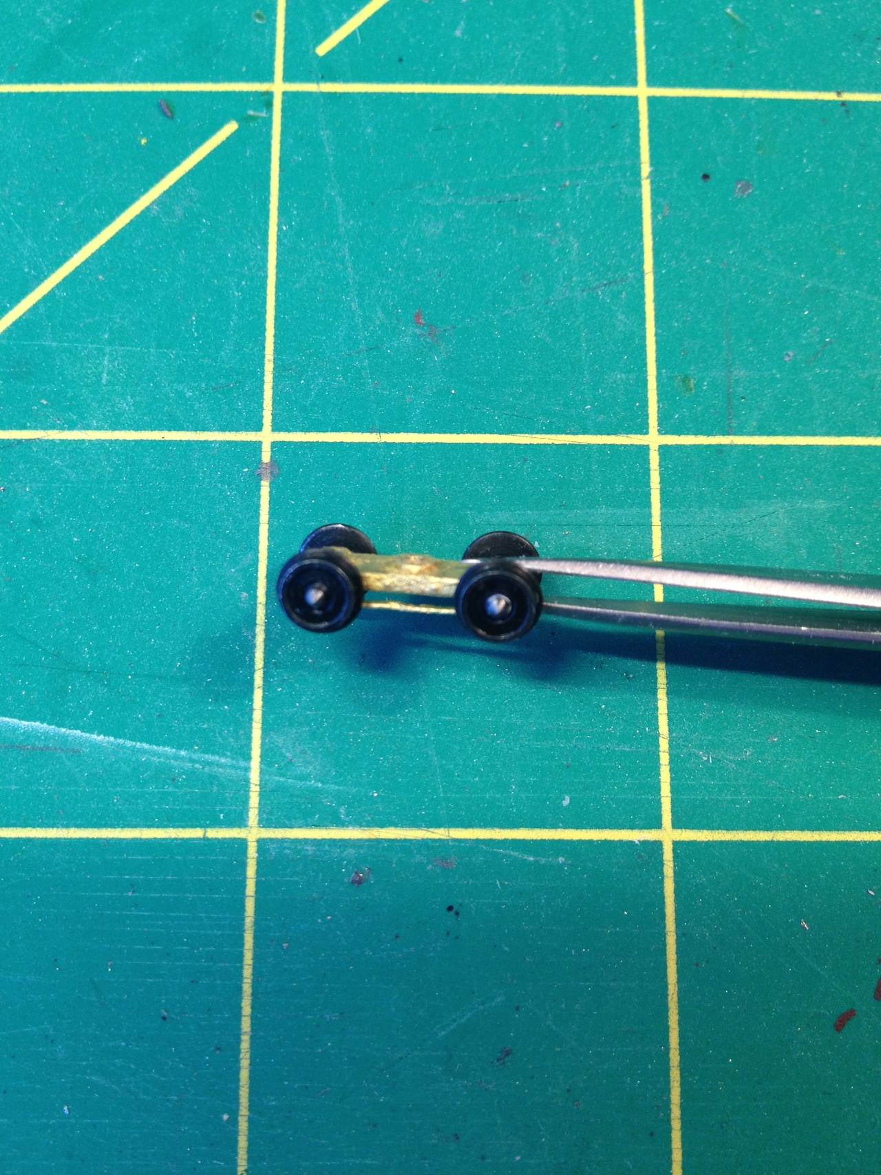

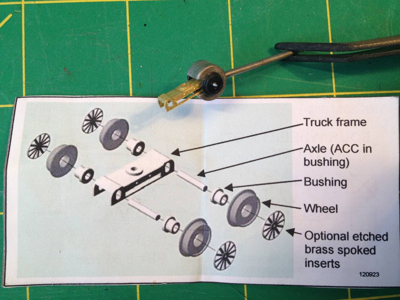

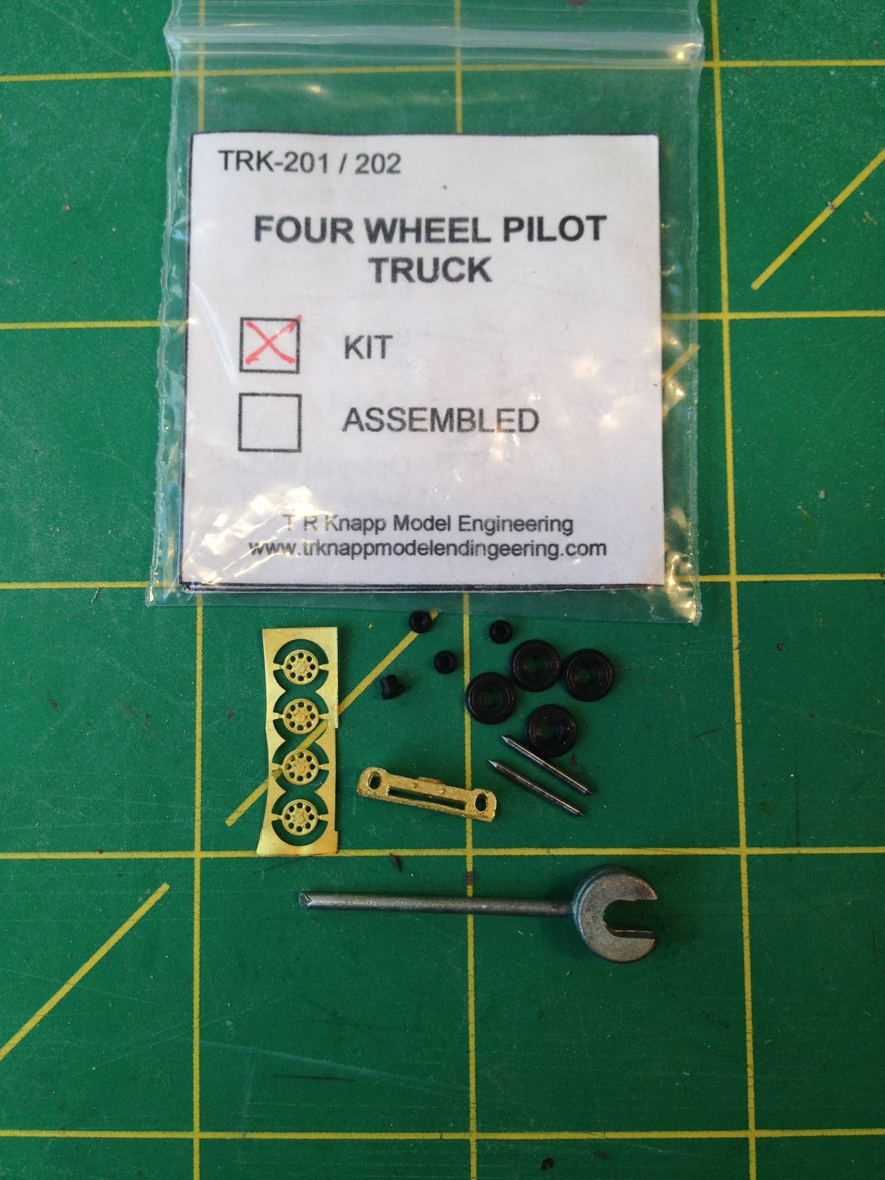

 While waiting for the JB Weld to cure I spread out the parts for the pilot truck kit. The sample photos and instructions in the RLW kit show a 4 wheel Marklin pilot truck but these are no longer in production, so you have to substitute the TRK-201/202 part. The kit assembly is pretty easy (ACC is used) and a gauge is also provided to space the wheels correctly. A small fret of wheel inserts with spokes is also included with the kit but I'll have to check some prototype photos to see if they had that type of pilot truck wheel. The top side of the brass pilot truck frame has a hole that comes threaded for a 00-90 screw that will be used to hold the truck to a pilot connection bar.

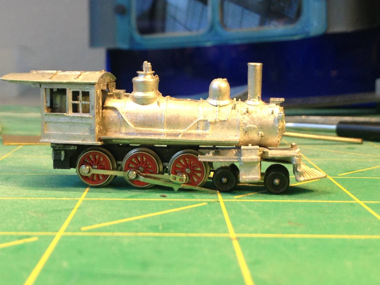

Once the pilot assembly was fully cured it was time to put the magnet cover back onto the motor and test fit the cab & boiler assembly on the frame. I also stuck the driver wheels and pilot truck underneath and the 2 photos below show where we currently are. Still need to fabricate that pilot connection bar from brass sheet supplied in the kit and attach the pieces that form the outside of the steam cylinders. The eBay vendor mentioned earlier was also able to solve my quest for longer main driver rods by selling me a complete wheel set from a Marklin 8896 chassis. Next update should show some progress on the tender and maybe a test run of the assembled cab/boiler/pilot...stay tuned.
