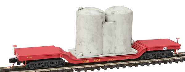

A question for you SPF's and others: do we know what prototype the MT depressed center flat car is? (MT 109010)
I recently picked one up at a swap meet in Pennsy scheme and lettering and other than its ride height, I really like it. It needs to be lowered, and I have a great load for it, but I don't want to put too much effort into an attention getter that's too much of a foobie...
Thanks, Otto K.

This is something that I've been trying to put together for a long time now (a list of the prototypes for MT and other manufacturers N scale rolling stock). Fortunately, I do have the info that you are looking for.
The Micro Trains depressed center flat car (original number 109010) was released in Feb. 2001. The first road released was the Pennsy 470016. The prototype for the car is a Commonwealth Steel Casting Co. (CSC) depressed center flat. The actual car the MT car used is GM&O 79000, except it is not a duplicate of that car. The GM&O car did not use the buckeye trucks that MT used on their car.
CSC and similar frames were owned by a number of roads, including PRR (Class F43 not F35 as lettered on the MT release), EL, NYC, GM&O, LV, etc. There were differences between the cars that each of these railroads owned, however, given the fact that the decking was customized by the railroads.

I thought MT did use Commonwealth (as opposed to Buckeye) trucks on these cars? Or at least that's what MT calls them.
MT Commonwealth -
MT Buckeye -
MT flat -

MTL tooled both styles of six-wheel trucks to reflect the various configurations.
The model needs to be lowered (which you can do by removing all bolster relief on the bottom of the casting since the trucks feature a humped bolster beam) and the truck centers moved outward.  You can do this by body-mounting #2004 couplers directly to the casting.  Technically, you also should drill out all of the deck holes, but that takes time and you must keep the drill bits well lubricated while drilling or they will lock.
Unless you have the original drawing, I don't know that moving the truck centers is a 'need to do'.  These cars varied a lot.  There aren't many drawings of six axle depressed center flats in the Cyclopedias, but there is one with dimensions.  The MTL car has 41' truck centers and is 58' 8" over the end sills.  The drawing has 40' truck centers and is 57' 9" over the end sills.  On some cars it also seams clear the the trucks are tucked as far towards the center as can be (which makes sense for something carrying heavy loads).
With that said, I agree that reducing the end shelf or eave (for lack of a better term(s)) past the trucks does make a more aesthetically pleasing car.   But it's not necessarily more prototypical.  As usual, check the prototype but don't concentrate only on the deck length past the trucks, but also the relation of the trucks to the center depression.
If anyone can track down a picture of a Missouri Pacific or GM&O car, I think those had examples of longer eaves like the MTL car just as a comparison.
