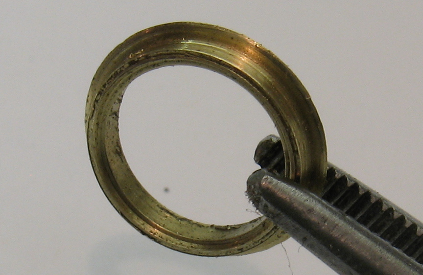

6 tossed-out attempts later, here is a new tire with the relief groove cut into it so that when the spokes
are fitted, they will look like they have their own rim inside the tire rim.  The inner relief groove is only
.007 wide and about .010" deep.  I tried shallower, but it's just not enough to really show.
I did make a tapered arbor, pressed it into my already-made tires, and then I attempted to cut
these grooves in them.  But I cannot get the accuracy I need to make it work.  The tire would always have
just the slightest bit of wobble on that arbor and that dashed any hope of getting a concentric groove.
... so, I made a whole new tire, and cut the groove before parting it off.  I like it.  Now I just have to make 7 more.   Just like before, I'm hoping that now that I have everything positioned just right under
the mill, I can make the rest more easily.

First things first.  I need to machine 9 more wheels, including two with TT grooves.    As before, I mill a bunch of them,
toss our the outright failures as I go, and then choose the best 6 using my eye and a caliper as the judge.
This first one came out really good.   .023" flange depth, .319" tread diameter, total tread width .048, total wheel thickness
.065.    If I can make them all to those measurements within .001", I'm happy.  (Frankly, I've seen more variation than
that on commercial wheels!)
