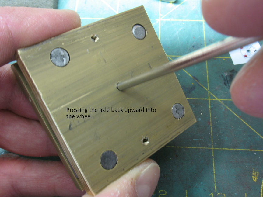

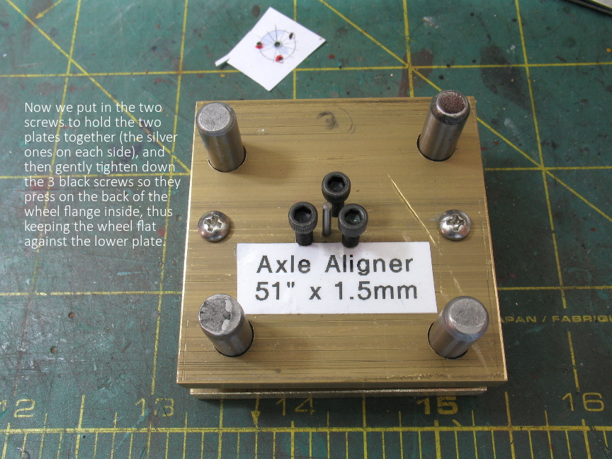

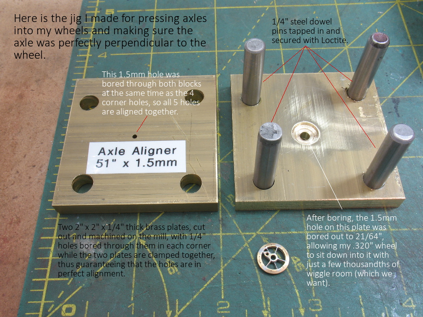

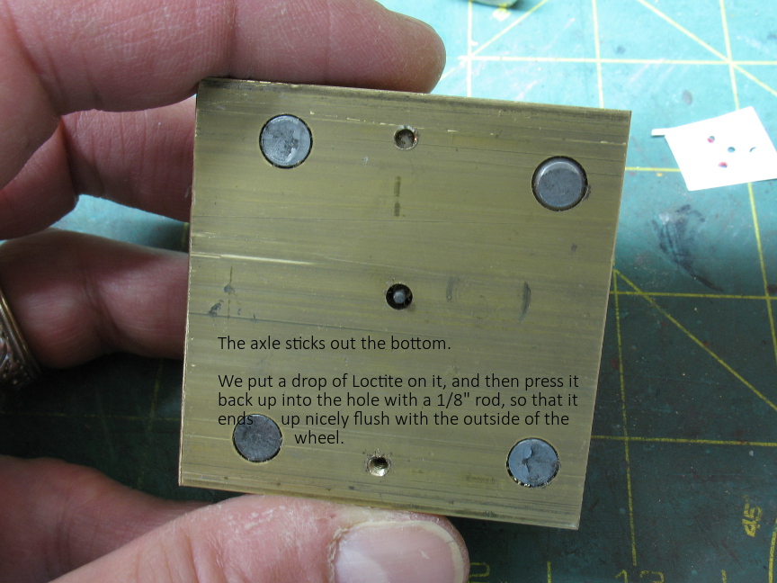

« Reply #128 on: October 02, 2015, 11:55:27 PM »

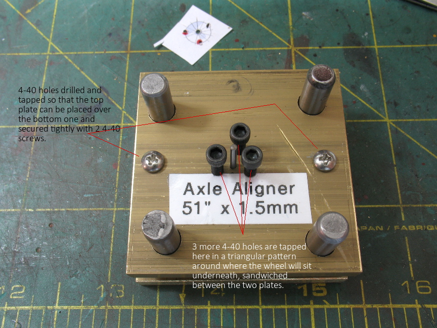

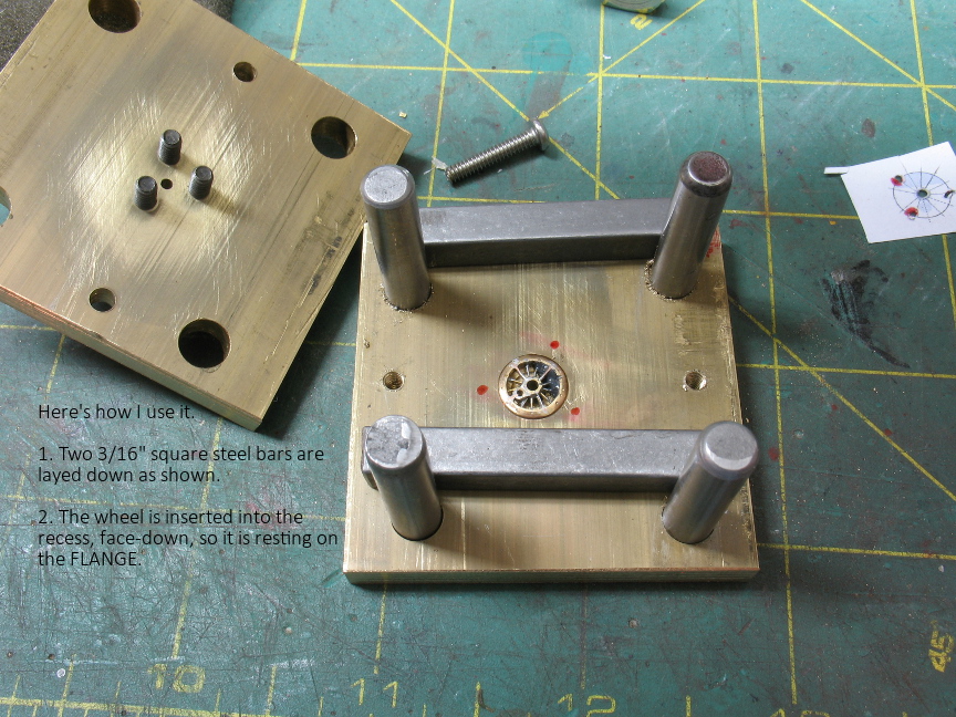

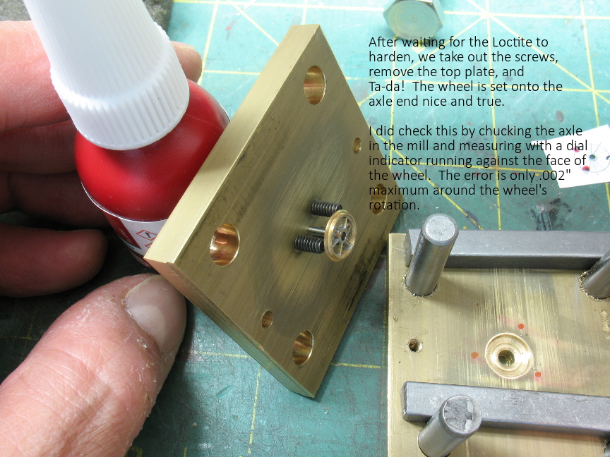

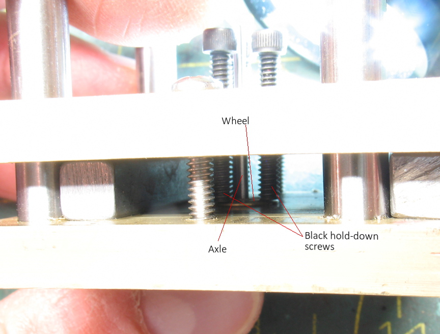

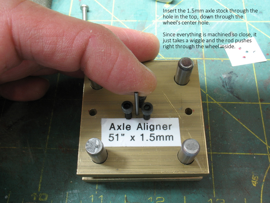

The crazy outhouse cat has returned...
This installment covers three things:
- making a tool for pressing the axles into these wheels so that they are perfectly perpendicular without
any chance of wobbling
- making the counterweights a little thicker, so they stick out above the wheel rims like they should
- getting another wheel or so done
The wheel/axle press.
 I know... this is overbuilt like crazy, but what the heck.
You may notice that you don't see the same wheel in all these photos and some of them are shown using
a partially-built wheel that doesn't have all its spokes yet.  That's just because I was staging all the photos with
what was at hand to tell the story.

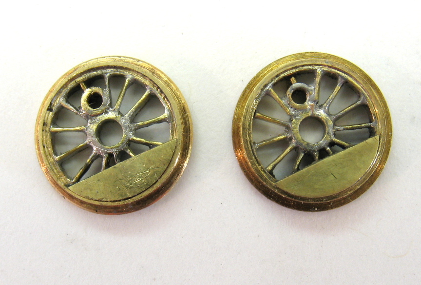

Improved the Counterweights and Built Another Wheel
After Peteski shamed me into making my counterweights with more relief, I added another .005" on top of
the one I had already put on to my first wheel.  I am making all the rest out of .010" instead of .005"
I have to agree, the extra thickness looks better.
So, now I have 2 wheels done, and a 3rd one about halfway done (needs more spokes)

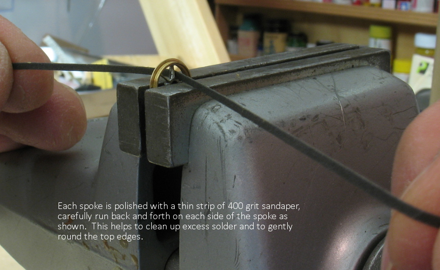

Here's a shot I forgot to include before.  This just shows how I smooth and shape the sides of the spokes
after I get them all soldered in:

As usual Max, excellent work!  The counterweights do look better.

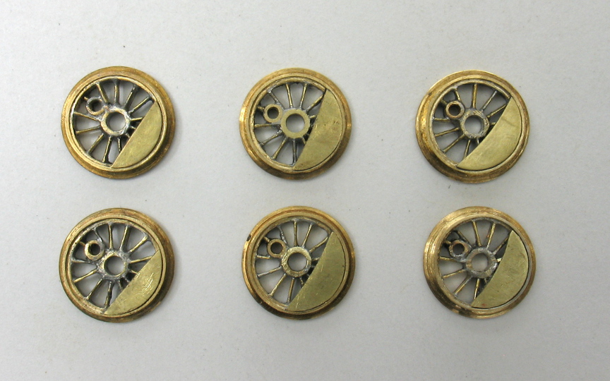

« Reply #132 on: November 15, 2015, 04:48:13 PM »
At long last, the 6 wheels are done.
Now I can do some experiments with bearings and frame halves.  This will probably continue in a new thread
for the engine construction itself.
