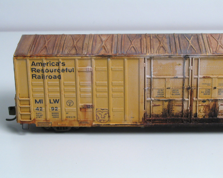

I've been looking to do some extra detailing on my MTL 60' waffle side and smooth side boxcars I'm currently thinking on adding the deeper side sill to the Milwaukee Road car as per prototype http://www.krunk.org/~joeshaw/pics/milw/60ftwaffle/milw4294-1-medium.jpg , I have heard the MTL 60' boxcars cars are compressed and was wondering if the box is to short height wise or length wise, if it is too short in height is that just do to the shallow side sill? Just wondering as I want to get these as proto as practical.

I thought the Berwick car looked right, just too high.

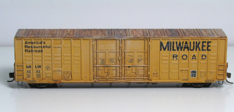

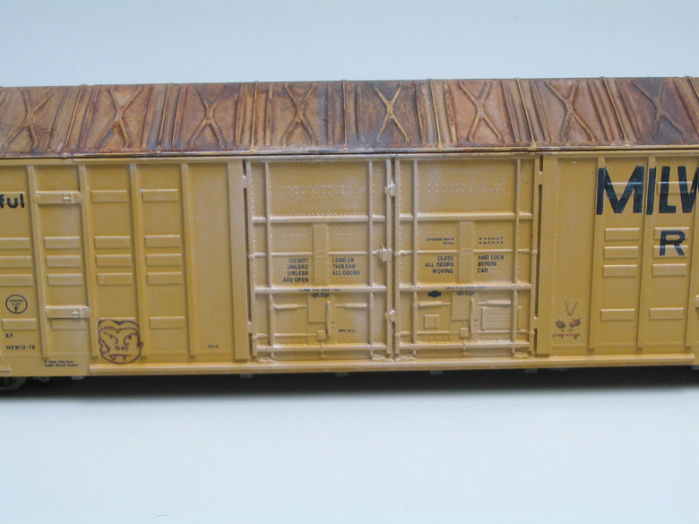

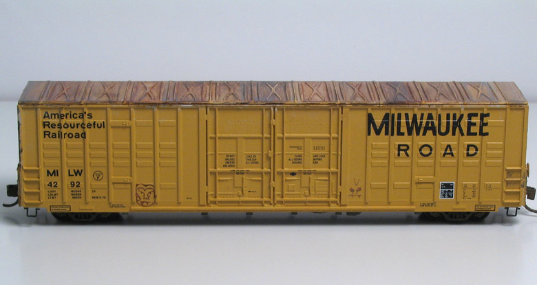

I made that one a long time ago (2004 :o).  Much lowering is required:
You can see the height compression differences between the model and actual boxcar here:
I love this car.  I made another one a few years later but never photographed or (posted it) for some reason.

The model with riveted sides and double plug doors (MTL 102000 series) is correct in the body height and rides at the correct height overall.  The "chop" was taken out of the lower sill.  Extending the lower sill to it's proper height corrects the model and improves the look tenfold.  Scott Lupia modified some of them and submitted a how-to article to NSR.  It is slated to appear in one of the upcoming issues sooner than later.
Yeah, that would be neat to see.  The problem with just lowering them (as I did) makes the model look too long.

It's near-impossible to fix the waffle cars since, as your comparison photos showed, all the features were rearranged height-wise to compress the model.
Incredibly, the 40' appliance car is not compressed and is a great candidate for lowering.  But the model is either of an uncommon prototype, or an amalgamation of multiple prototypes.
A black suit wearing older man smoking a cigarette Ed K told me years ago that his theory of why this was done was so that the magazine reviews would state "overall height and width dimensions match the prototype."  I, myself, believed it, as it seemed like a perfectly rational explanation.  I've dismissed other conspiracy theories over the years, but this one seemed too much like real life.
