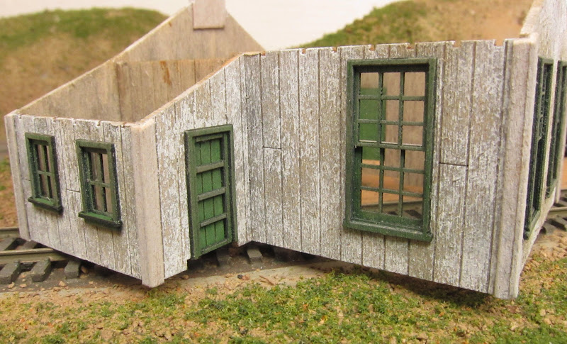

Ended up with this:

Chris, IMO, I think the peeling affect looks pretty good but it looks like the paint just all peeled at once from freshly sawn lumber.  I'd like to see a little more of the coloration seen in the corner near the door with the darker contrast.

I'm a little bit scared to add more stain at this point. Every time the walls were wet I had to let them dry under large steel blocks and now the walls as glued together. I'll see what powders do to it.

Can you try an A&I wash? (Alcohol and Water Soluable India Ink)  Don't flood it on but sort a light wash.

I gave it another ink wash. The chunk of wood up on the dock is what the walls looked like when I opened the box:
  • Respect: +1737
Re: Peeling paint?
« Reply #12 on: July 20, 2014, 09:33:50 PM »
Now that's what I'm talking about.  Looks great.

« Reply #14 on: July 29, 2014, 05:33:22 PM »
I agree that the peeling paint effect looks very good.  However, looking at prototype buildings that have had years of neglect, there's usually a "line" of darkness a few feet up from the bottom of the building that goes all the way around, except where there's a deck or loading dock.  This is caused by the run-off from the roof and rain drops spattering the dirt that gathers around the base of a building.  This spatters up, and stains the side of the building forming a "line", but with a highly feathered edge.  More rains wash this off, but some dirt/soil stains stay, and over the years, it builds up.
