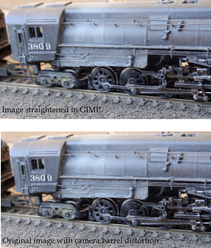

I wanted to point something out about these close-up photos and barrel distortion.
For a while, I've been looking at some of these thinking "something is whacked", like parts are bent or
put together crooked.
Then I realized that it the barrel distortion of the camera.   I thought I would post this because I discovered this about my own model photos a while back, and straightening that distortion out makes a huge difference in how a model appears.
Attached below is one of Carl's original photos, and on top of it is the same picture after I read it into GIMP and applied
Filter->Distort->Lens Distortion  and set the "Main" to about -9.5
Most cameras and especially the point-and-shoot and even better "pro-sumer" cameras that many of us use have a lot
of curvature distortion.  You can really see it if you take a straight-on shot of the side of a loco on a straight piece of track, very close up.  The track will appear to be curved like a banana!  And while you might not always notice it in your model,
when you straighten it out, the improvement is dramatic.
In this case, look at how much the cab appears to bend down and "droop" in the back, when in fact, this is the curvature distortion of the camera.
And now that I've done this so I can really look at it,
congratulations on a very nice model, Carl!
And by the way, I have read this thread, and I understand the practical and dimensional compromises that have been
made to convert the EM-1 into the AC-9.  I went and looked at some other prototype photos.  I think it looks like an AC-9.

Finally, I want to thank all of the responders to the thread as that is how we learn from each other. My gosh Max, I never heard about barrel distortion unless we are talking about a beer barrel distorting my figure. Really food for thought. Also, again thank you for the pony truck, I think it looks great.
