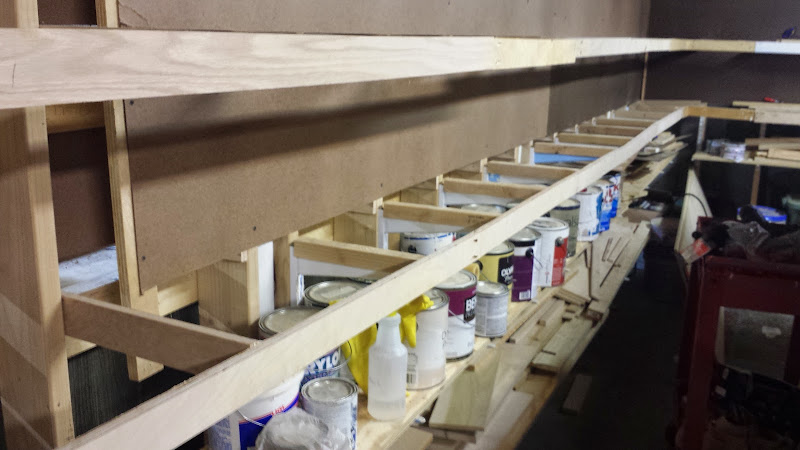

I spent yesterday rebuilding the staging area (lower level) and the coke plant/blast furnace area. Each section was about 15" in width before and I needed to move it out to 24". I have an studded wall divider and, for some reason or perhaps in anticipation, I had runs L-girders along it that the 15" wide shelf was drilled into the studs, since it was open, and screwed into the L-girder. I basically just removed those 15" joists and put in the appropriate sized ones for the 24" long ones. A few on the shots closed to the camera extend through to the other side of the wall to support that side of the layout.
Mill/Coke ara:
Staging area:
I also put up a few more backdrops on the peninsula. It amazes me how once those were put up, the peninsula is solid now and won't budge at all. Next steps are put up the facing pieces on the ends of the joists, probably using pocket holes again, and then to reduce the top-level in a few places back to 12" wide since the lower level is 15" everywhere,
