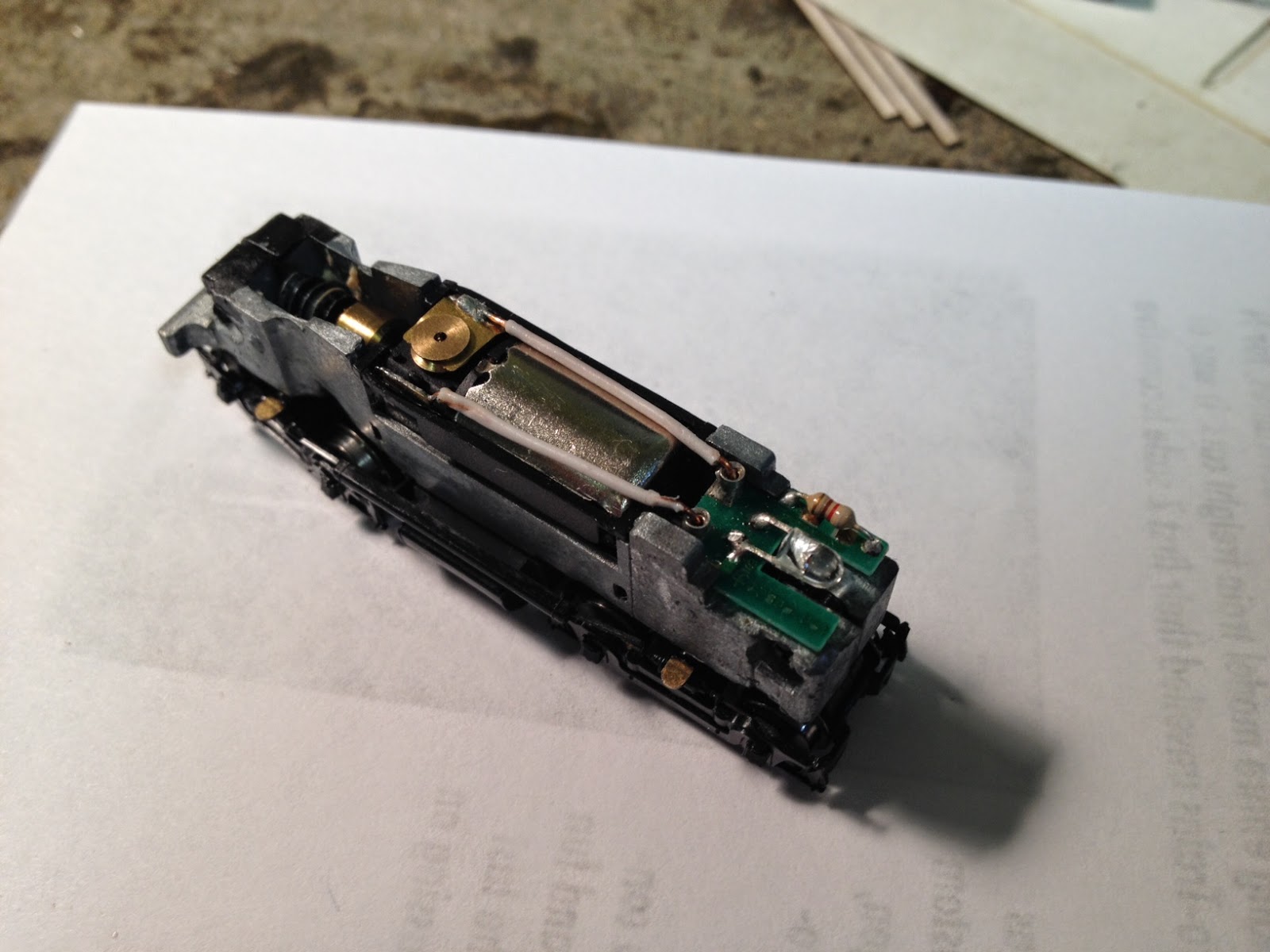

You know, this photo of the mechanism shows something so obvious, I'm surprised nobody has mentioned.  The motor itself is thin enough for a scale-width hood. But it sits in a plastic cradle which probably adds about 0.060" to the overall width of the frame.  Lose that cradle and the loco can have scale-width hood!  There are plenty of locos out there which utilize this type of a design.
And many more....
So what you're saying is there is already a source for the unobtainium motors, since MTL is using it?
Gasp. How will this be spun next?

If MTL wanted to, they could have made this scale width USING the SW1200 drive train components. They would need new frames and a motor cradle, but it would have been possible. Now, could it be profitable... well that is the question. From my understanding of the order, MTL would need to order the SW1200 mechanisms in bulk, take them apart at their factory and rebuild them with new frames and motor cradles. I can totally see how this project now becomes a huge mess as you are basically producing the same thing on two continents save for a few parts.
Hood width matter quite a bit to me as I often look at my models from the top. Even the Kato wide bodies annoy me. Would I pay an extra $20 for the correct width? Absolutely! Would anyone else? I'm not so sure.
The difference is that MTL knows their market much better than I do. If they can't make it work, then there is a reason.
