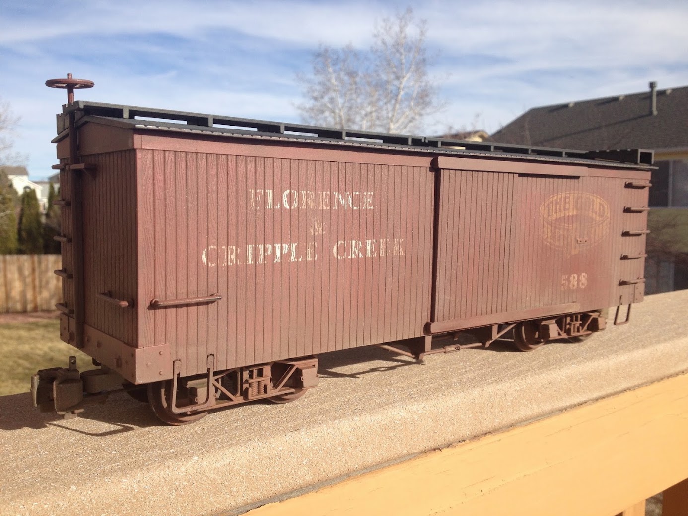

Started working on that big hauler D&RGW boxcar.  Again, it's not even close to the body style that would be correct for a 3000-series boxcar, but the lettering is quite good (with one exception...all of the dates are from 1924/5 when the cars were rebuilt...the "flying Rio Grande" scheme puts it squarely post-1939).  That said, all of those black Delrin separately applied details need to be made an oxide color to match the body per D&RGW specifications, which I did.  You need Dullcote to give the Delrin some tooth for paint.
Before:
The underframe, truck side frames, couplers, grab irons, and brake rigging all got a matching oxide along with two coats of Dullcote (one before detail paint, one after):
This one will be weathered with chalks...  It's the newest paint scheme and I model the 40s, so I'm not going to make this a rolling wreck.
For contrast, here's my F&CC boxcar weathered as a rolling wreck.  Note the door tracks look correct on this car but backward on the D&RGW version.  The body is the same, except that the F&CC is the earlier release with plastic wheels.

Loving the weathered car, Dave. Really propels the models away from the "big clunky plastic toy" look. Did you fade the lettering down with a light sanding or is it all chalk?
Jeff
I used 70% isopropyl alcohol to very carefully remove a bit of the lettering.  I would not recommend the technique in N unless complete removal is desired.
The car was mainly airbrushed for weathering.
