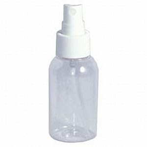

Lately I've been thinning my Glue/Water mix more on the watery side, about 40/60 -35/65.  In addition to adding dish detergent/rubbing alcohol (to reduce the surface tension), the thinner mix mists better from spray bottles.  Also, I use those smaller mist bottles rather than the large cleaner/solvent spray bottles.  The spray is much less forceful which prevents disrupting the unglued ground foam and such.
« Last Edit: January 30, 2014, 12:33:46 AM by Mark W »
