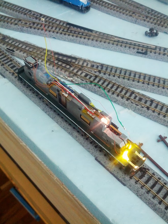

I can confirm that the LokSound Select Micro does indeed have 4 functions. I flipped the original LED for the headlight and used an additional three 1206's to light the rear headlight and for independent flashing ditch lights. I'm not sure how wide the inside of the SD70MAC shell is but I also had to mount it at a slight angle for it to fit under the hood with no bulge on the radiators. The ditch lights are wired with 38 gauge magnet wire back to the board to minimize space.
Alvin

« Reply #24 on: December 02, 2013, 05:29:33 PM »
Very nice work - and I see you have what I think is the Zimo 8mm x 12mm sugar cube speaker back there - I'm pretty sure that the speaker itself is the Star Micronics SCP-08B that I just posted about, except that Zimo sells it with an integrated enclosure.
