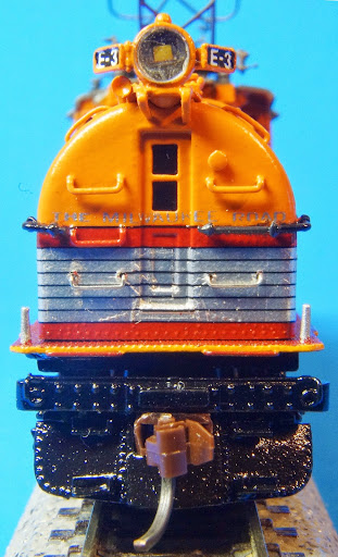

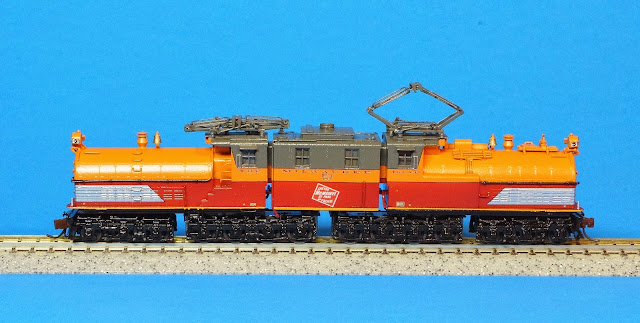

« Reply #822 on: October 17, 2014, 11:46:30 PM »
Having completed the first of these,  I returned to my Kumata book that I am writing.
In doing so, I realised I didn't have many final, final photos.
So here are some.  And the number one thing (having been in the thick of this all the way) that REALLY stands out in some of these shots .... is the wheels.   You guys were right.  Blacked wheels makes a HUGE difference on this locomotive.
Thanks.  And thanks to y'all who have followed this very long thread.   Your encouragement has meant a lot to me.
And your constructive criticism was evaluated and often adopted.
I believe this is a much better model because of this community.
Thank you.

« Reply #823 on: October 18, 2014, 12:06:14 AM »
Great photos Ron!
One more comment:I assume that the "round thing" on the center of the boiler room is a stack or exhaust.  If that is the case, a quick dab of flat black paint would make it more realistic.

« Reply #824 on: October 19, 2014, 08:48:45 PM »
Beautiful loco, superb ultra detailed detail-oriented work...
Crappy toy-like track.
Is there a dichotomy here?????
